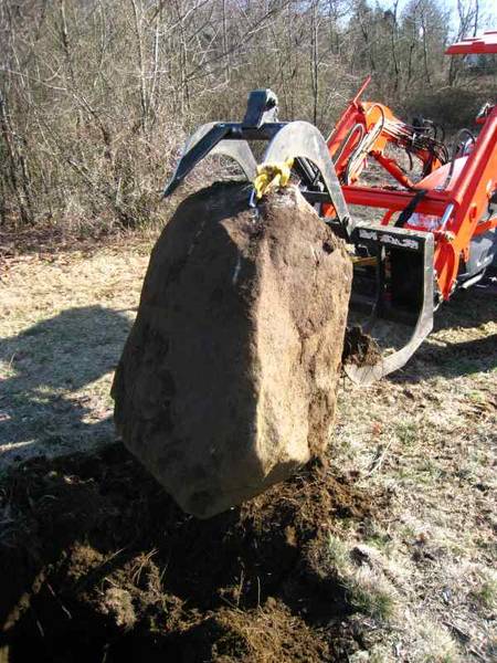

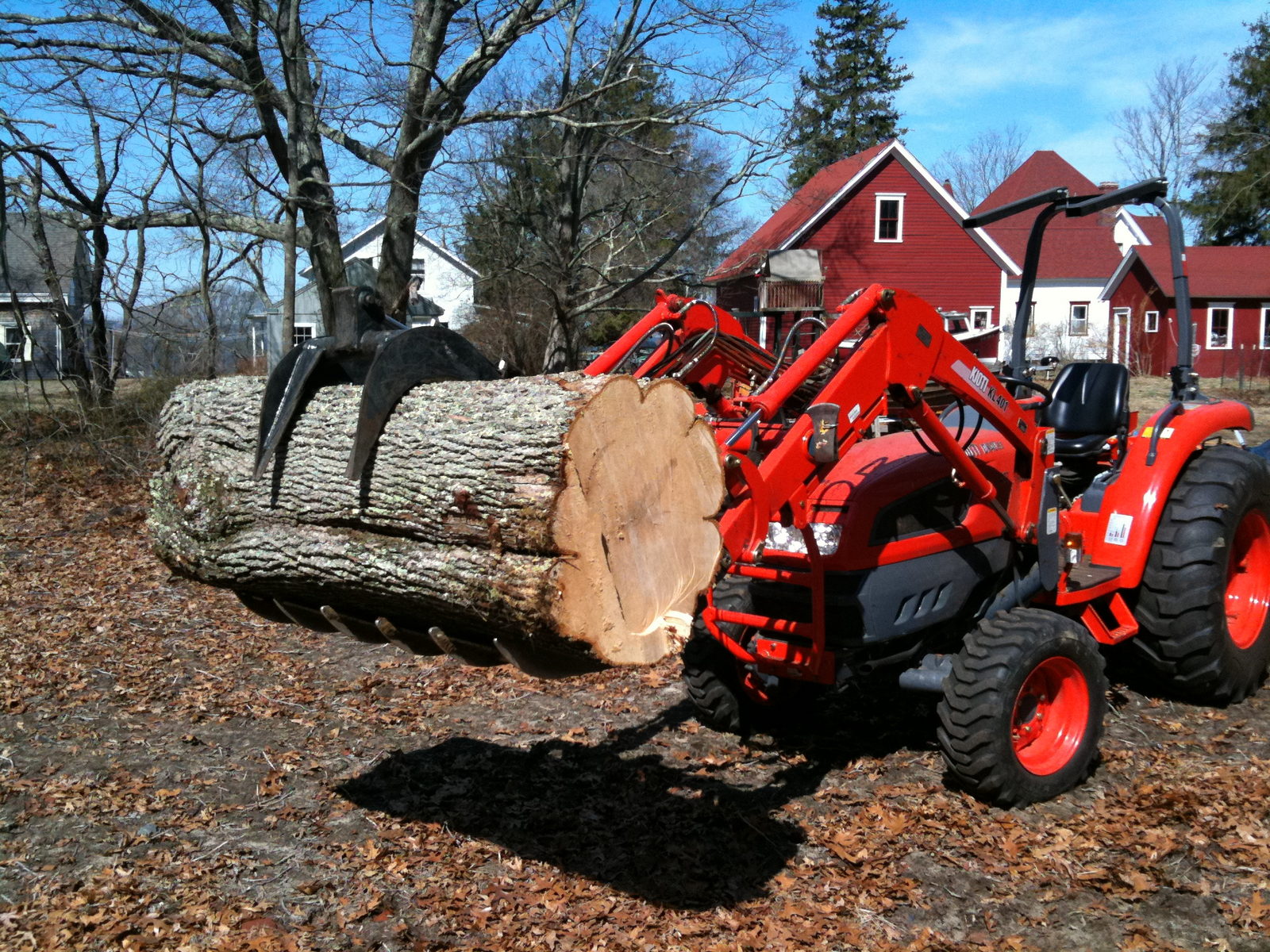

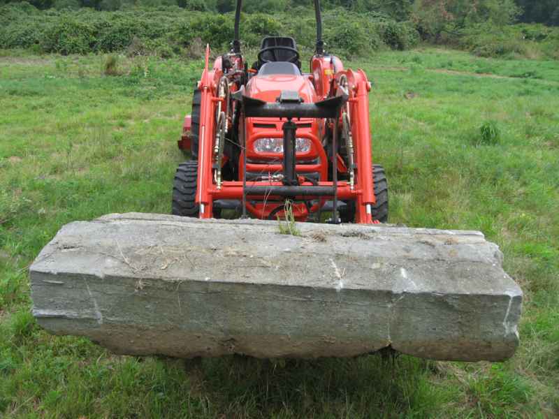

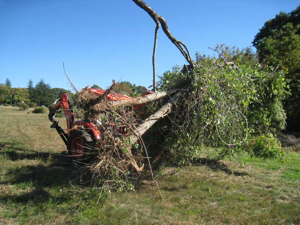

You can take IT's recommendations to the bank. But....I aint so sure he's picked up the biggest ever load of brush.....I gotta dig thru my pics......I didn't know there was a contest. ;) :D

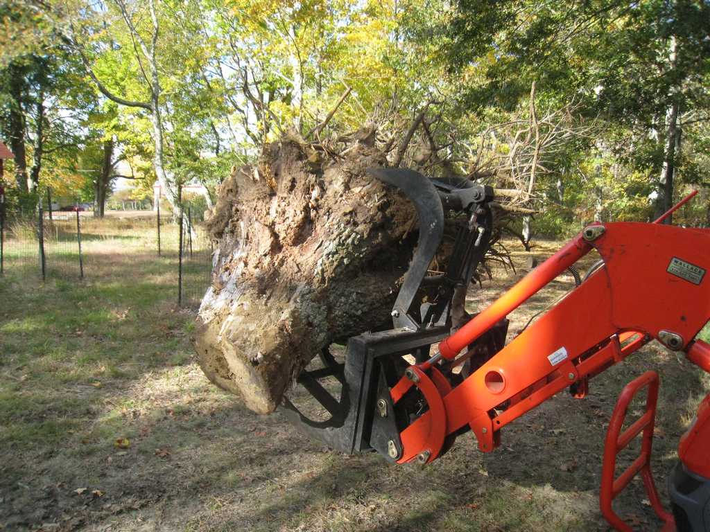

Sometimes I pick up whole pine trees.....and if not balanced right....I get concerned about twisting the loader. Some of those trees can be pretty heavy and there is allot of leverage. Short sections like shown here are no big deal.

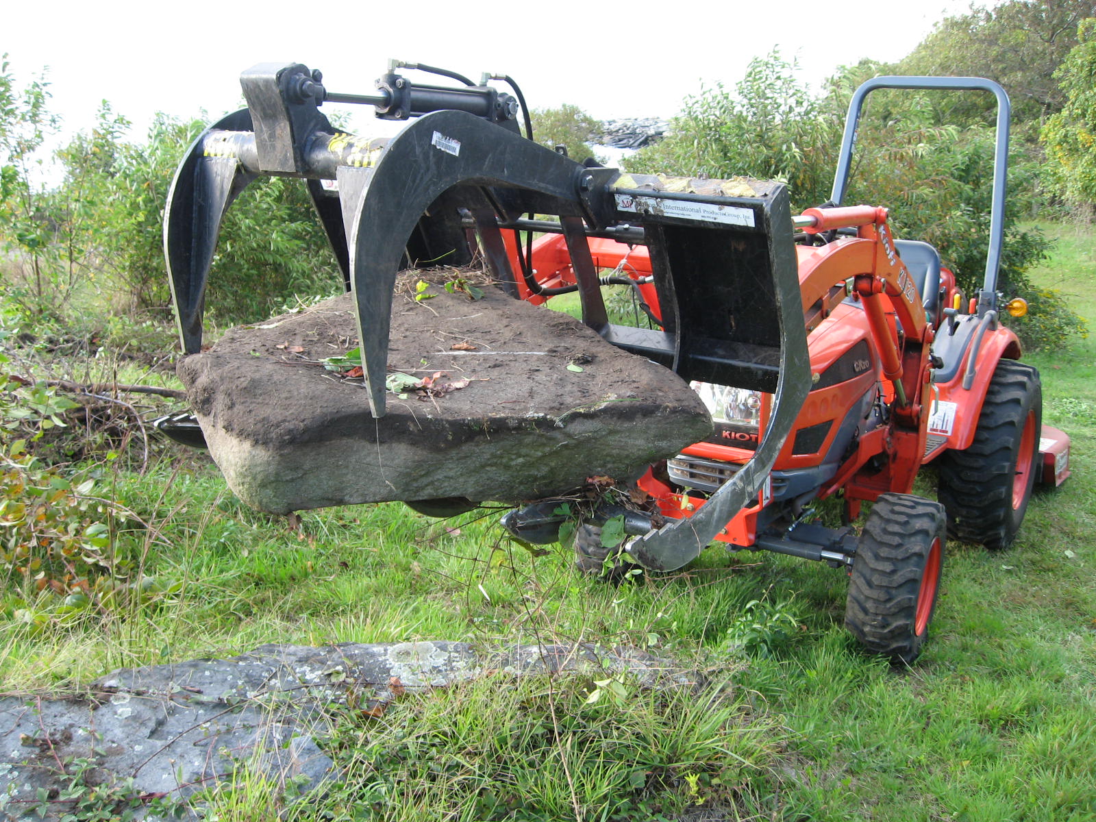

We'll need a contest for 1) largest mouthful of plain brush, 2) largest whole tree, 3) largest rock, and 4)??? largest Jersey Barrier piece. Perhaps we will also need HP categories such as under 30hp, 30-40hp, 40-50hp etc.
Here are my entries in the under 30 and 40-50hp categories (some previously posted):

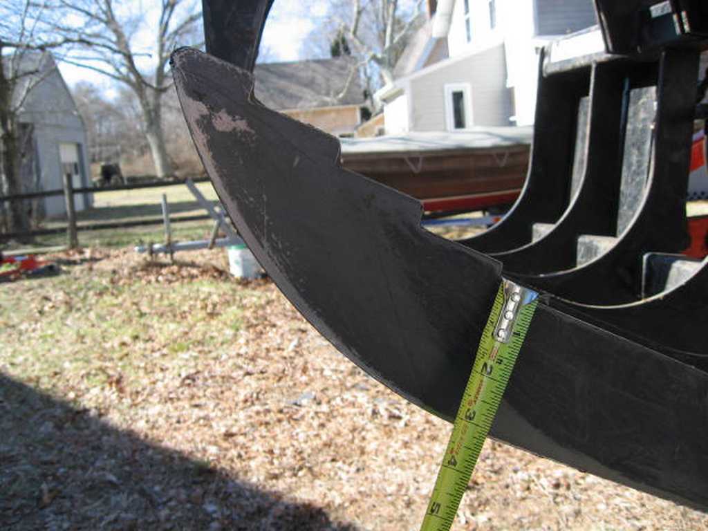

450lbs and dual upper arms for the 54" version is overkill. Same basic quality with a 48" and single upper grapple at 350lbs and with pricing at the $1200-1300 range with your usual "free" shipping and you'd be selling them like hotcakes. Figure out a fair west coast delivery charge and you'd sell even more.
You'd save a lot of weight just removing the second upper arm but you could also cut down a bit on the size of the bottom tines. I've included photos of my Millonzi bottom tines. Same style cut from a single piece of 3/8" plate as yours. I don't think the Millonzi tines are quite as big though. They are as straight and true today as when I received it 7 years ago and I've used it aggressively with a DK40se tractor that weighs 6000+ and lifts 2700lbs. I often lift the rear wheels off the ground while digging stumps without doing any damage to the bottom tines. The upper grapple arm on my Millonzi is a bit too light for the abuse I have dished out and it has some battle scars and bends but it still works fine. Cross bracing on mine with just a couple of pipe pieces is not great. The Construction Attachments upper grapple is IMO a bit over built but is basically a nice design. Could save some weight and steel there too without any serious compromise.

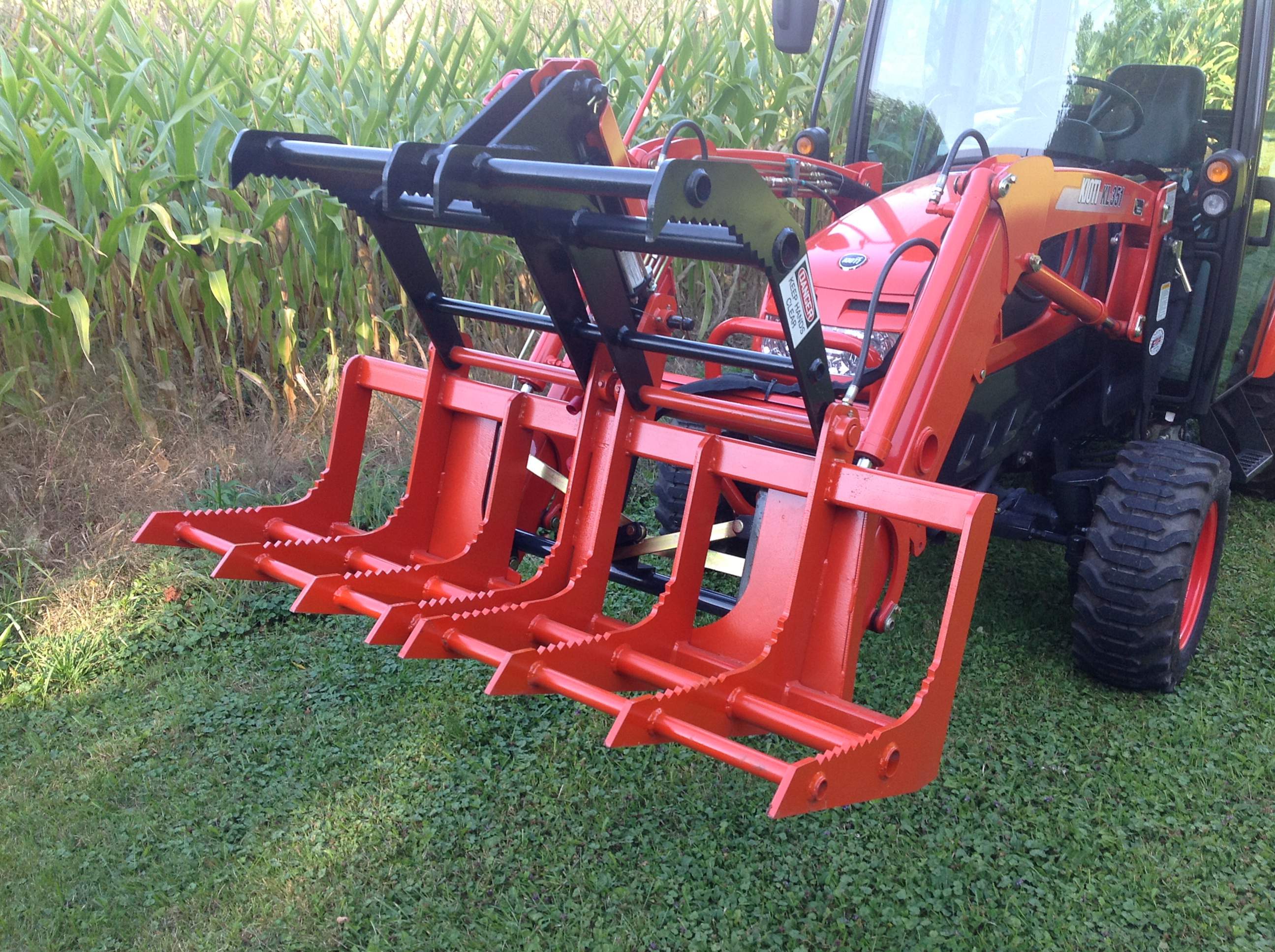

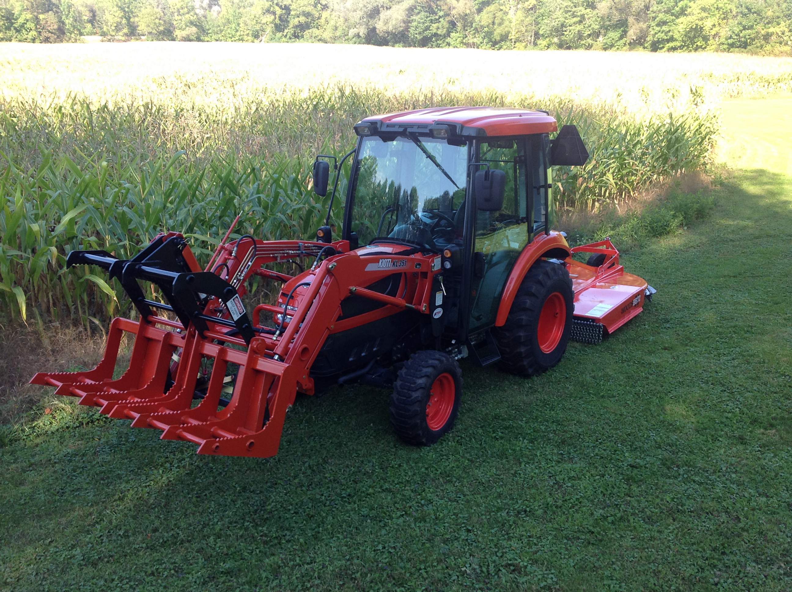

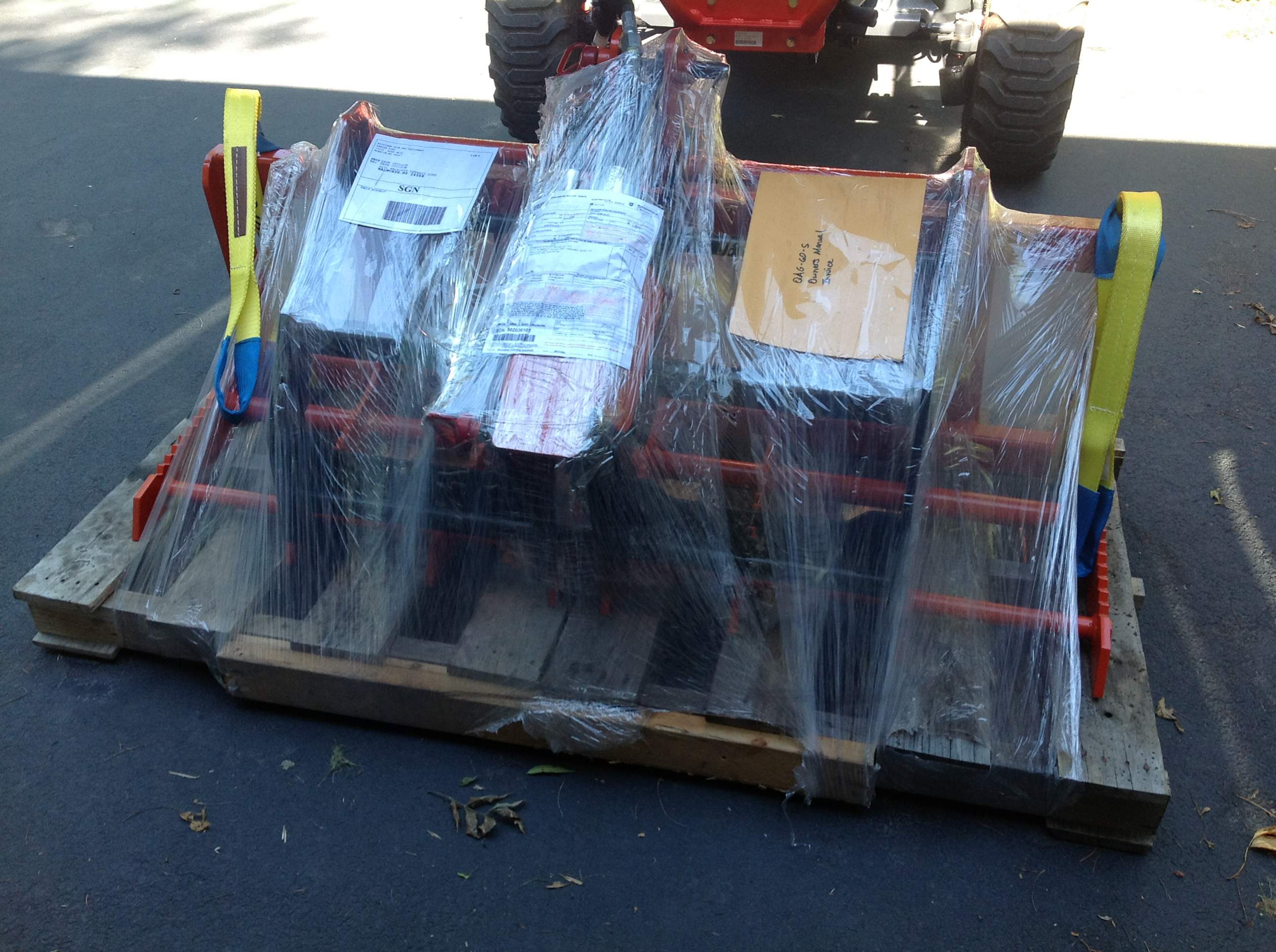

Well it showed up today UPS freight, two days after placing the order. It was packaged well on a pallet and looks great. Now I am going to go "grapple" something.....:thumbsup:
