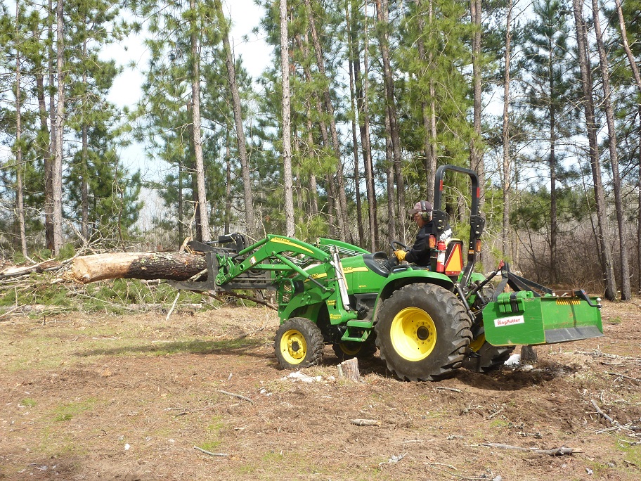

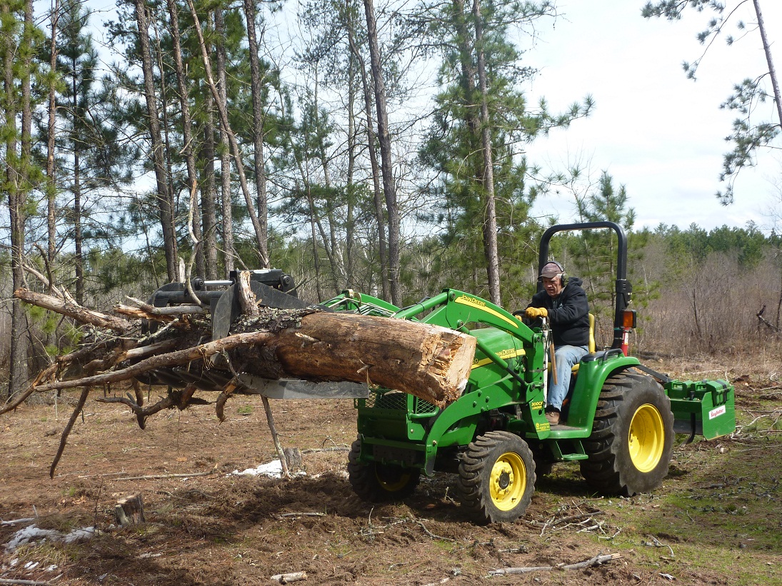

You can take IT's recommendations to the bank. But....I aint so sure he's picked up the biggest ever load of brush.....I gotta dig thru my pics......I didn't know there was a contest. ;) :D
Sometimes I pick up whole pine trees.....and if not balanced right....I get concerned about twisting the loader. Some of those trees can be pretty heavy and there is allot of leverage. Short sections like shown here are no big deal.
