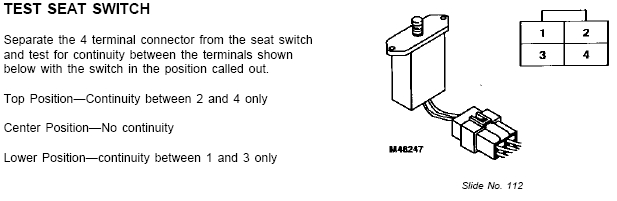

The 670 seat switch has four wires. One pair connect when operator is on the seat. The other pair connect when the switch is pulled up to defeat the switch for rear PTO use when off the seat. The attachment shows the switch and its operation.

thats exactly what i was looking for. thank you all very much for the help.
   / questions about my 670
#23
great news, i bypassed the sensor and it worked but i think i might get the sensor anyway, just for safety. now i just need to get the hitch.
thank you all for the help.
   / questions about my 670 #24
Glad to hear it. I know everyone here always appreciates hearing back when a problem has been solved. Enjoy your 670!
