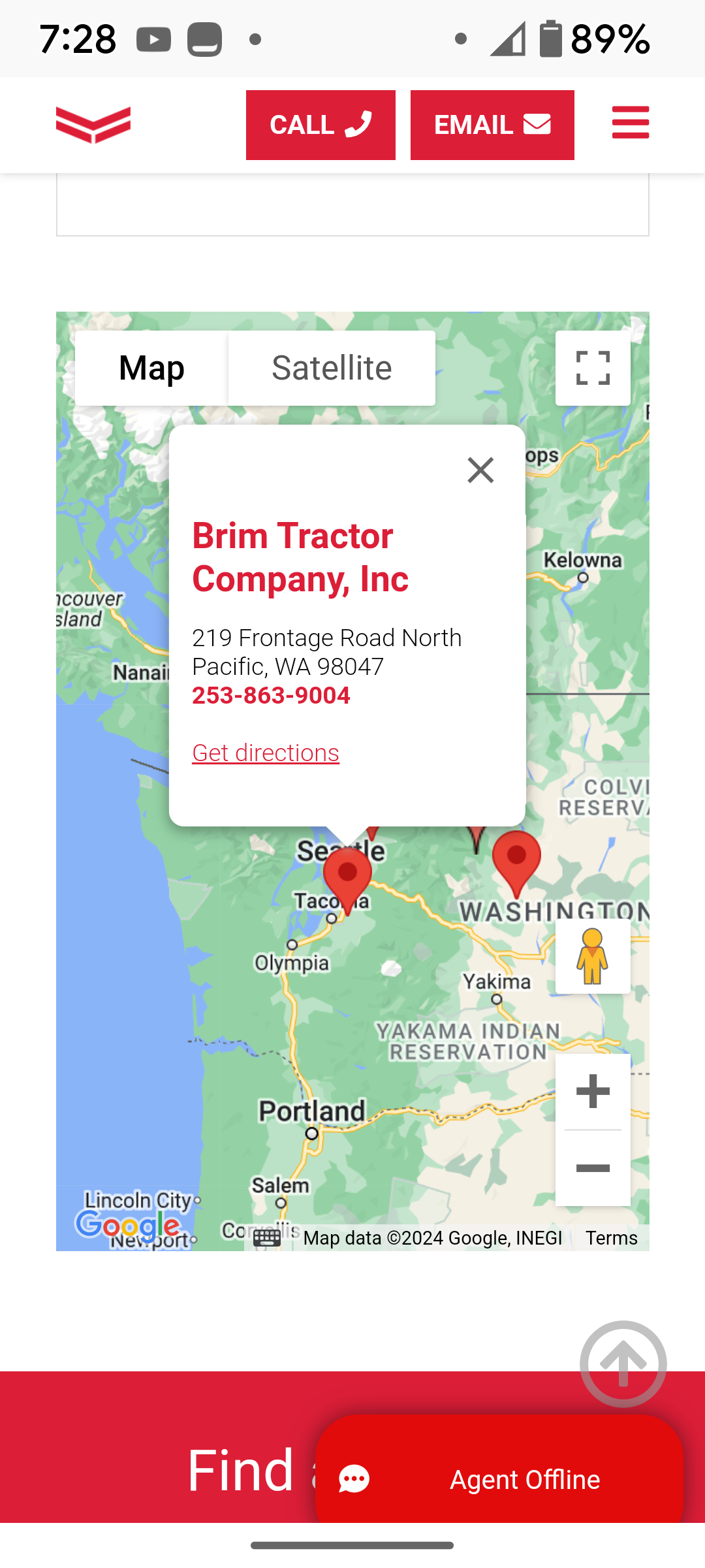

@WinterDeere, Yanmar's warranty is transferrable.
Transferable only once. I agree with looking at Yanmar. You can also find them used. Look for these models: SA324, SA425, SA325 or SA425. Difference between the SA3s' & 4s' is tire size only. Larger tires on the 4 series. The difference between the 424 & 425 is a accessory outlet and dual rear remotes standard on the 425.
You want rear remotes so try to find an SA325 or SA425.
Just buy a new one. They're right around the 20K price point.
