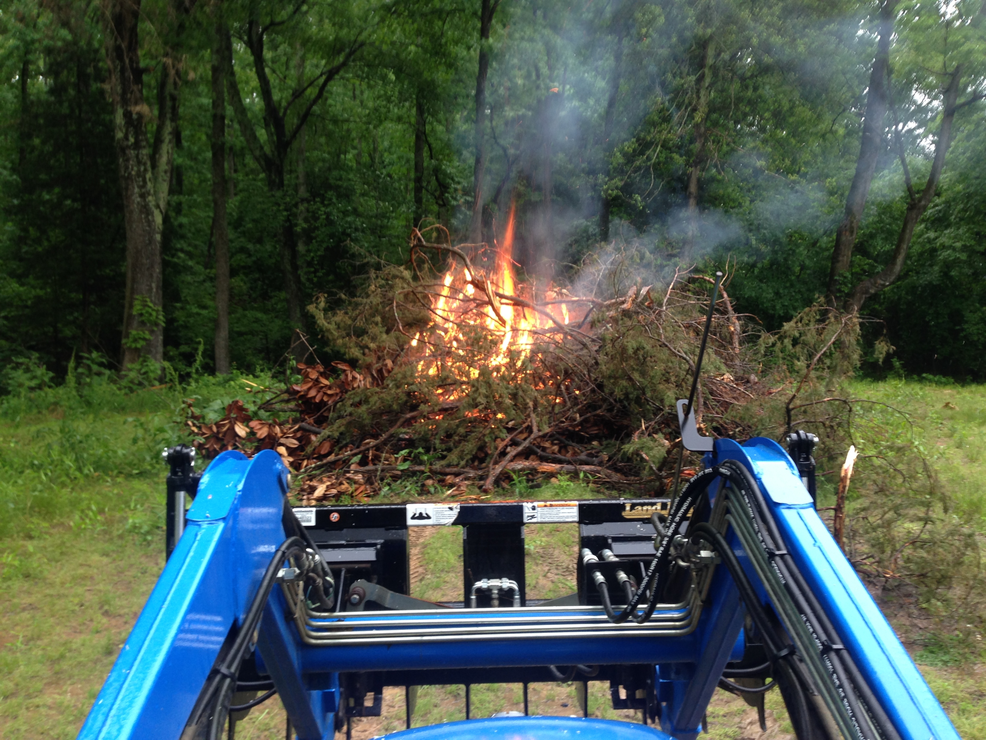

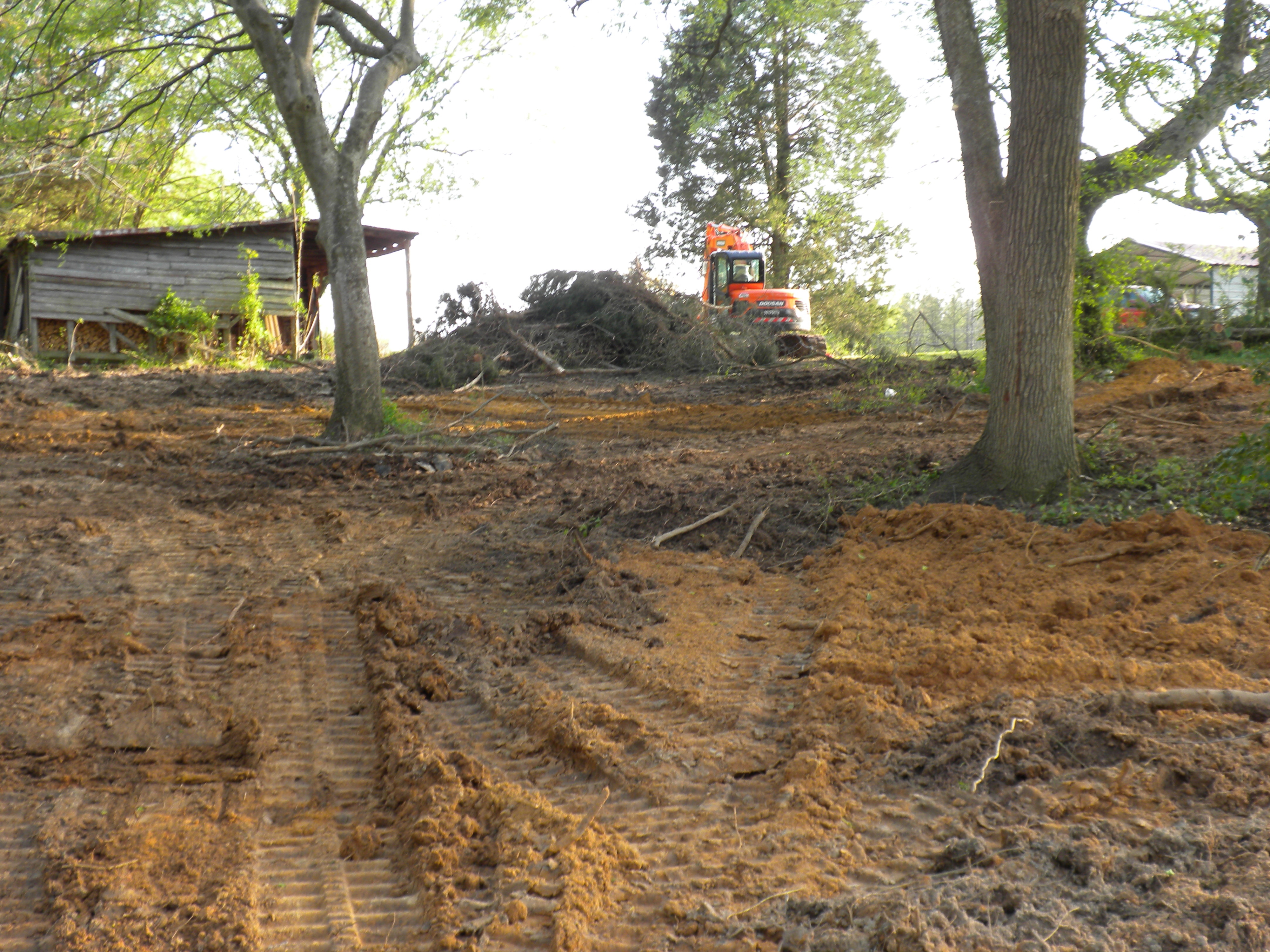

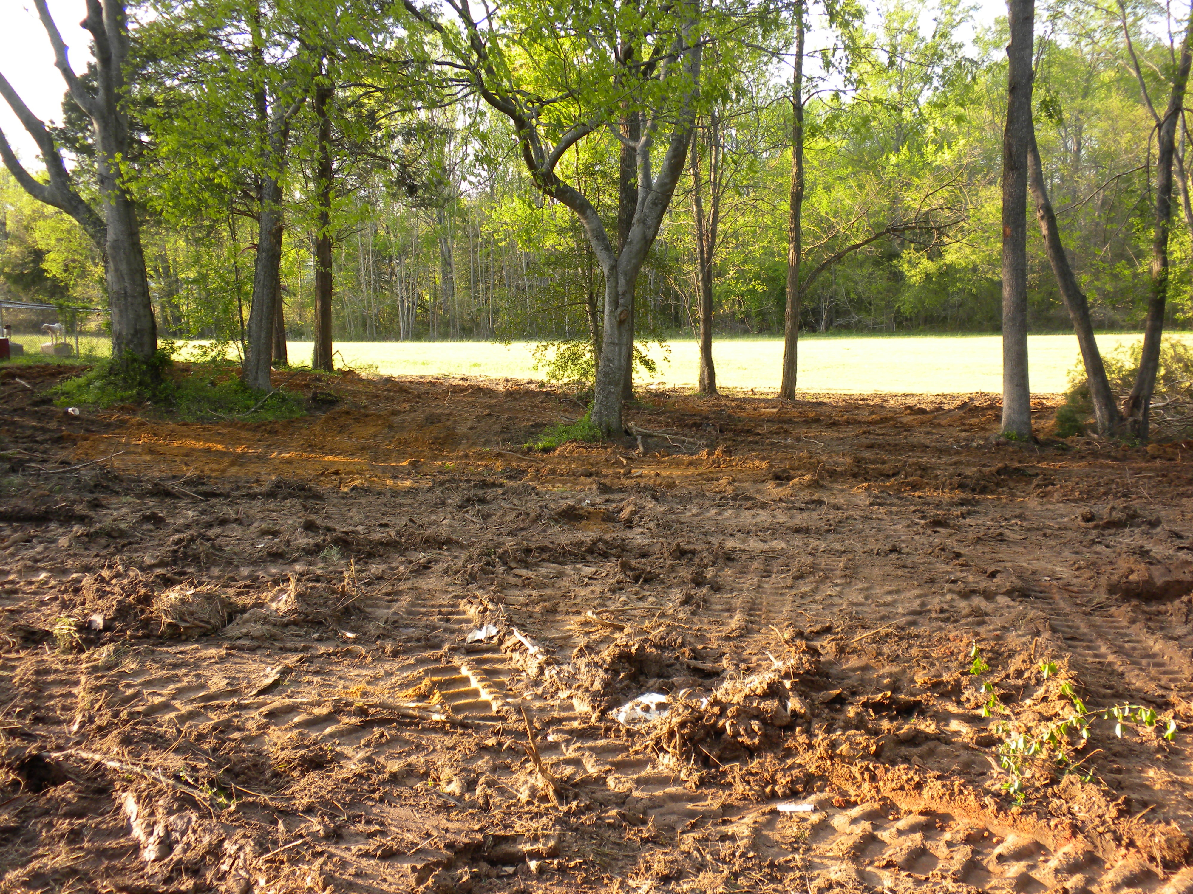

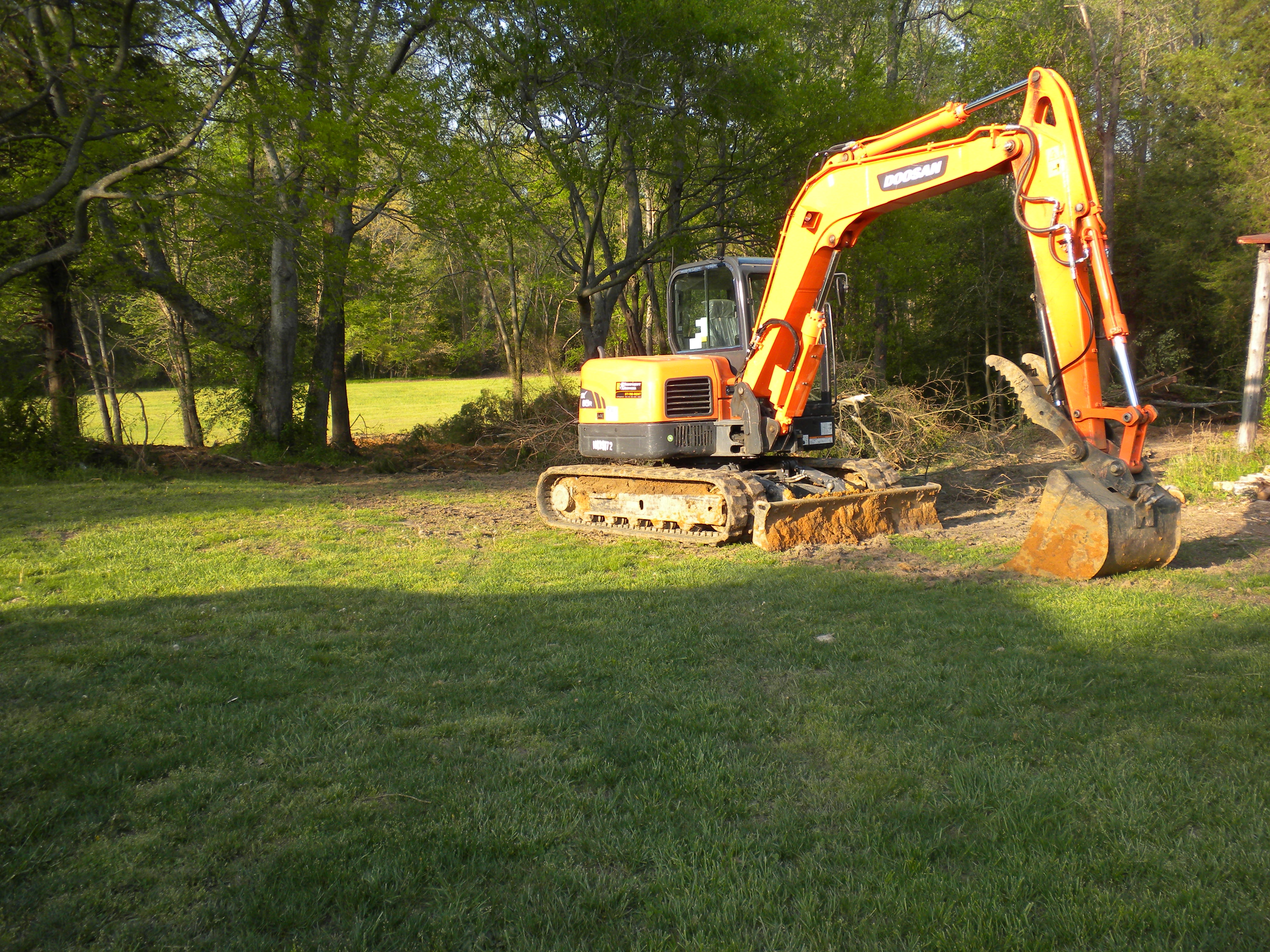

Before I had my current excavator, I needed to clean up an acre of land on my previous property. Lots of good size trees, junk, big concrete chunks and such. I started this project with just my tractor and tools. Soon realized I needed something better.
I researched and rented a mini-ex. I got the biggest one the rental place had at the time. I worked on it for a week and got everything done except burning the piles of stumps and sticks. After that, I did all the finish work with the tractor. It MAKES a big difference with real construction equipment to get clearing done if you have the funds to do it.
If you can swing it, rent the mini-ex and clear it the way you want it, then take the rest of the cash and look for a tractor after for clean-up work.
