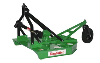

I suggest a 4 ft rotary mower is the first thing to buy. It will shred not only grass and blackberries but also shrubs and saplings, anything you can get the front axle over, - and also shred dry pruning debris up to broomstick diameter. And its bullet proof. I hit rocks occasionally and finally looked expecting to see the blades dinged but no, just a couple of very tiny nicks, over 20+ years of this. I think a flail mower would have costly damage.

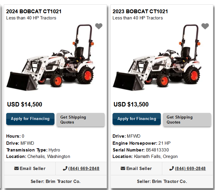

For your budget:
Tractor and Loader View attachment 1510653
Really nice list! Only thing I'd add would be a ballast box, as that's pretty much always attached to my machine. It's also configured as my tool carrier, which would probably be very useful to the OP, if they're gardening with it:

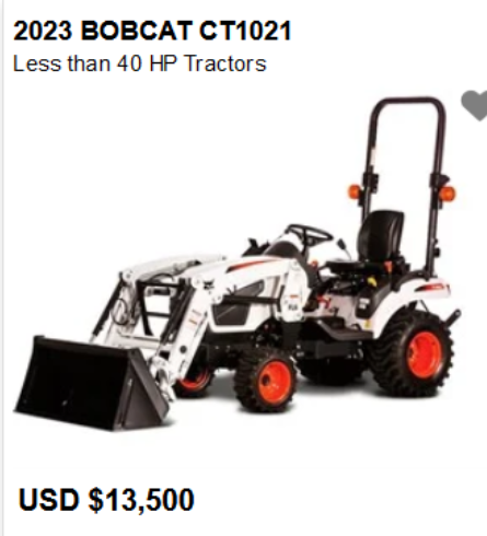

But am I the only one having trouble figuring out how Bobcat is hitting that price point? I've not shopped new tractors this size, so maybe my barometer is just way off.
One thing to note, if "moving wood", we need to know what that means. This machine has only 600 lb. lift at the loader. That'd be fine for moving some split firewood or mulch, and could probably even do dirt or partials of crushed stone in that small bucket. But you're not going to be chaining onto and lifting logs with that lift capacity. I'd also skip the pallet forks purchase if buying a machine that size, as even empty forks are going to use up more than half the capacity of that loader, before you try to lift anything with them.
It's probably a good machine for the right person, I'm not saying it's not, just be aware that you won't be lifting 1000 lb. logs with it.

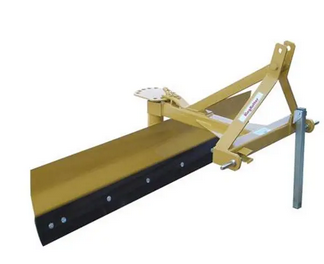

5' rear blade for road maintenance and snow removal $500 View attachment 1510650
I'm not sure how much snow the OP gets, but a tractor this small and light might struggle to move snow with a rear blade, unless they plan to load up the tires or add ballast in some other way. Your challenge in pushing snow with these smaller machines is always traction, not horsepower.
Back when I had my Deere 855 MFWD, which was a little bigger and heavier than the Bobcat, I found I could push 6" of snow with a front blade, but really not much more unless it was powder-dry. If I'd loaded all my tires with ballast, then it'd have done better, but I really didn't want to run ballast the rest of the year in that machine. Whenever we'd get bigger snows, I would have to hook up my 3-point snowblower, and that could easily do up to 2 feet on that machine.
Rear blades are a nice cheap solution, but you're either driving backwards, or trying to drive over and then pull snow up against your rear wheels. Also, you're forced to remove any rear ballast box, when using a rear blade, which hurts your traction a lot. It can work as the least-costly solution, but it's not ideal, so just keep that in mind.
Turned out that back-dragging with the loader gave me the smooth surface I wanted.
This works really well if you have a removable tooth bar for your bucket. Install tooth bar to break up and roughly level the material, then remove it to finish.

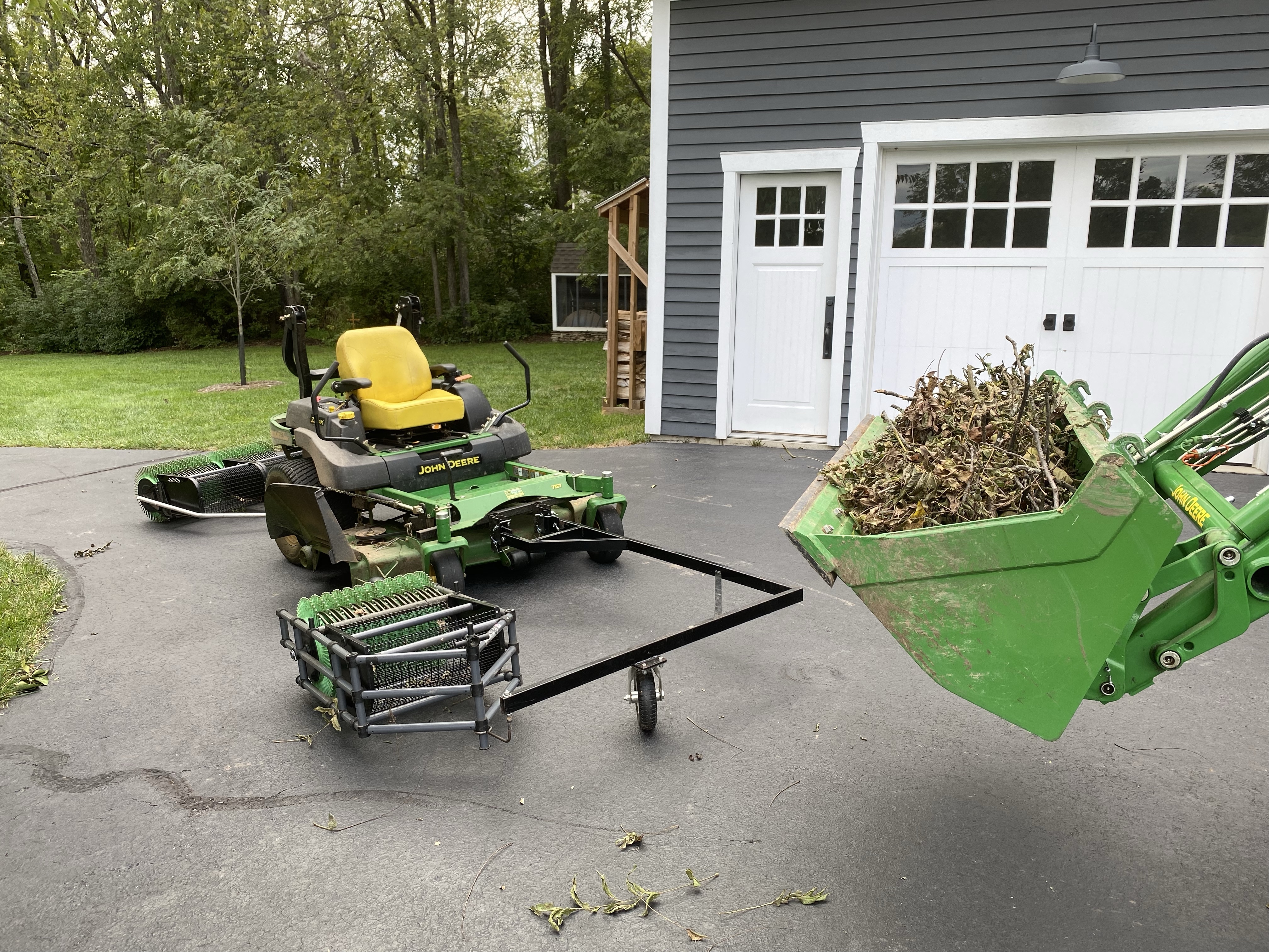

So, based on your comments I do basically the same thing here as your goals are. The Zero turns cut as needed and do it quickly. If you need a whole lot brushed at once, I'd suggest you hire it out at first and get it all beat back. Then cutting it with a ZTR that can handle it will be fine. Especially one with power and suspension to do it fast. Ferris makes a full suspension and Stihl also has them as well (Ferris manufactured).

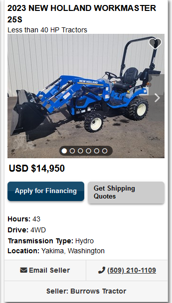

My choices would be a John Deere 2025, or a Kubota LX 2620SU, but both are over $20,000 for a tractor and loader.
Here are a couple of lower priced options:

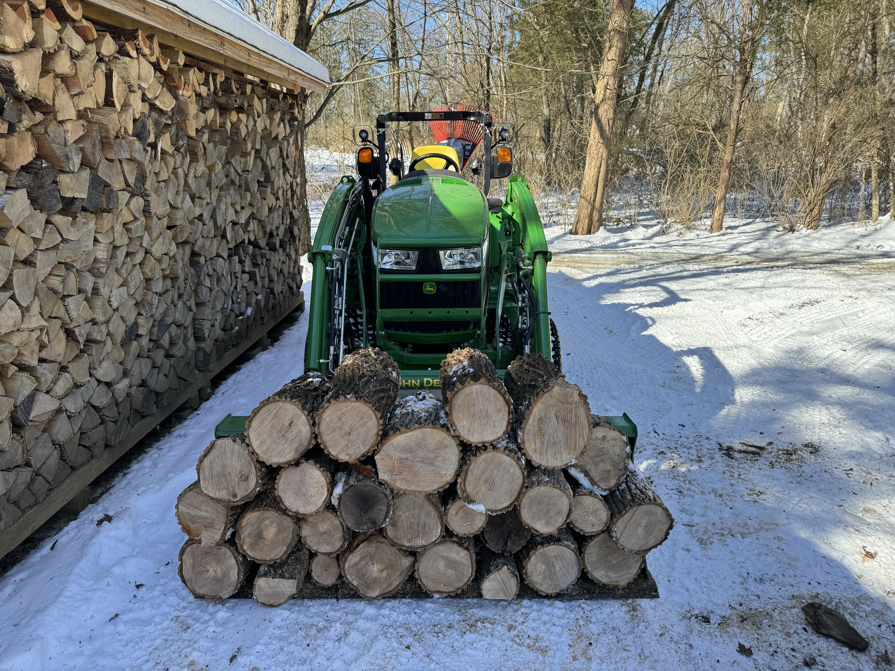

Side note on the firewood hauling, you can get some fairly cheap 3 point forklift forks for the back of the tractor (especially shopping used, I see them on craigslist and marketplace for $200+- occasionally) which work really well for lifting pallets of wood especially if you can get some IBC tote cages (basically the IBC totes minus the plastic tank) cheap (there's a place in central OR that sells themfor like $25/ea) they work really nicely for stacking small stuff in and hauling it. One commenter (sorry it's a couple pages back) noted that the FEL forks take up a lot of the weight capacity of these small loaders.. and it's definitely true... If you do get those it's worth shopping for the lightest ones you can get for a small tractor. They are still pretty handy for hauling stuff around IMHO (I use pallets to move stuff out of the back of my truck, for moving plants around the place, and some similar activities which aren't super heavy.. I bought a set that's a bit to heavy for the B because I also wanted to use them on the bigger tractor.. tradeoffs..)

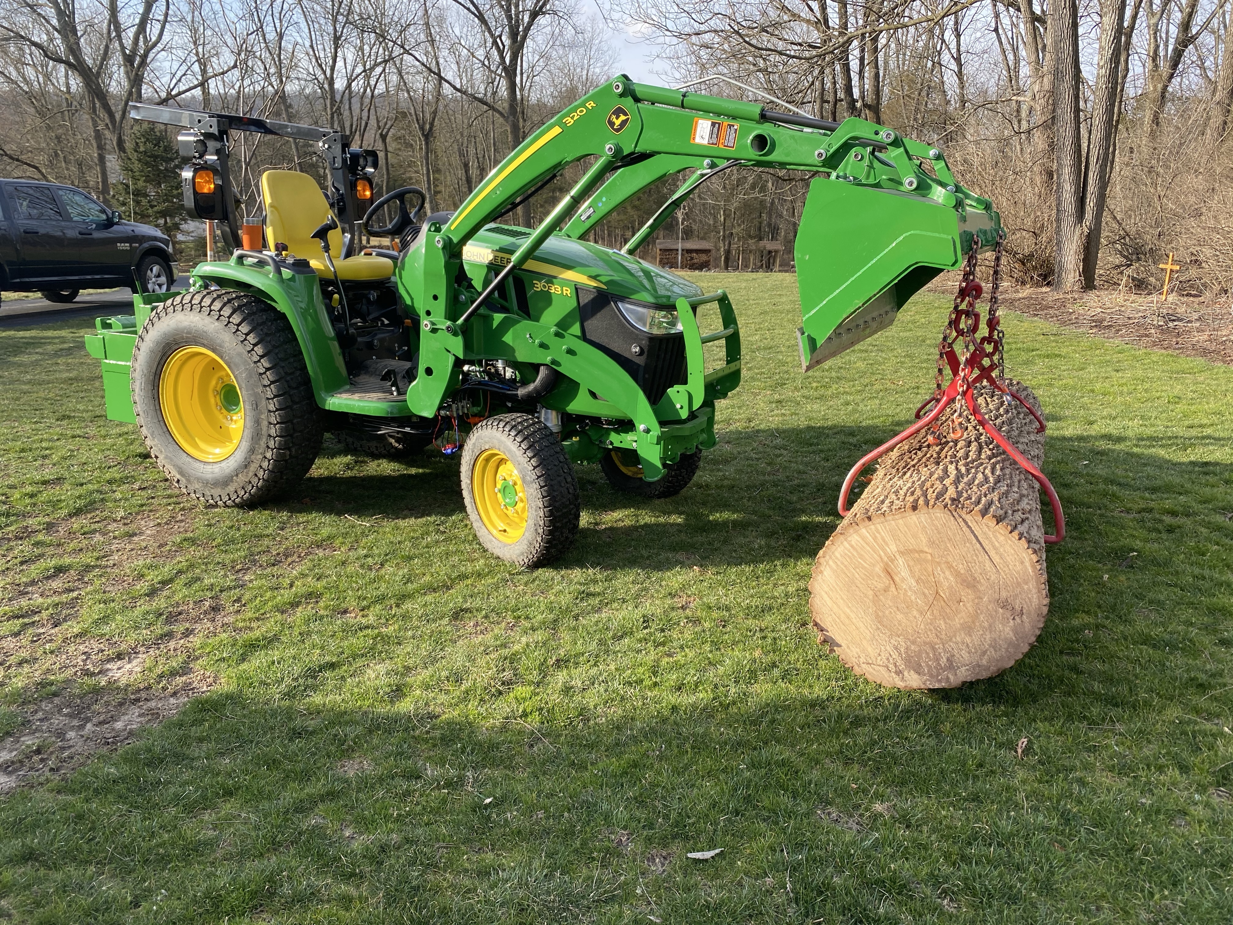

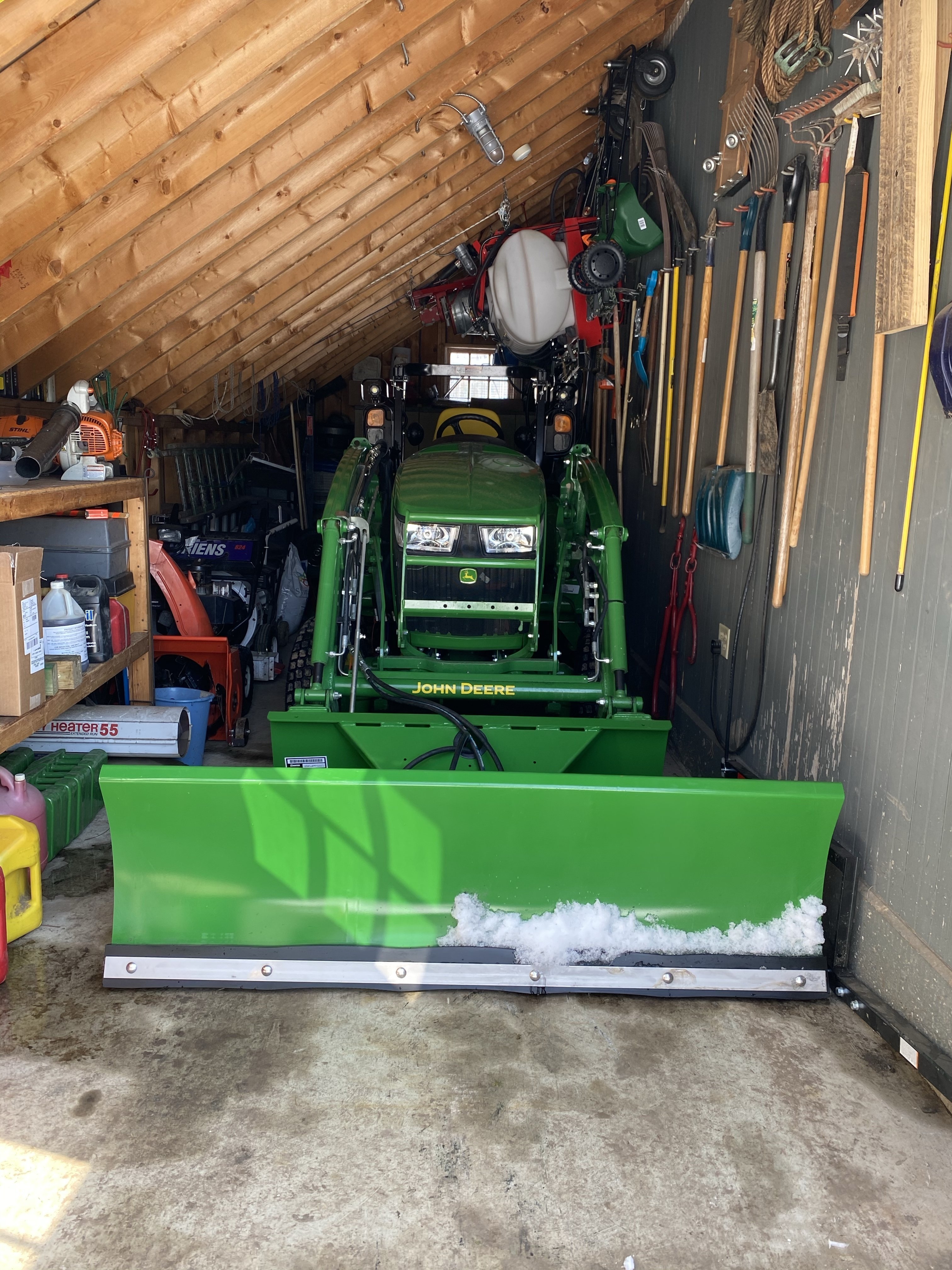

Wood moving - I just mean split logs, fallen branches - usually like to break them down before moving them
Like this?
Front load is chained so it won't fall out.
