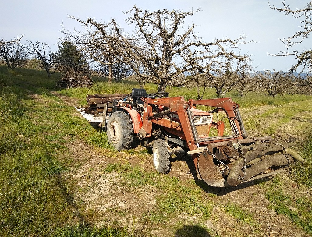

Wood moving - I just mean split logs, fallen branches - usually like to break them down before moving them
Like this?
Front load is chained so it won't fall out.
Rear is a platform the size of a single bed (the source for its steel perimeter) mounted on a pallet, carried on 3-point pallet forks.
And note the rear wheel weights, they are sufficient for most loads in the front bucket.
