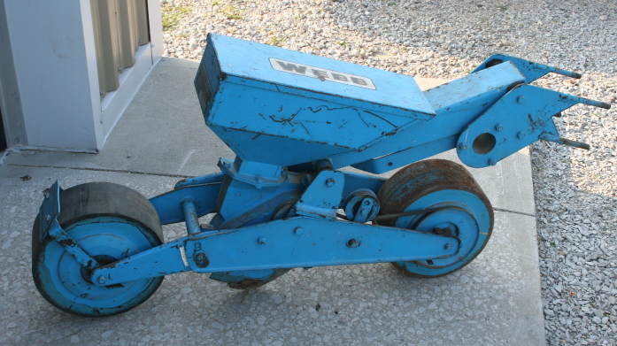

bayoubilly, is your stanhay presicion similar to my Webb Precision Planter? I have a two row model but can not plant rye, wheat etc with it. Webb was purchased by stanhay a while back.

it is similar but model # might be different . stanhay seeders seed belt must be punched to the size seed exactly . can not be used for different size seeds must be exact size . seeds must be sent out with belts to be punched , precision planting will have no wasted plants to be thined out . only 1 seed at a time at exact spacing . cole/planet jr have a built in seed plate for muti size seed planting but not precision ,close .JD seeders you have to change seed plates .but grasses ,wheat, rye ,clover different shape seed you'll need different type seeder. overseeder for that type of seed $$$$$$$$ .broad cast seeders do not have very good soil seed contact seed won't develop good root system ,1st dry spell will kill it.,if you looking for 1, get 1 on a tool bar were you can adjust the row width easily in the field with 1 wrench ,there only good for row crops . don't get any thing too old .been there done that ,up too date ,at best price is a investment, research the equipment.
