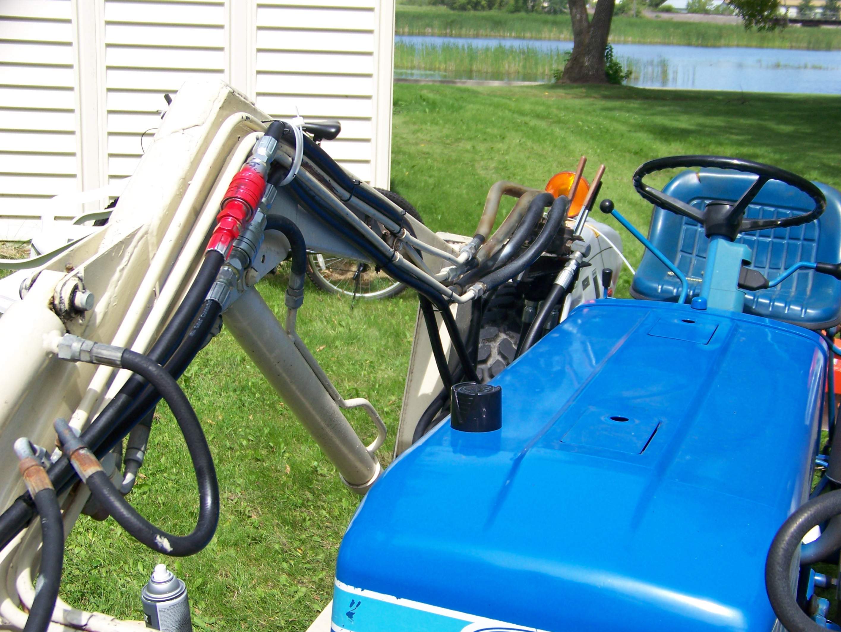

4. Has anyone worked on a way to quickly install and remove the thumb so it doesn't have to be on the bucket all the time? If so, can you share your idea and some pics?
The mounting base is bolted on, but the hinges are actually very heavy pins that are held on with cotter keys, therefore, easily removed. I put quick connects in the lines and color coded them for such an occasion, so removal/reassembly is super simple. (pics. #2 )

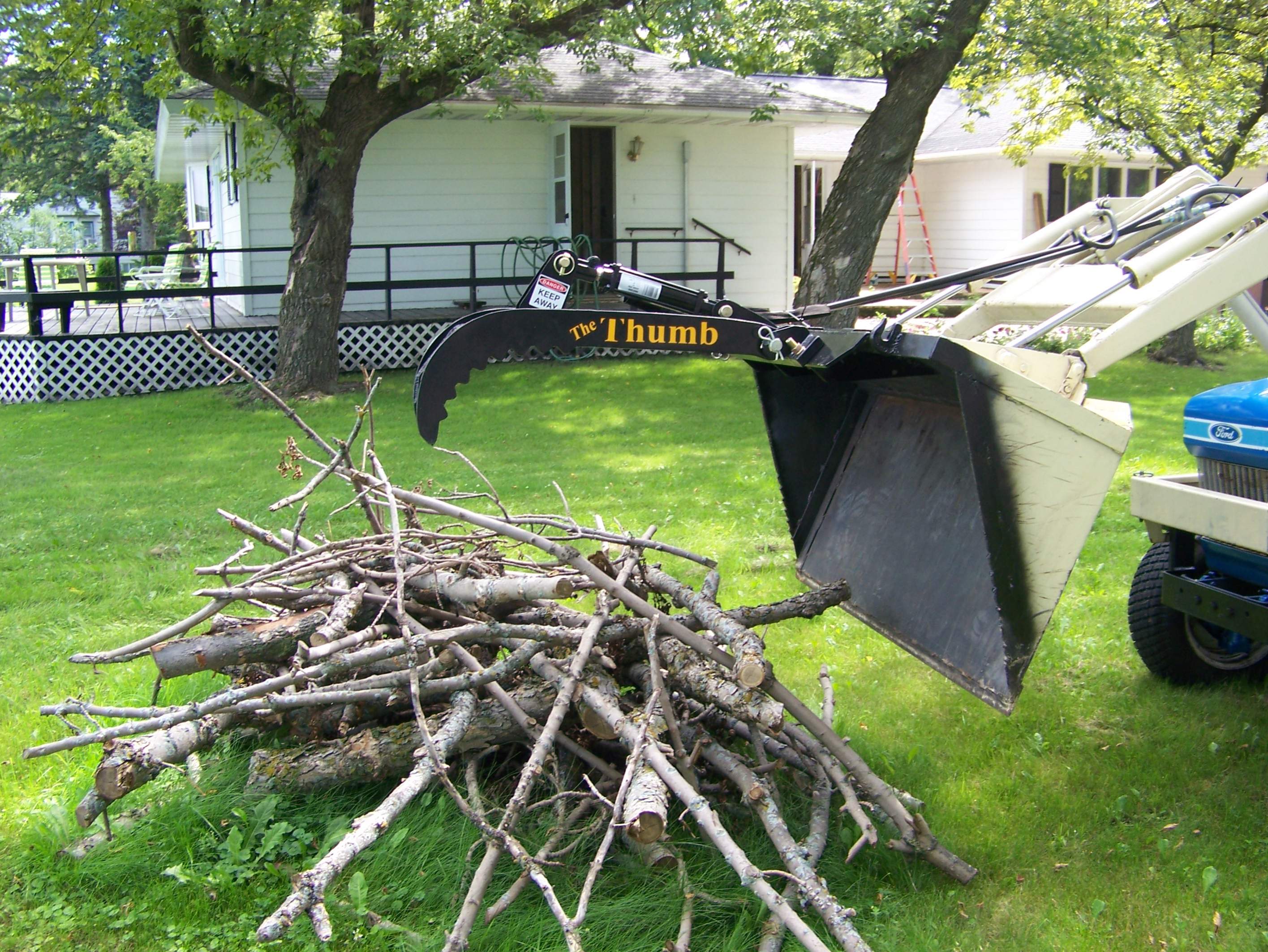

5. Does it open wide enough?
It looks like it will swallow small countries! Seriously, it opens way wide, as my bucket is over-sized and as such, I bought the largest size they made. The combination will swallow huge loads. (pic. #1)

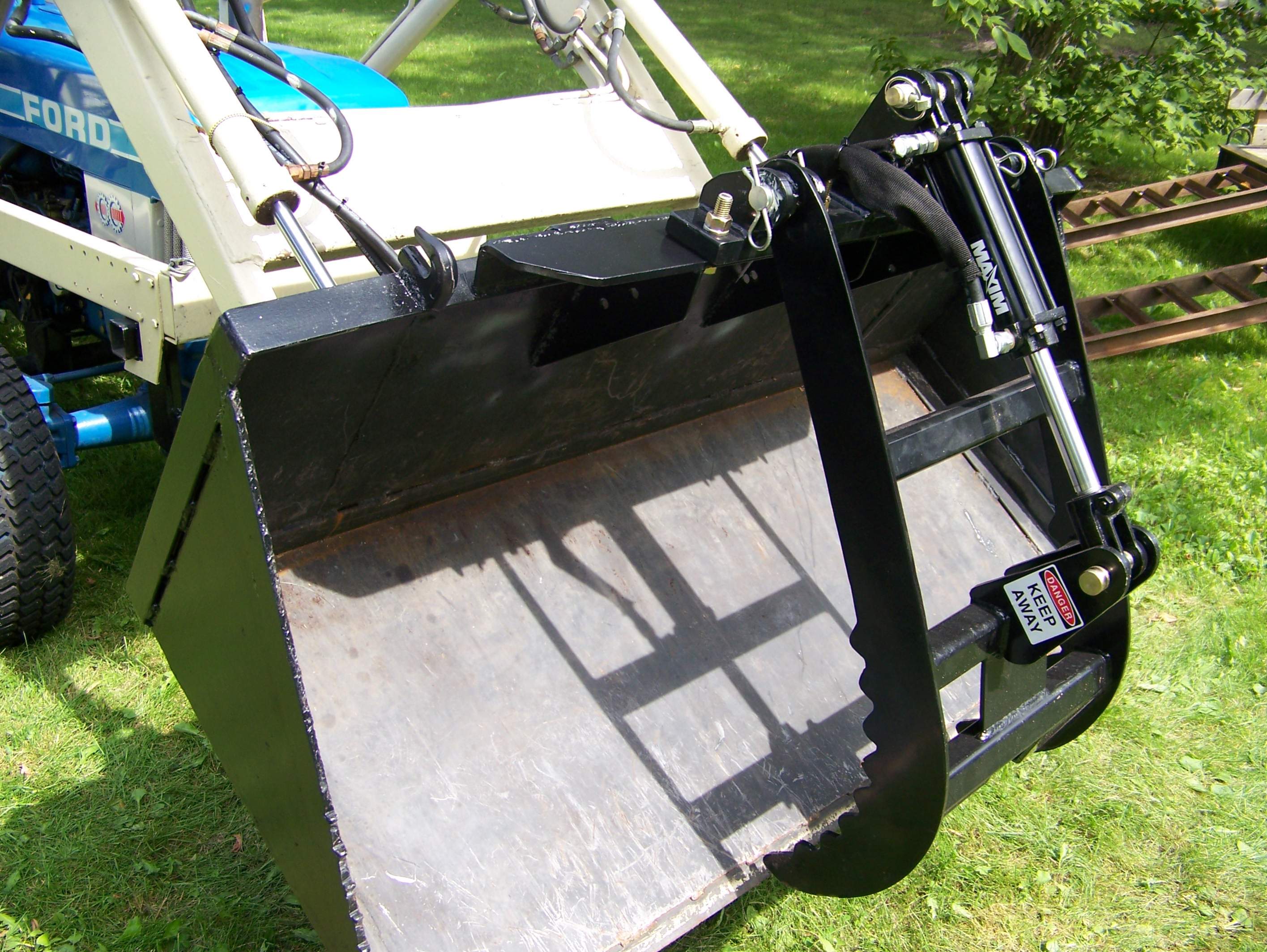

8. Was it difficult to determine the correct length to get for your bucket? Does it match the size of your bucket well or does it have too much of an "overbite"?
They have instructions on their website how to measure for proper fit. Not very hard to do at all. Overbite will be determined on the installer. You have full control on how you are going to mount it. We clamped an 1/8" piece of shim stock between the tip of the grapple and the cutting edge of the bucket to give a reference point at full travel. We then blocked the cylinder at full travel to find out where the base of the grapple needed to be. We then blocked that in place, measured what we needed for steel and manufactured our base accordingly. Sounds fussy, but well worth it. At no point, can my grapple contact and bend my cutting edge when empty, and it matches up very well.

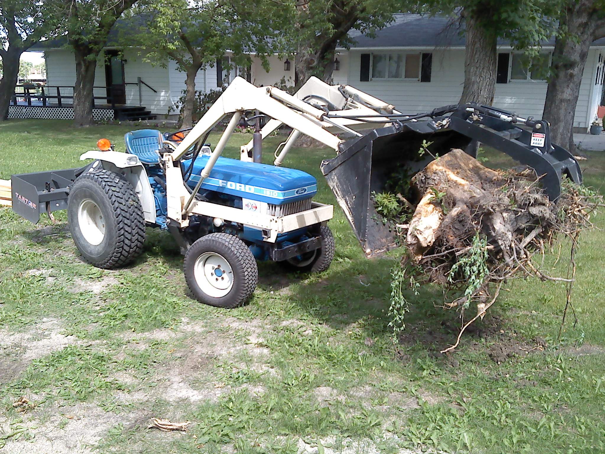

   / Questions about "The Thumb" for a loader
At any rate, you saw the size of the stump I was able to grab.
Joe, I definitely did see it and it's impressive!
