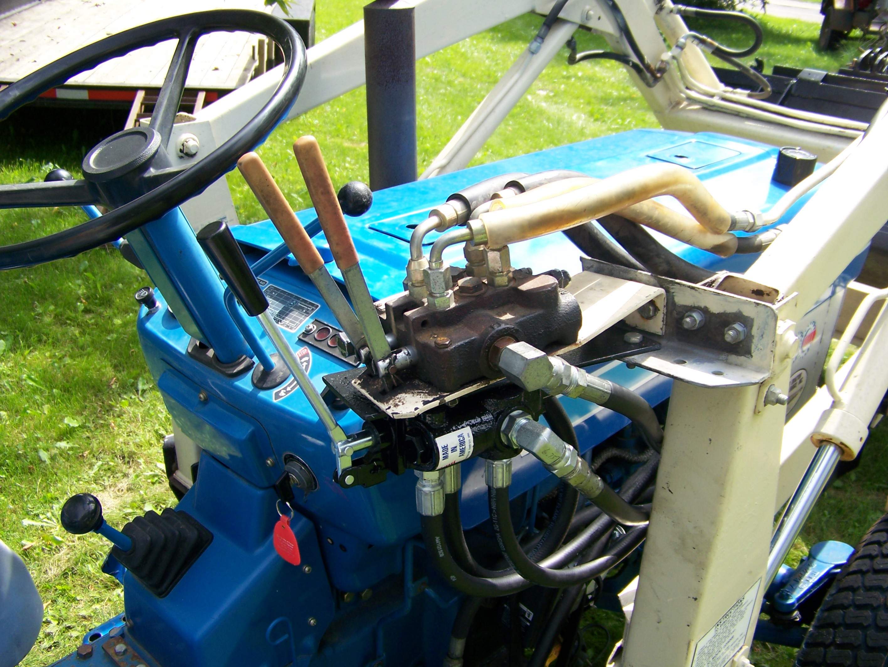

Instead of using an electric divertor valve I used the power beyond kit and mounted a 2spl valve. Then ran 2 wet lines to the front. Unfortunately changes were made to this site and I can no longer upload pictures from my BlackBerry or I would be happy to share.
I also added a 2spl valve, as my current controls had power beyond. I've used multi-function joysticks on the forklifts at work, and although they are slick and enjoyable to use, I was just too cheap to go there. :p Besides, the extra lever doesn't bother me any. The faded red (pink) levers are the loader controls and the black one is the grapple.
