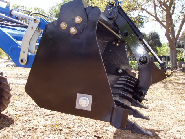

I'm not going to go in to which FEL grapple I selected for my tractor but I do want to give you a suggestion as to how to figure out a grapple that will fit your bucket.
1. Determine if you want the grapple to curl into the bucket (under bite) or curl over the cutting edge of the bucket (over bite).
2. Contact the grapple manufacture(s) and send them a full sized drawing of your FEL bucket's side/end plate. They should be able to autocad that drawing, design the grapple teeth length and cylinder stroke length then archive/catalog it for future similar tractor FEL sales down the road. If they balk and place it back on you, walk away.
I don't think they can determine if when fully open it will interfere with your grille guard.
If you are having even the most remote thought of purchasing a toothbar, work it in now as the TB and G need to mesh without any interference.
Your going to be dropping upwards of two grand to complete the project so try to get it right the first time-others here can attest to fit up issues.
I agree with your recommendation of planning the thumb with the tooth bar if the operator is going to get both. A poster on another thread about whether one should get a BH or not recently made the observation that most people he'd seen with a tooth bar didn't have BHs, and those with them usually didn't have tooth bars. After thinking about that, I'm having to agree. The only time I've ever wished for a tooth bar was because of hard ground when I didn't have a BH available. I, fortunately, do have access to some and am also in the process of getting one for myself, so I don't think I'll need the tooth bar. But your recommendation to plan both together if getting one strikes me as an astute observation -- thank you!
