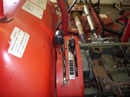

Mark, I see what you're talking about on my YM-1700, but I don't have one on my YM-2020.
I have an extra lever by the lift lever, as in the picture, do you happen to know what this lever is for?
Thanks
Eddie

Now that is interesting....that very well could be it. Similar to the "F" and "FX" models?? I just know your tractor has got to have one somewhere /forums/images/graemlins/smile.gif. Also agree with Norm about the implement lock partially open starving your pump.
Someone will hopefully chime in and straighten us out.
Mark

   / Questions on 2020 #27
The extra lever is draft control. It is used to maintain a depth level when plowing. You have to have linkage to make it work. To date I have never had a tractor with the linkages to make it work. I have had some with the electric over hyd. that would work.
