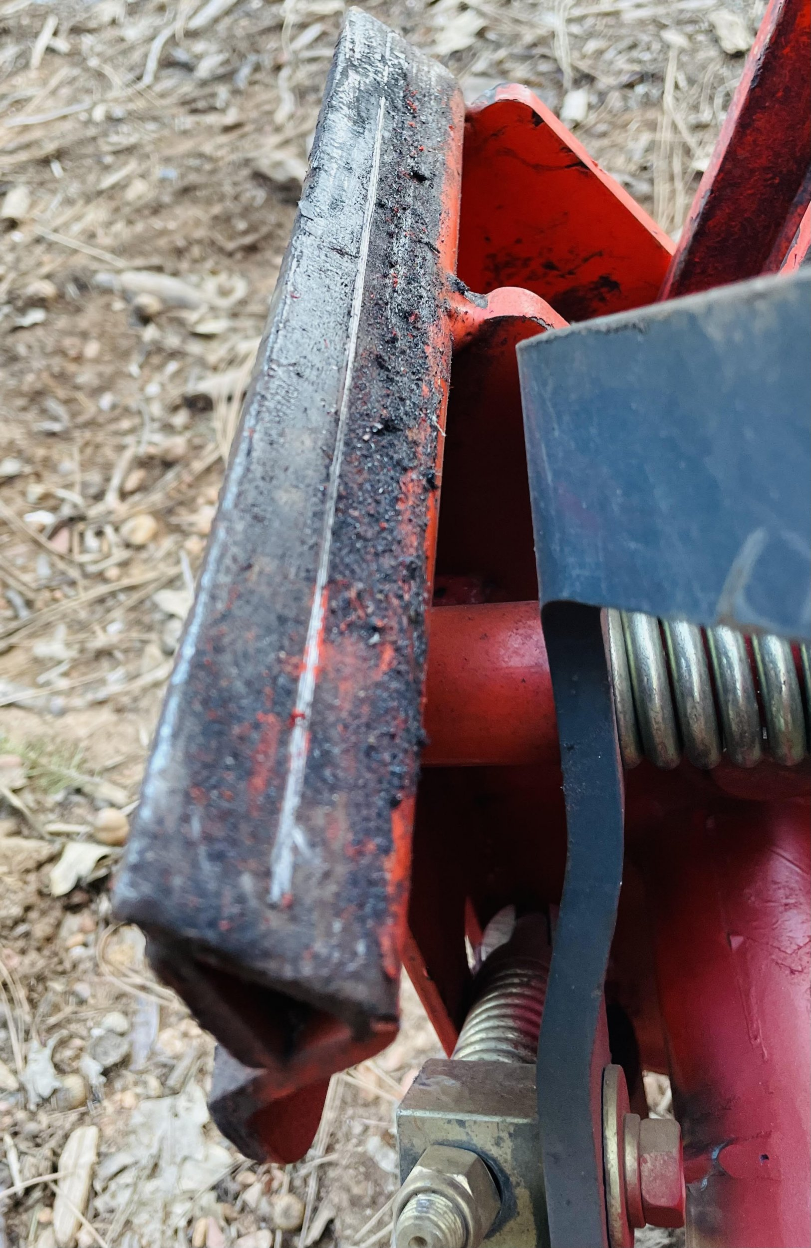

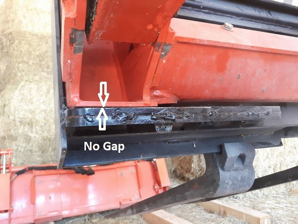

I've had to cut and weld my torque tube a couple times, and I'm thinking my QA is still slightly out of alignment due to engagement I see and before I tweak something again I'm looking for info to make adjustments again, if possible.
I've attached an image with a line I put on it which is the edge of engagement with my bucket.
What's the measurement of engagement you are seeing on yours?
I am hoping people can share their measurement and maybe even a pic or two.

Well, too much snow here to take pictures of mine, and hard to comment when just seeing one side of yours. But I'll give it a try. I know I've been concerned about exactly the same thing. Most recently when I loaded out my rock bucket and when I got it back it just did not fit the same as it used to.
What I am seeing on your photo is a continuous line from one end of the right hand QA top piece to the other. That's good; it means you are getting contact for the whole length.
And the contact line itself looks to be worn to about the same depth along its length. It's not horribly deeply worn at one and and nothing at the other.
So at least on that right side of the SSQA you have a full and even contact line within the boundaries of the upper contact area - that's all good. You have good support there for the SSQA
This is a good time to take a picture of the left hand side too. If the left hand side is as good, I'd say you have a pretty strong and even connection to the bucket. Of course I know you are concerned about the line not being parallel to the edge of the V support of the SSQA. But that is less important than having full engagement. So I woud check that other side before we look to see if the bucket or the SSQS are twisted.
I say that because it may well be that the bucket is not only well supported but also level with the ground. In that case what you are seeing could simply be that the welding of the SSQA V section and the receiver for the SSQA on the bucket were not held perfectly parallel when they were originally manufactured. That would be very possible - almost impossible to fix, and wouldn't need fixing anyway since it wouldn't hurt a thing in use.
So what we don't know are two things: Is the bucket itself parallel to the ground? And are all 4 of the V engagement areas on the bucket and SSQA adapter welded on xactly parallel and perpendicular? The bucket being level with the ground is easy to check, and that's good since it is most important. So do that first.
Checking the bucket parallel to the ground isn't hard. You may already know. And if it passes that test you are good regardless of those wear lines not be parallel to the edges. So find yourself a dead level area as long as the tractor with bucket - and don't use a paved road with a crown. Park there & lower the bucket until it some part of the lip just touches the ground. Maybe let it down a little more to take up some of the slop in the pins...and then get off and have a look at how parallel the bucket edge is to the ground along the length of the cutting edge of the bucket.
I admit I haven't checked mine so rigorously, but I do keep an eye on it. Most of us probably do. And it wouldn't surprise me to find that most tractors are at least an inch out of whack or more - though I haven't heard of anyone actually checking enough FELs to have a meaningful opinion. About all we can say is it ought to be as even as possible.
Let us know what you find.

Thanks @rScotty for the detailed reply. The visible line is a score mark I made to highlight current position, as you can tell it's a bit nasty with grinding dust right now :D I'll check if it's level, but this is the Kubota Bucket and so far their attachments have been much better in terms of quality control and being even on all points vs. aftermarket, but that may not be universally true :D
Backstory on this... I was unloading a 1.5 ton pallet of feed and was about 6" off the ground, perfectly level when the fork attachment came disconnected from one side and put all the weight on one and tweaked the tube so bad when I cut it one side was behind the other... some cutting and bending and welding and it's even again. But it's made me examine the engagement to be sure that's not part of the problem. I do have a couple other pics of the QA frame the tube goes through, and it's actually bent inward (to center of tractor) from each side maybe 1\8", enough I can see it but in a picture it's challenging, I'll get those posted.
It's looking like maybe one of the QA Springs may be weak? (or both) and allowed movement due to leverage from the weight on the forks and the fork attachment being low quality as that connection point is slightly bent too.

Well, what a shame! It's too bad that is a score mark you put there rather than a wear mark made by the bucket SSQA receiver. That does makes my whole argument much less interesting and rather irrelevant.
The back story makes sense now.
I wrote so much detail because I've seen that mark before. On the FEL portion of the SSQA on our M59, I have a similar mark that is definitely a wear mark put there by the bucket attachment. And just like yours, ours shows that line being at an angle.....not being parallel to anything else.
Our various buckets are level and all are good, so I know that it doesn't have a problem. But it still doesn't make me happy that the bucket I loaned out came back fitting differently. It was used on a skidloader with a hydraulic SSQA locker and that might have been it.
Our SSQA has let loose a few time during hook-up when swapping implements - but only once because I didn't get the pins down good, and then it didn't have a load on it so no damage. But it did convince me of the need to keep those springs clean and that area well greased. Was surprised to see that Kubota put zerks there just for that.
The SSQA is a great advantage - though it may not be the best of all systems. I like the European system and haven't studied the JD.

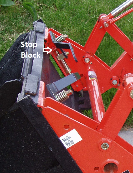

Some guys have added stop blocks so the pins can't be forced up with the levers down:

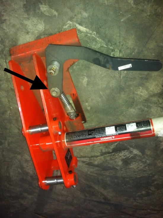

Also check that the lever is taking the top of the spring over center:
This prevents the pin from pushing up on the spring and raising the lever, unlatching the attachment and bending the tube.

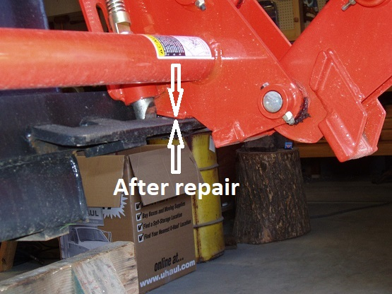

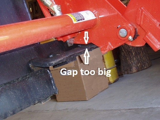

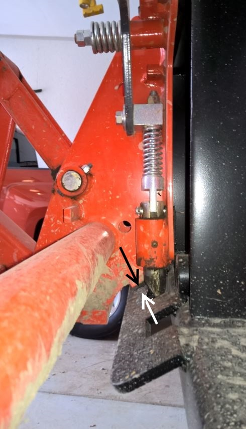

The other problem area is too big of a gap at the bottom, this is the main cause of bent tubes:
It can be corrected by adding a shim plate:

That stop block is great! I will be adding those! That usually isn't my concern but having seen the pins bounce on hard shakes and having caught some limbs with the grapple on handles this will be useful.
Can you elaborate on the "Also check that the lever is taking the top of the spring over center:" how would you adjust this?
My lever does bottom out\touch the side of the bucket as pictured, and no gap on bottom of my kubota bucket I'm testing with and the pin still hops if I'm shaking it like I'm trying to unload sticky mud or clay.
Adjust by grinding the lever where it touches the frame so it can move farther over:
Washers can be added to increase spring tension if needed:
