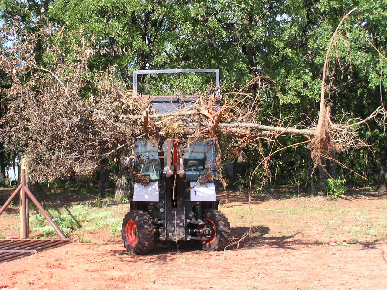

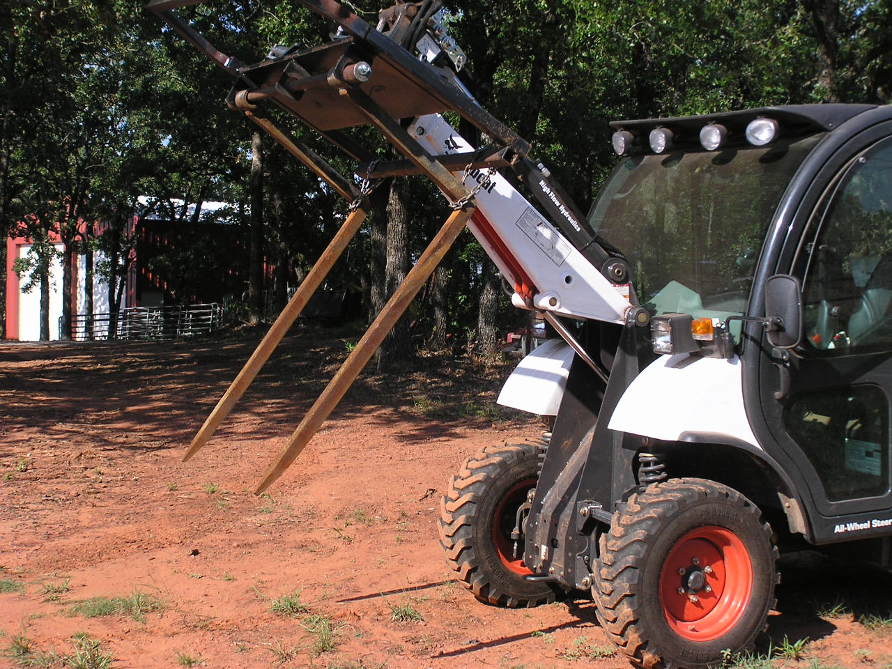

Exfaxman, that is a awesome looking rig; thanks for the operational definitions.
Thanks, more info in the Toolcat Forum. Some of my pictures here: http://www.tractorbynet.com/forums/toolcat/270965-toolcat-5610-series-f-pictures.html
