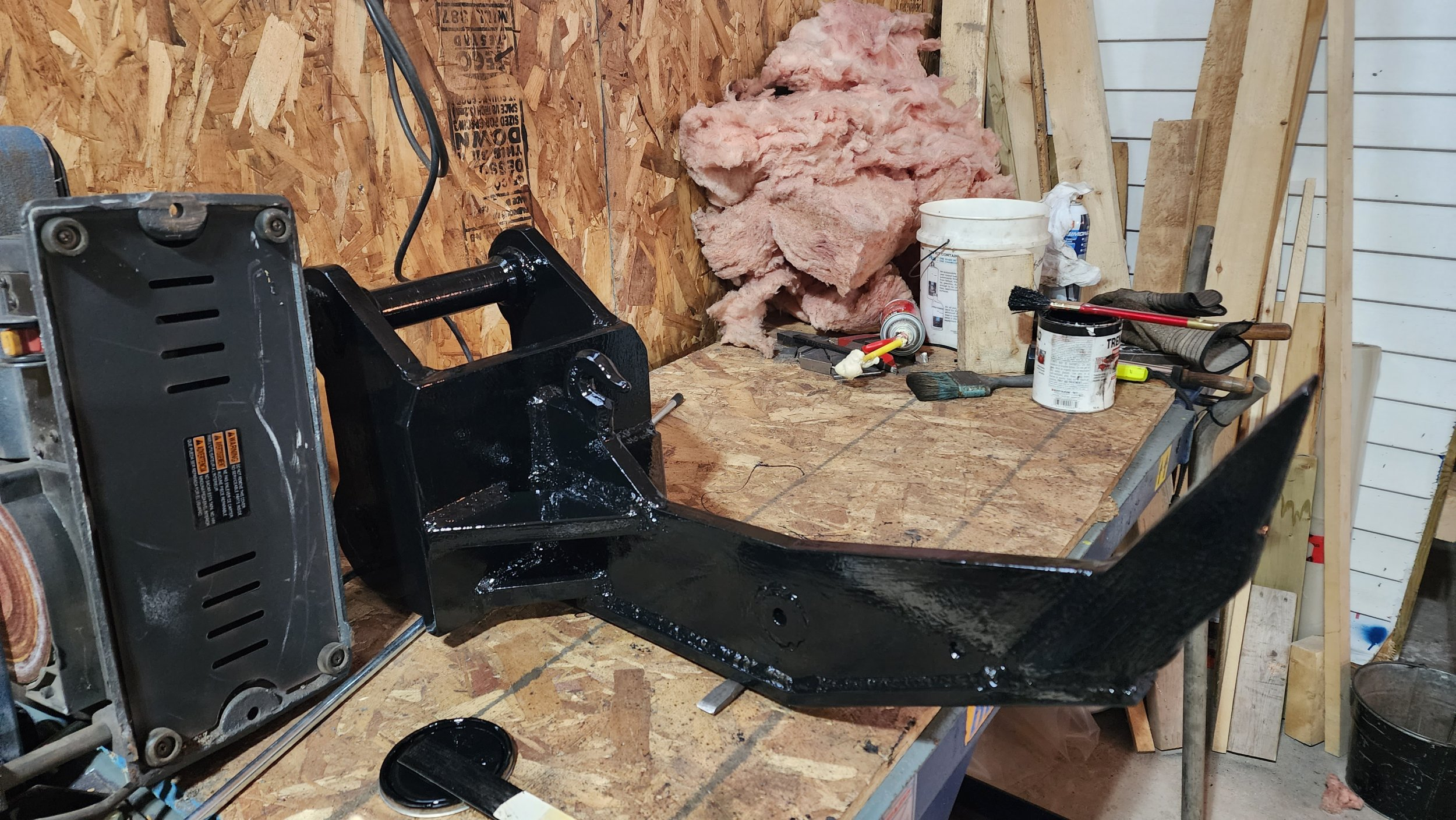

It must be nice to have heavy steel just laying about. What thickness did you use for ripper blade? MIG or stick for welding? How long did you make ripper ( dig depth before hitting reinforcement at coupler)? What is bucket curl force? Trying to compare how your 303 compares to the M59. I am seriously looking at mini excavators.

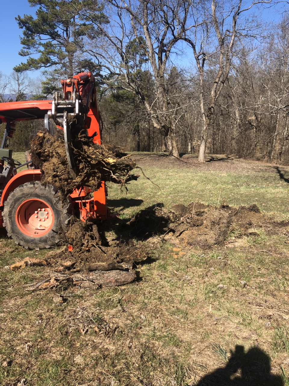

I used to have a M59 and the 40 is definitely a good bit stronger. But 2 hours for one stump is pretty depressing when my cat would do it in 1 minute. I’m probably still going to buy a ripper for the 40 because it moves a lot more than the cat does. I’ve considered buying a ripper for the cat. I think I could split stumps in half to increase the burn ability if I had one.

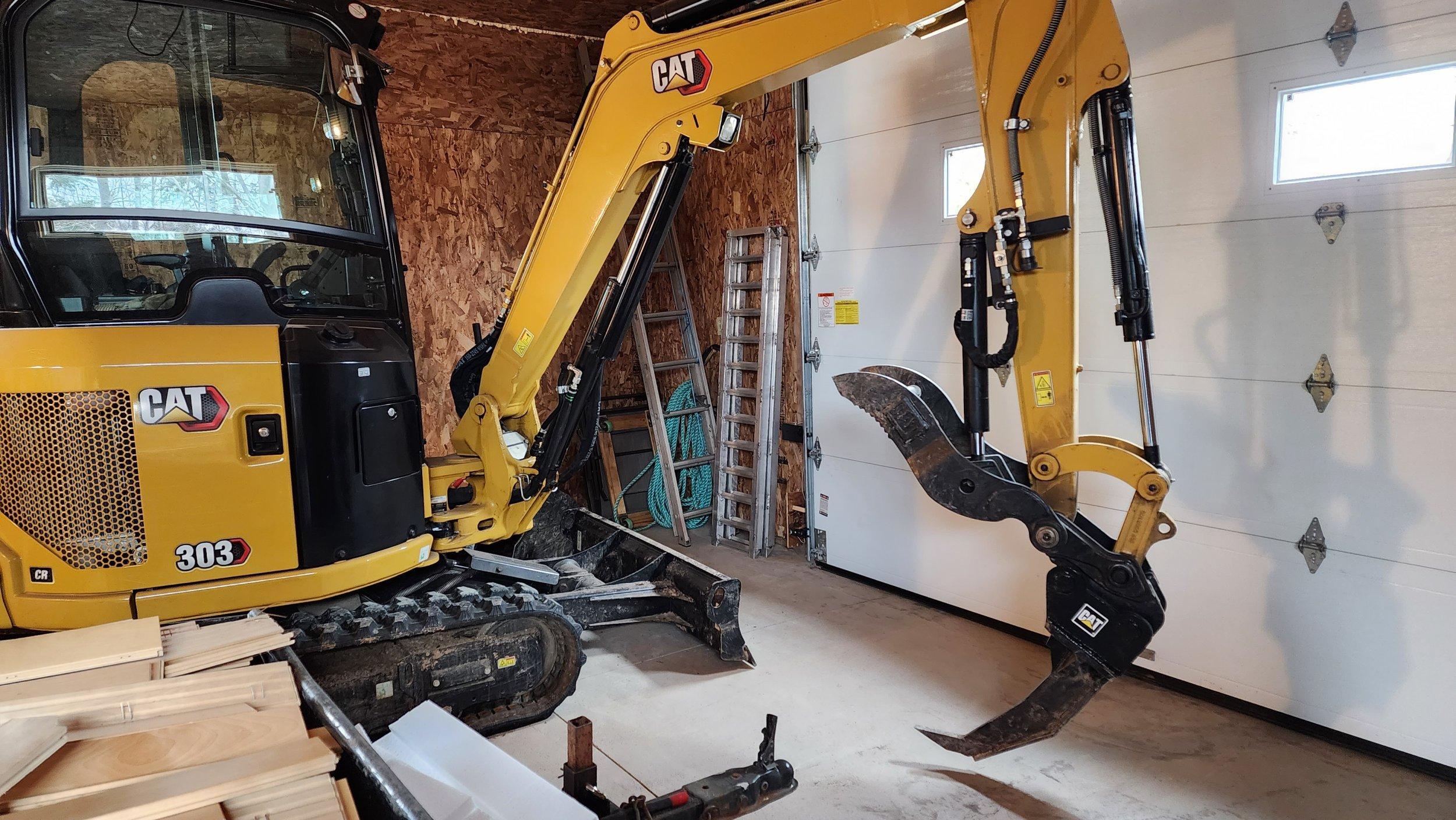

The ripper blade is 3/4”, 24 “ in length, gussets are 3/4” onto a 3/4” top plate with same size bucket ears, with 40mm pins. 6385 lbf curling & digging force. It’s weight is listed 7817lbs ,this 303cr has the heavy counter weight with a longer stick.
/ Quick attach root ripper for M59 #26
For welding I used my millermatic 185 with multiple passes, usually 4-5 passed with duel shield. 035 wire.

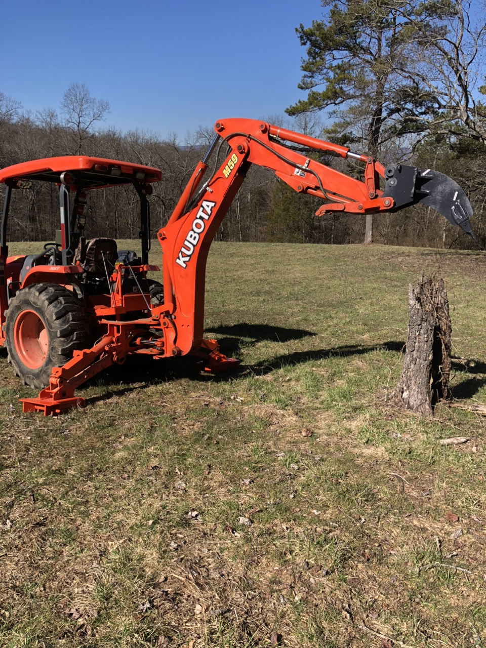

Thanks. The info is appreciated. The KX040 ripper I have on my M59 will dig 21" deep at which point the ripper mount plate is also into the ground. I'm curious to hear how your ripper performs against various types of trees and their stumps. Your 303 and my M59 have very similar bucket curl force. Your machine weight at 7817 is slightly less than my 10.5-11K Lbs. I'm trying to gather information on machine weight and curl force vs stump removal ease to better target a mini ex purchase.

Thanks. The info is appreciated. The KX040 ripper I have on my M59 will dig 21" deep at which point the ripper mount plate is also into the ground. I curious to hear how your ripper performs against various types of trees and their stumps. Your 303 and my M59 have very similar bucket curl force. Your machine weight at 7817 is slightly less than my 10.5-11K Lbs. I'm trying to gather information on machine weight and curl force vs stump removal ease to better target a mini ex purchase.
So far I've just removed 12" spruce stumps, it will shear the larger roots easily by splitting these and inch at a time. I have been asked to remove a few old maple stumps recently cut at ground level. The tip is like a sharp chisel, I personally feed it can split the larger roots with easy as these stump are on the a street shoulder without disturbing the street pavement or the lawn. My 18" bucket would make a big mess..
