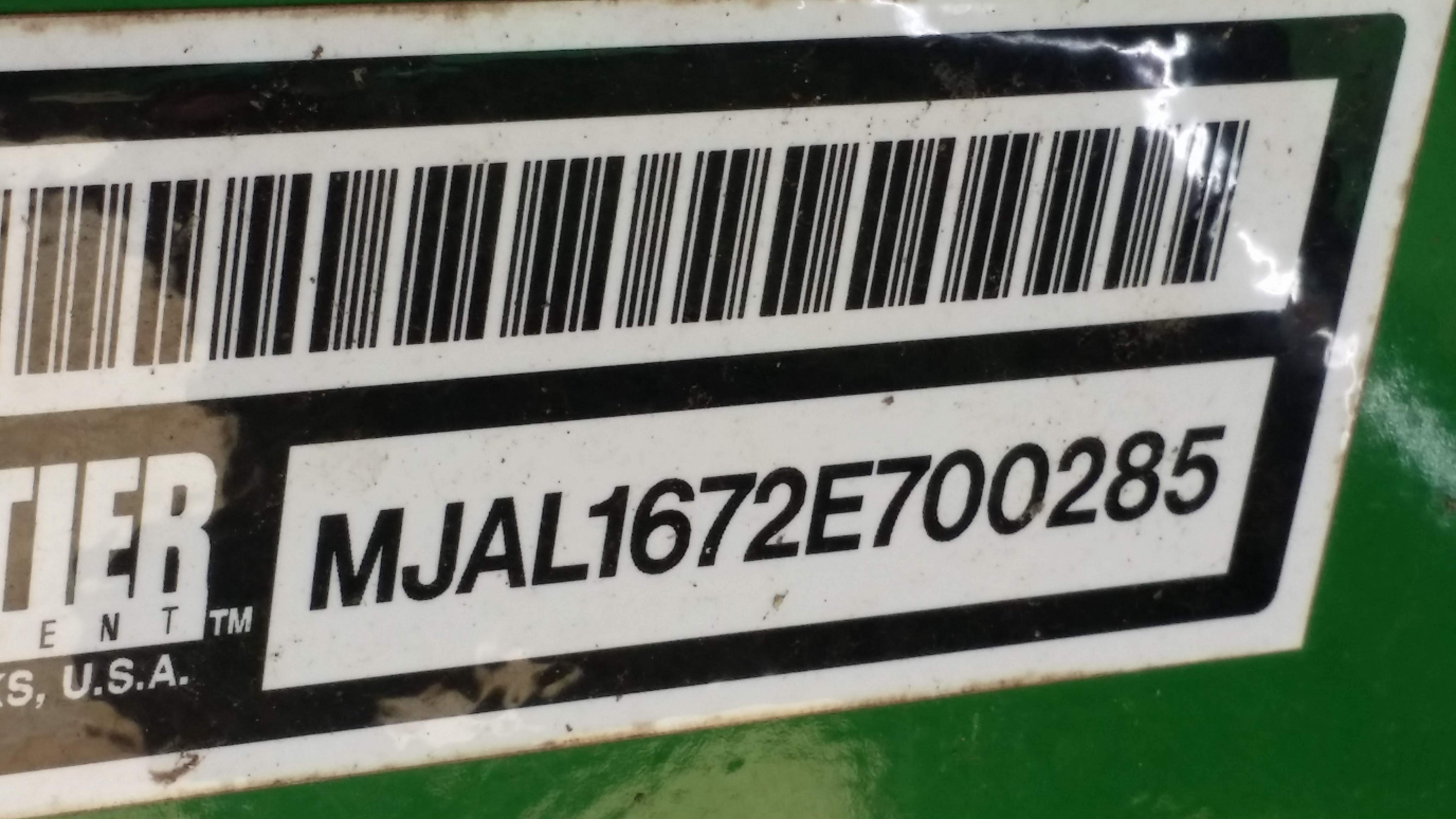

Its a model MJAL1672E700xxx by the sticker on the blade. I was told its a model AL1672E.
Breaking down the number, what does the MJ stand for? Maybe where it was made? I take it the 7 is the year of manufacture (2007? I was told its about 6 or 7 years old) and the last five digits are the sequential serial number of this particular piece of equipment.

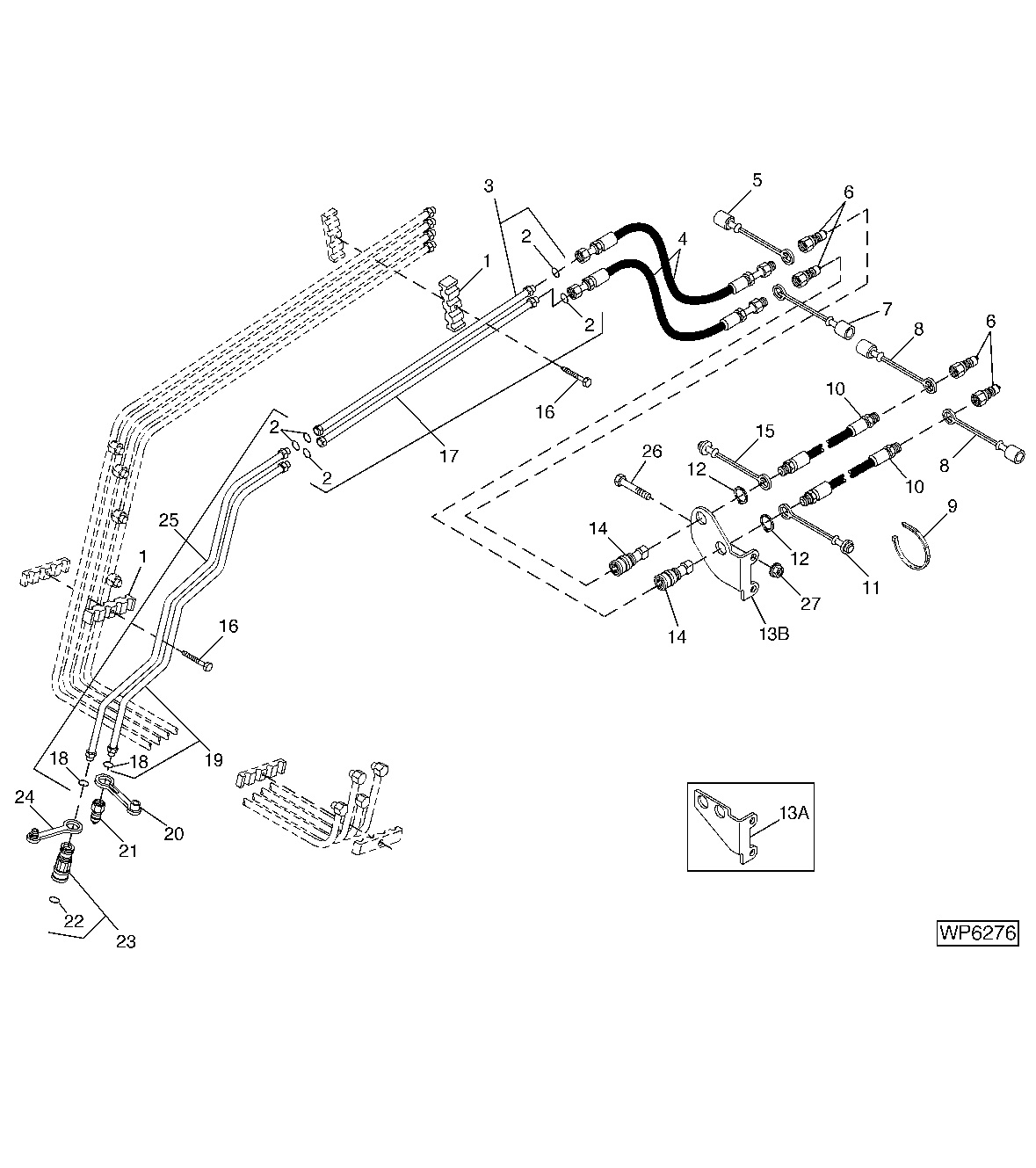

My 4410 has the model 430 loader and already has the rear remotes/third SCV installed.
Is this the point that the power angle kit for front blade would normally be powered from?
If I get a hydraulic top link(which I want to do soon) which would use the currently installed 3rd SCV, and I have a BB mounted on the rear in the winter then how can I use this for the angle on the front blade? Sounds like the diverter kit is needed or a 4th SCV.
Ideally I'd like to have something with a quick disconnect near the loader disconnects to make dropping and reconnecting the loader easy.
Can you post a picture please?
Yes, using JD parts anyway-they never offered a 4th for your machine. They did have a kit for the 430 loader to extend the rear 3rd SCV to the front, it included hardlines up the loader arms, and hoses to go from the mid point to the rear. they are getting hard to find now.
WR Long sells a kit to add a electrically controlled circuit, often called a "third function" Valve Kits
You could use a diverter to "split" you one remote into two, or put your fixed TL on in the wintertime.
Yes, that's normal to do that. Remember if you run long hoses, you only need to use 1/4" ones since the plow needs so very little fluid to operate.

would you happen to know the part number for that kit with the hardlines?
It really would not be too hard ot bend up some hard lines myself I think,
I bent hundreds of feet of 1/4, 3/8, and 1/2" SS and copper tubing over
the years piping up instrument panels loaded with pneumatic instruments
before the electronic stuff took over.
/ Quick attach snow blade for 4410 #8
The kit is #BW14715 but they seem to be NLA anymore. Remember this series machine is over 10 years old so these kits are getting harder to find.
