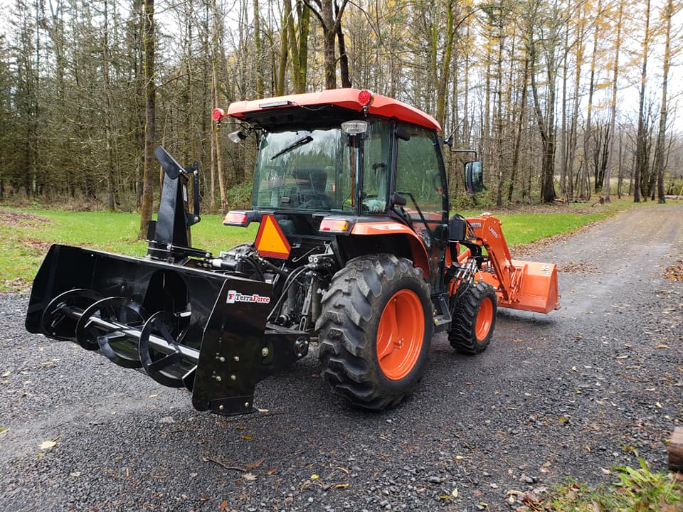

Quick attach is offering a end of the year sale and I was wondering if there were any owners of either their rear push or front pull snowblowers. I do not know a lot about their equipment so any one that has some of their attachments some info would be great.

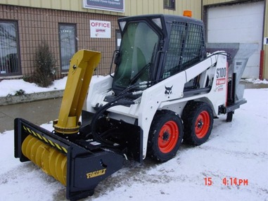

The old Reist design from 2012 has a shaft and collar at the right angle gear box stub shaft end and at the end of the shaft it has a keyed sprocket.
In that years manual the hydraulic drive set up has a lovejoy coupler.
The rubber torsion arm is an improvement on the old design which used a retainer plate to hold the large sprocket in place that held the chain under tension.
I will upload the old manual when I have a few extra minutes
The two images I uploaded are of a Riest series 1000 hydraulic drive single stage snow thrower with the 13 inch diameter snow thrower rotor.
You can see the access door for inspecting and or repairing the chain drive in the second image.
The 2 sprockets are also easily accessed by opening the access door.
The driven sprocket is secured with a locking compression ring.

Does anyone know about Quick Attach's rear pull, or rear push 72 inch snowblower? They are having a year end sale and I was just curious. I have heard about Meteor but I know nothing about them. Everything attachments stuff has been awesome I have no complaints. I'm looking for advise from snowblower owners.

Did you read any of he material I posted earlier? The Meteor snow blowers are made in Canada by MK Martin and are of very high quality build, The rear pull snow blowers take lot of horse power to run where the meteor single stage rear mounts require much less power to clear snow.

Buying a single stage model 1048 meteor rear mount with the built in wings will be more than enough snow thrower for your needs as long as you keep the throttle up, you do not need a pull behind.
The issue for you is going to be whether you will be better able to use a rear pull as:
1. YOU need room to work
2. They are more expensive in a 2 stage unit versus a meteor single stage pull behind unit
3. If you are buried by a deep snow storm they will be useless. UNLESS YOU go out every two hours during a major snow event/storm.
4. if you do not have chains and or ballasted tires your going to have to go out much more often and overnight heavy snow fall will limit your ability to clear it if you are not out there every couple of hours.
Its best to just let the snow drop and then clear it.
Using a single stage is less work and requires less power as you are not using an impeller.
I am not trying to spend your money.
The rear mount single stage will cost you much less money to own and operate and save fuel and be more efficient at taking full and half cuts as there is no spillage.
