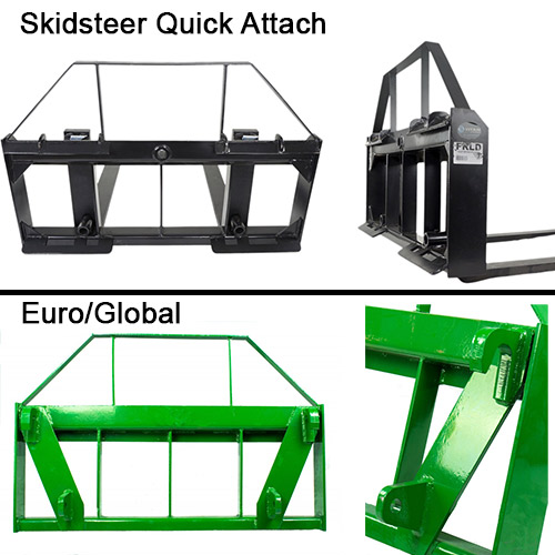

The universal skid steer style quick attach will generally have two spring loaded levers at the top center of your loader arms. When you pushed these levers down, they will engage two pins vertically at the bottom. With the euro global style, you will only have a spring loaded lever on one side of the loader arms, not the top. This lever will engage pins horizontally, left to right, to secure the attachment. I have attached pictures of the back of two of our pallet fork frames. The skid steer quick attach system would be the best option as it is very quick and easy to connect. You will also find very competitive pricing on any SSQA implement. skidsteer-euroglobal.jpg

The universal skid steer style quick attach will generally have two spring loaded levers at the top center of your loader arms. When you pushed these levers down, they will engage two pins vertically at the bottom. With the euro global style, you will only have a spring loaded lever on one side of the loader arms, not the top. This lever will engage pins horizontally, left to right, to secure the attachment. I have attached pictures of the back of two of our pallet fork frames. The skid steer quick attach system would be the best option as it is very quick and easy to connect. You will also find very competitive pricing on any SSQA implement. View attachment 497912
