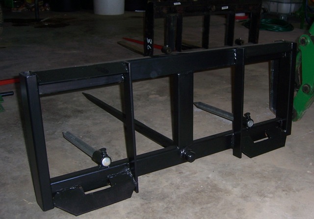

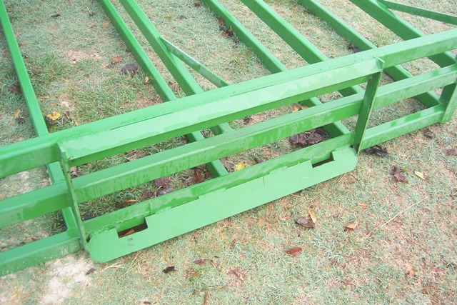

If its on the blower just make your own ...here's a shot of a couple that I have made.
