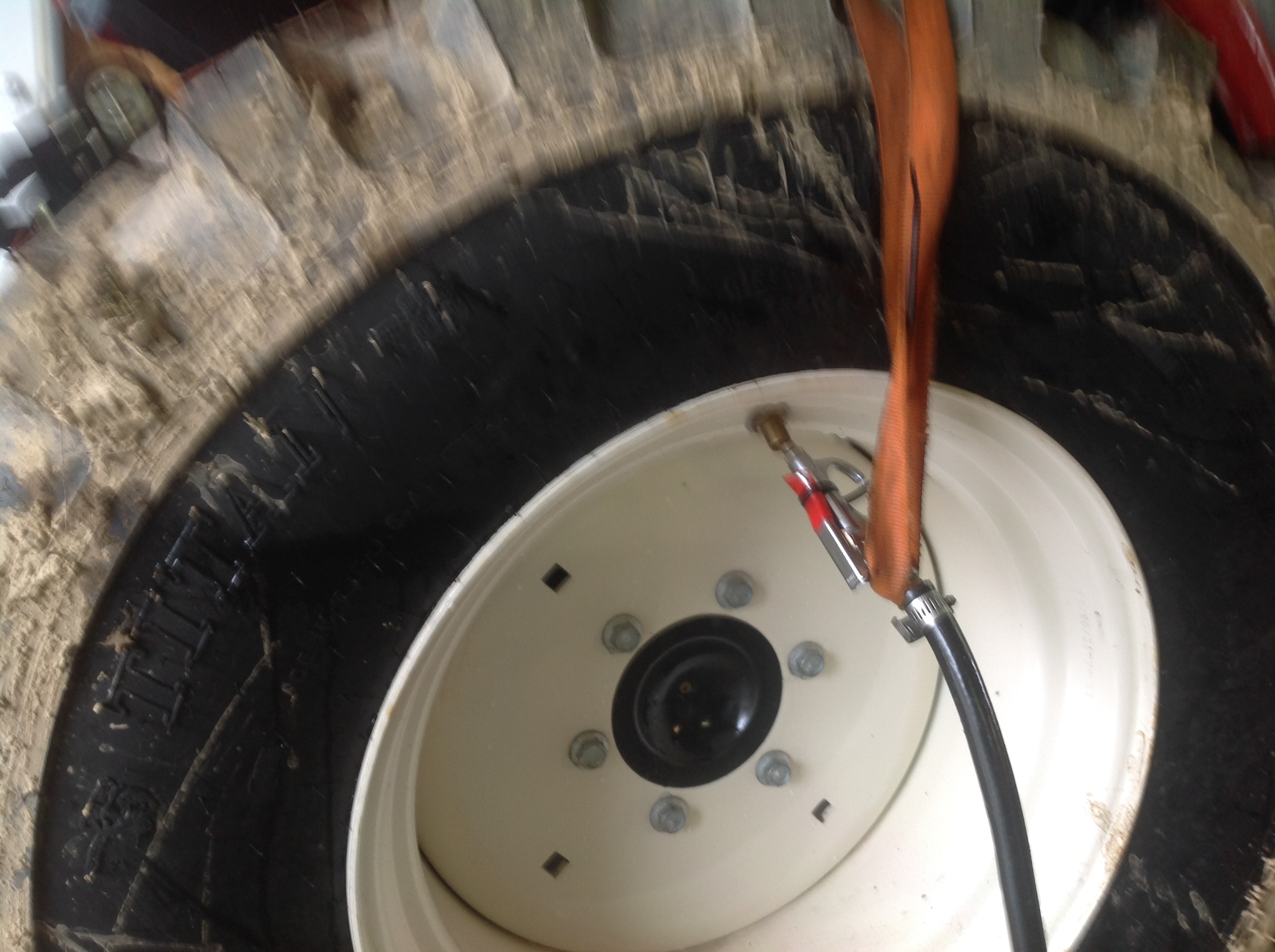

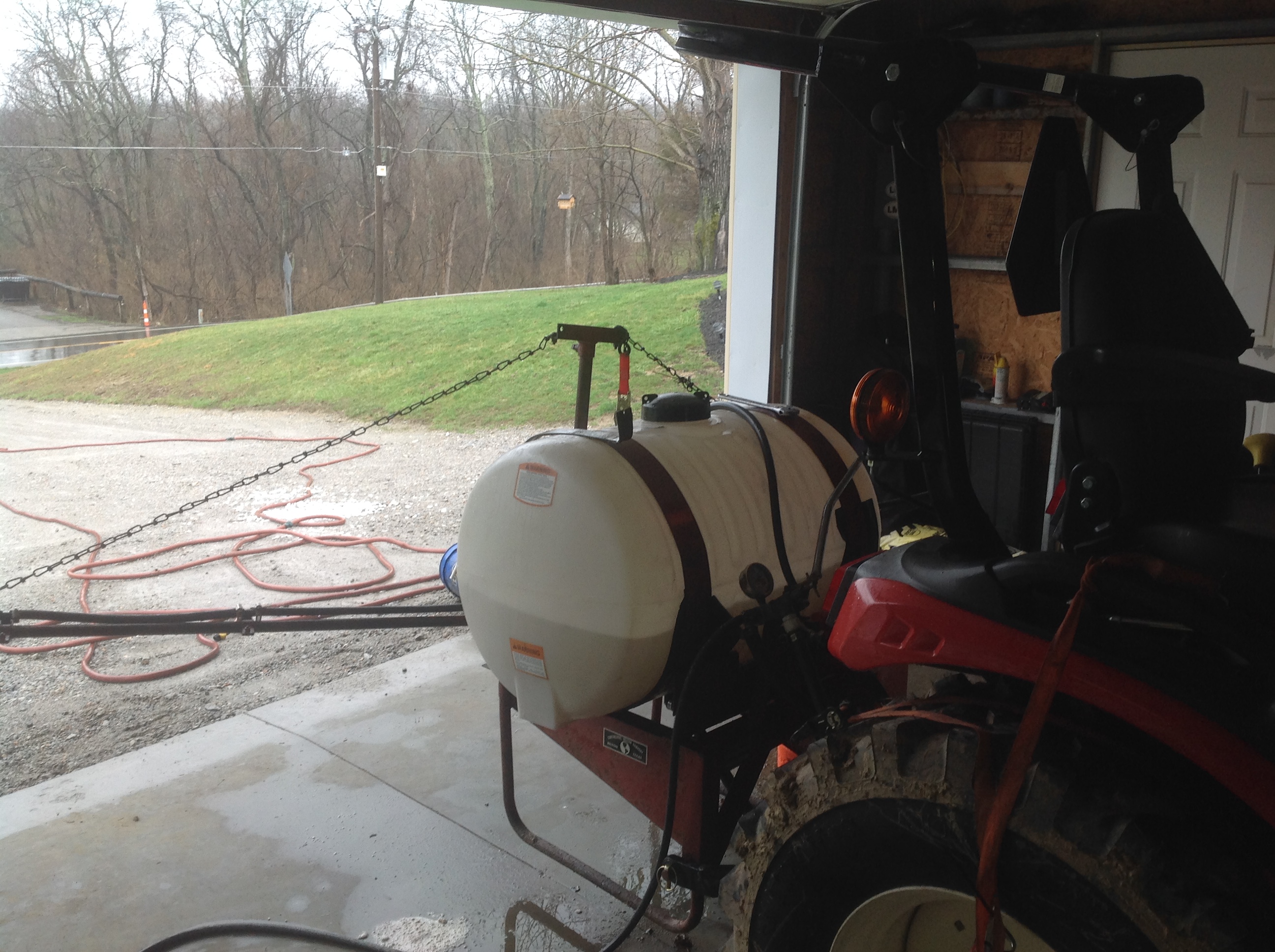

I thought i would share my calcium ballast fill on my new tractor. I have a 55 gallon pto powered spray tank. Filled it with water and 200 pounds of calcium ice melt. I had to take my time adding the calcium due to the heat and keeping the lines from plugging. I replaced the wand with a blow off nozzle with the aluminum top drilled out to ~1/8". Worked well and was inexpensive. image.jpegimage.jpeg

Nice innovation!!!! :)
Make sure you clean everything very well, especially your sprayer pump, etc. Calcium is extremely corrosive!!!!!
You gain some weight with calcium, 10lbs p/gallon versus 8lbs p/gallon with windshield washer fluid for example. But the offset of corrosion makes up for it. Your valve stem cores are not going to like this at all. They will start seeping which will start corroding your rims. Be diligent about controlling any leak you spot and keep the rims clean. Good luck.

I have done a similar thing using one of those paint spray tanks that look like a big pressure cooker and an air compressor to force the liquid through a small metal pipette. I note you are doing this with tires mounted and vertical. With calcium chloride you need to be sure the liquid level is high enough so that ALL metal inside is ALWAYS submerged, that is the liquid has to a good bit above the Schrader valve so that the inner rim is always submerged. If not, your rim will be doomed to early rust-out. My last ballasting used winter grade windshield fluid and the rim maker had been kind enough to put two shcraders on the rim 180 degrees opposed. Easy-peasy!

It takes oxygen to rust a wheel. Calcium Chloride is not enough.
It helps though, if you give the tire a shot of air from time to time.
Leaks, especially around valve stems are the real trouble.

Well done Tony! Don't stress about the CaCl just deal with any leaks.
