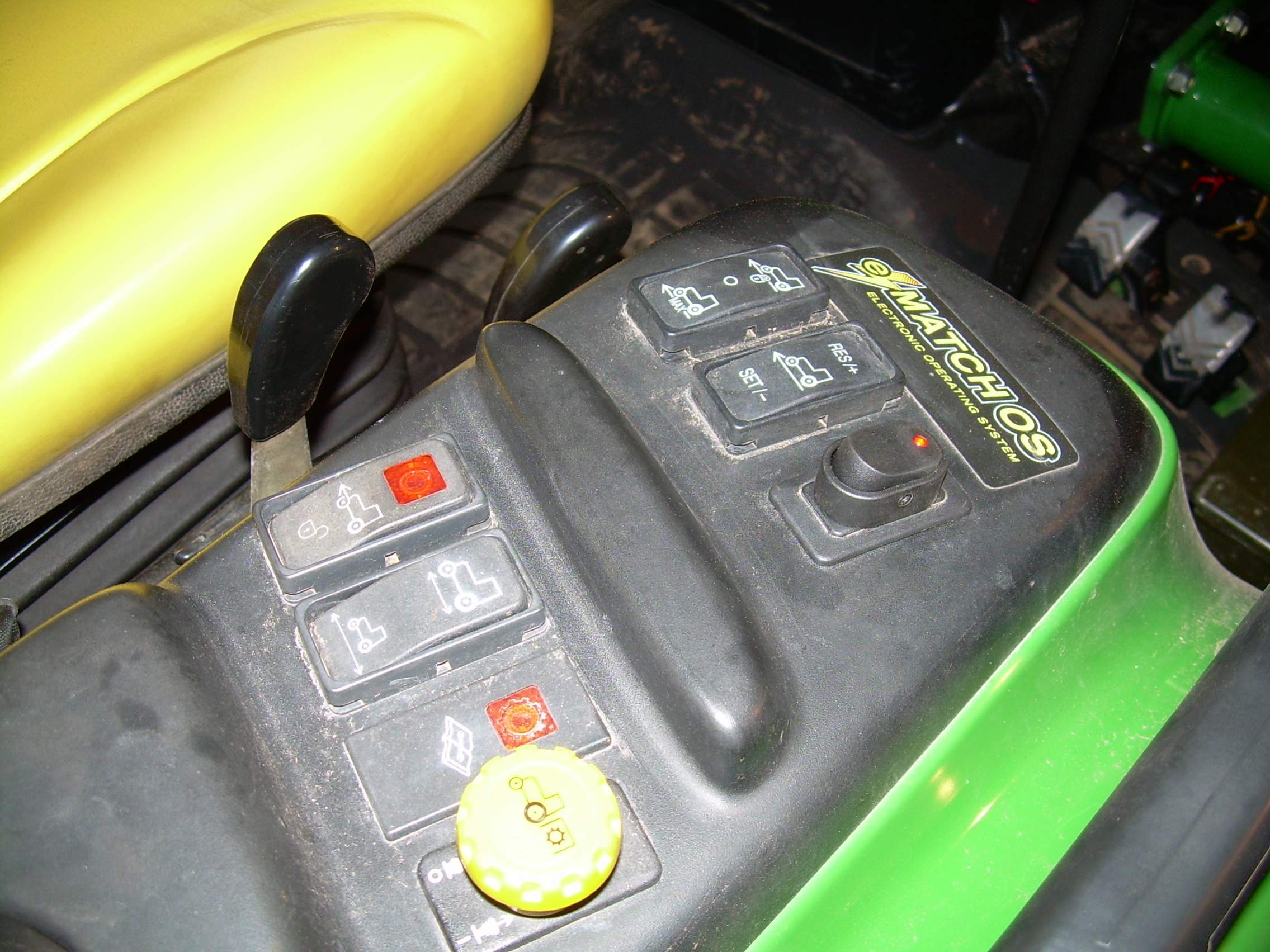

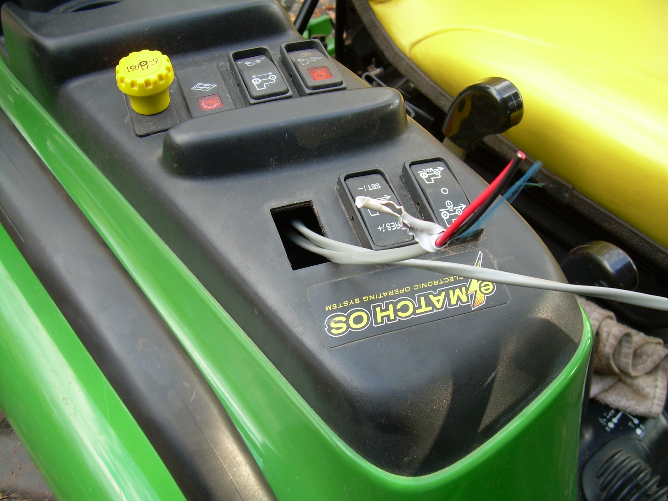

Anyway I finished up this simple install. Just upped the fuse to 15 amp put a switch on the panel on rt fender in a blank spot, bought a lit rocker switch for $6. at auto zone. JD wanted $45. for a switch to fit that slot.
Ran some 14ga wire, well this is kinda the hokey part, seems auto wire doesn't come in a cable like house wire 14-2 etc. and since I needed power and ground to the light as I couldn't trust the ground on the canopy frame mounted to folding rops, I just went to Home Depot and got some 14-2 stranded wire it's in a decent plastic sheath.
I know there's probably a few reasons why this is wrong but seemed easy at the time.
This circuit is hot to the switch and to an accessory outlet all the time, so I am concerned about a short with the wire running under the machine and over the rear end. I may put a cut off switch on the dash to kill that circuit when not needed.
That what I do. I think it is safer than single wire due to double insulation that is also thicker.
