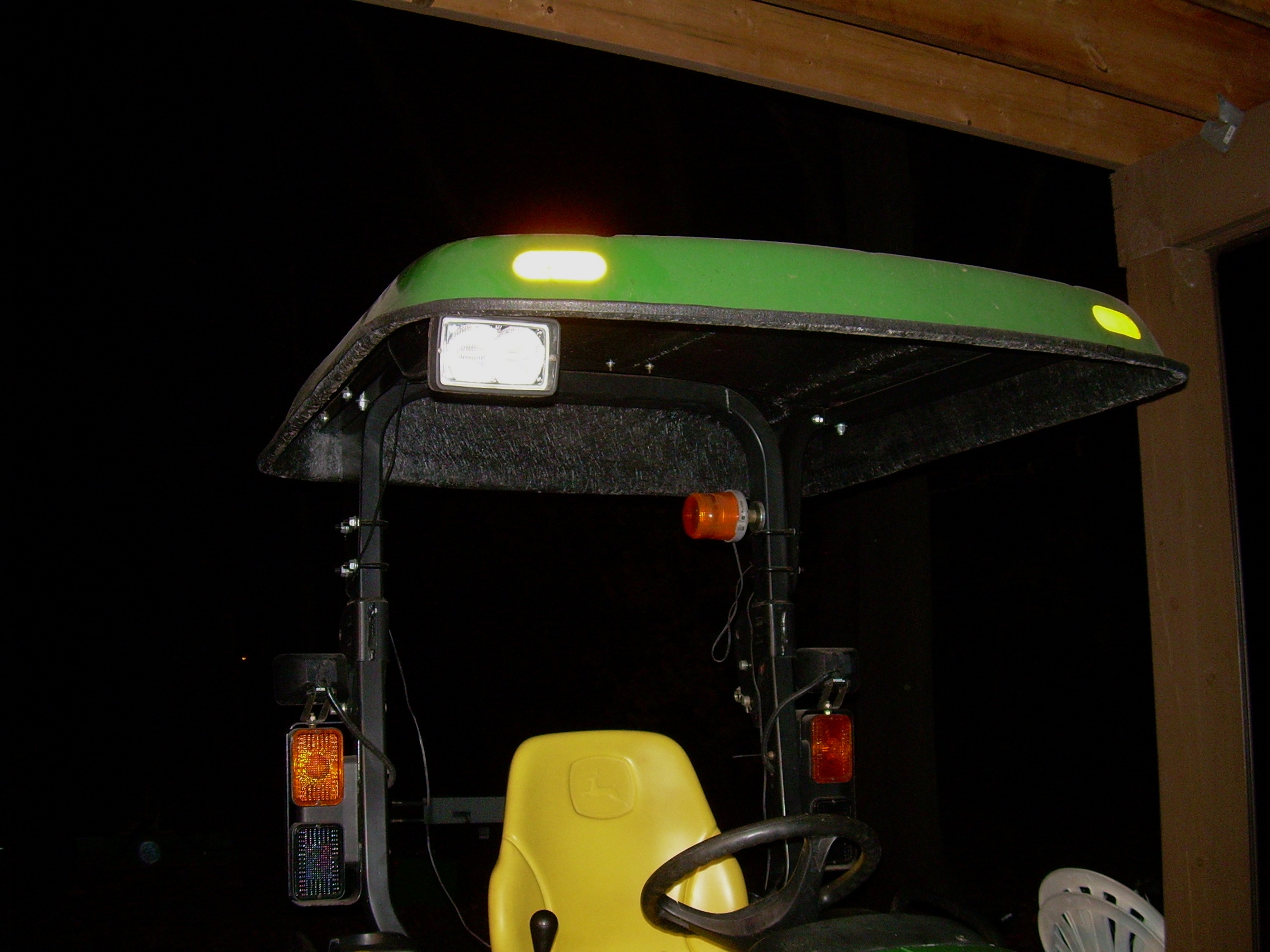

I found 2 aux 12 volt truck lights in a dumpster, they don't look like much from the outside, just a plastic housing, but inside they looked pretty nice with twin bulb assemblies in a ceramic inner housing.
Water got in there and messed up the connectors. Fixed that and want to (did) mount one to my canopy to help with night vision when snow plow is raised and blocks headlights.
They are twin 55 watt bulbs, beautiful bright wide pattern way better than the front or rear lights that came with the machine.
Question is how many amp fuse do I need for them?
I figured 110 watts divided by 12 volts comes to 9.2 amps.
I've got a 10 amp circuit available, but it was close enough I figured I better ask.
Is this formula correct? I think it's Ohm's law but not sure if it works the same for dc as ac.
Thanks, JB.

Your formula is correct. Also given that you're probably running at higher than 12V, you'd be at a lower amperage yet. If you really want to know, you can hook up an amp meter to a single light and see what its "actual" draw will be.

Way back in my my college years, I remember an electrical engineer telling me that a circuit should be sized for about twice the expected current draw.
If you expect 8-9 amps draw, you should size wires and fuse for 20 A.
This has worked well for me for 45 years.

You are leaving out one very important component of Ohm's Law - resistance. Let's just say for easy numbers you have a 60 watt bulb (rated 60 watts at 12 volts) The bulb would draw 5 amps AT 12 volts. It's resistance would equal the voltage divided by the current (12/5) or 2.4 ohms. For our discussion lets say that doesn't change (it doesn't change much). At 14 volts the current draw would be 14/2.4 or 5.83 amps. The wattage of the bulb would then be 14*5.83 or 81.6 watts.
In reality I believe auto bulbs are rated (wattage) at 13.6 volts. The formulas don't change just the numbers.

See if this link opens for you. It is pretty handy. I would go with a 12-15 amp fuse for your lights. You have a bit of a current surge when you first turn them on. Or use a slow blow fuse. It is always safer not to max out your wiring capacity. If your wire is warm at all to the touch then you are going to have problems.

But thanks for the help, looks like I'll be all set with a 10 -15 amp fuse and 16-18 gauge wire.
I'm using a blank spot (F4) on my fuse block that says "never used" it's on the top row where all the others are 30 amp, I put one of those little piggy back fuse things in there to make it simple to wire a cigarette lighter type outlet, allows you to have 2 circuits in one slot but since it was an unused slot I just have 1 fuse in there now (normally would have 2 if you were sharing the slot) got a 10 amp in there now, this circuit is always hot regardless of key position.

Current carying capacity is one thing but mechanical strenght is another. There is no point to use the smallest wire that would take the load. Use wire that will take the abuse and last.

Both bulbs will draw 9.166 amps, and you should double the wire gage. Running the bulbs at 14 v, the bulbs will be brighter, because the resistance is the same. The bulbs will give longer service at 12 v.
Add a switch for each light, and only use what is necessary.

something you may not have thought of - whats your alternator sized at? If you are pulling more amps than the engine is putting out, you can get it from the battery for a while, then you'll have issues...
/ Quick easy electrical question #19
There's another thing you might want to consider when choosing wire size and that's the difference in voltage drop you will experience between two different gauges of wire. While 18 gauge might be adequate for the application, 14 gauge will have much less voltage drop and you will have higher voltage at the lights themselves, and more light as a result. For example, with the same load and distance, 18 gauge might gave a 10.97% voltage drop whereas 14 gauge would give a 4.33% voltage drop. Since it's literally pennies more per foot for 14 gauge, why not go for the heavier gauge? As for the fuse size..is there nothing else on that 10 amp circuit already? If not you might get by with a 10 amp fuse and you could probably increase it without undue risk to a 12 amp if the 10 blows. No doubt the factory would say never ever oversize the fuse and if you do, you do so at your own risk. Myself... I wouldn't hesitate to increase the fuse size to just enough to not blow when using them. Live dangerously! :D
