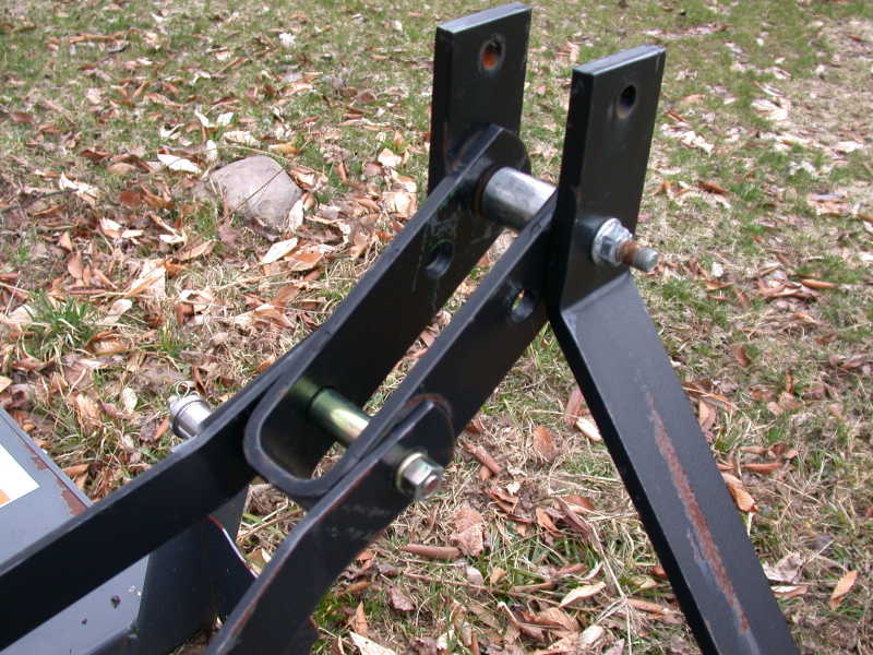

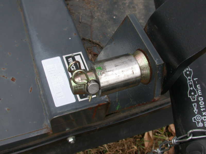

/ Quick Hitch Bushing #8
You can go to TSC and buy bushing. I made my own but they sell bushings that will work. Use pins or clips to hold them on for temp use.
Here's my set up on the Woods HC60 I just posted on another thread here.
Rob
