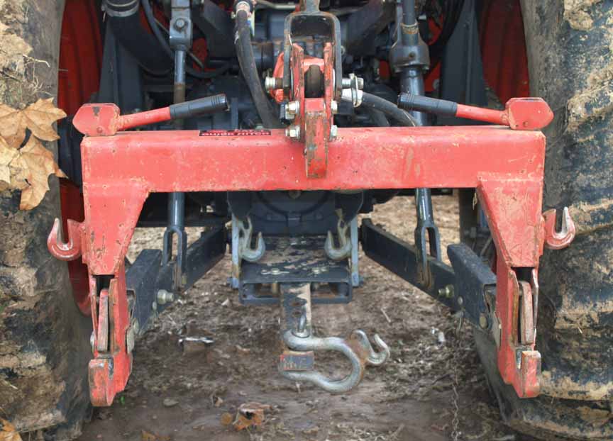

I also have a QH I picked up at TSC (Speeco) - I just finished modifying the top link on my snowblower day before yesterday to make it work with it. Basically trimmed off the old toplink ears and welded a new pair to raise the toplink pin height. I bought the snowblower used, have not used it yet ..... dunno whether the PTO shaft will be long enough or not.
The QH fits my KK tiller, but again I need to check the PTO shaft length.
I also use it with my Woods boxblade - although I have to set the front edge of the boxblade on something when I remove it (I use a landscape timber) in order to keep the lower link pins from being too low for the QH to pick up. The boxblade came with an open hole for a toplink pin and then just below that another pair of holes that had a bolt run thru it and a bushing on it that fit the toplink hook on the Speeco. I just moved that bolt/bushing up into the top holes.
I still have to modify the landscape rake and woodsplitter .... not sure about the KK carryall.
For me, one of the most frustrating things about using a tractor is attaching and removing 3PH equipment. The QH makes it 100% easier .... and I'm sure it will only get better once I'm doing it on level concrete. /forums/images/graemlins/grin.gif

I have a Speeco and a John Deere I-Match. Wish I had started with I-Match. I trust JD to follow the spec exactly, not partly as Speeco has done. An adjustable top hook makes it such that you can make it not to spec.
Do you want to weld and adjust all your implements to a non-standard specifications? That defeats the purpose of a standard. What if each manufacturer of electrical plugs made their spacing and prong dimensions a little different?
The quick hitch business is in infancy. The best thing we can do is only buy implements and hitches that fit the standard exactly. I'd make it a condition of sale, and if it don't work, return it.
Good luck. My hitch is one of my first and best additions to my tractor. They should be included with every new tractor.

I have a BEFCO QH. It works with my BEFCO LR, BEFCO RB, and a BEFCO RFM. The top hook is not adjustable. It's big and seems to be for something larger than CAT I, but I really have no idea. I think it'll accomodate a 26" drawbar. I use bushings as needed. List was around $330. Oh yeah, it's orange.
Knowing nothing about implements and QHs, I was told that this would be compatible with many implement brands. Landpride and a few other brands were mentioned. I think I was told that the SPEECO QH and KK implements are compatible.
   / Quick hitch confusion #15
What is the tractor it is on? Is that tractor a Cat I 3pt ?
If for Cat I tractor 3pt, then the QH top hook is the size of Cat II and the bottom hooks are Cat III. Bushing kits are used to add to the attachments for match-up.

I found that coming up from below was my biggest challenge. Not all of my implements have clearance for that big hook to come up from below so I installed a hydraulic toplink and retract it, bring the QH up to engage the lower links then extend the toplink get off to pin it. This doesn't allow me to hook up completely from the seat but my motive for the QH was primarily to line up the lower links. I hate having to get back on and pull up an inch ect...

I've got to tell you that despite all the help in this thread my quick hitch confusion is not resolved.
Here is what I think I have learned. Help me correct this if I am wrong.
- I want a quick hitch with an adjustible top link as the top pin on implements tends to be the most common thing that does not comply with the standard.
- A quick hitch will likely nicely compensate for lack of telescoping links but may not ensure (given the top link issue) that I can hook up my implements without getting off the tractor - I can live with this. I'm primarily looking for something that will save me time - does not necessarily need to eliminate hookup time.
-I definately ought to get a QH that has a floating top link for something like a rotary cutter. I know that the land pride one has this. Are there others that do?
- I haven't heard anyone mention that one quick hitch is better than the other (assuming the ones I compare have adjustible top links). There was some preference for the JD iMATCH but that does not have an adjustible top link. Any preferences?
In a nutshell, sounds like a QH will generally save me implement hookup time without implement modification. However, implement modification may be required if I don't want to have to adjust the top link from implement to implement.
