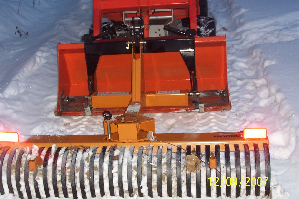

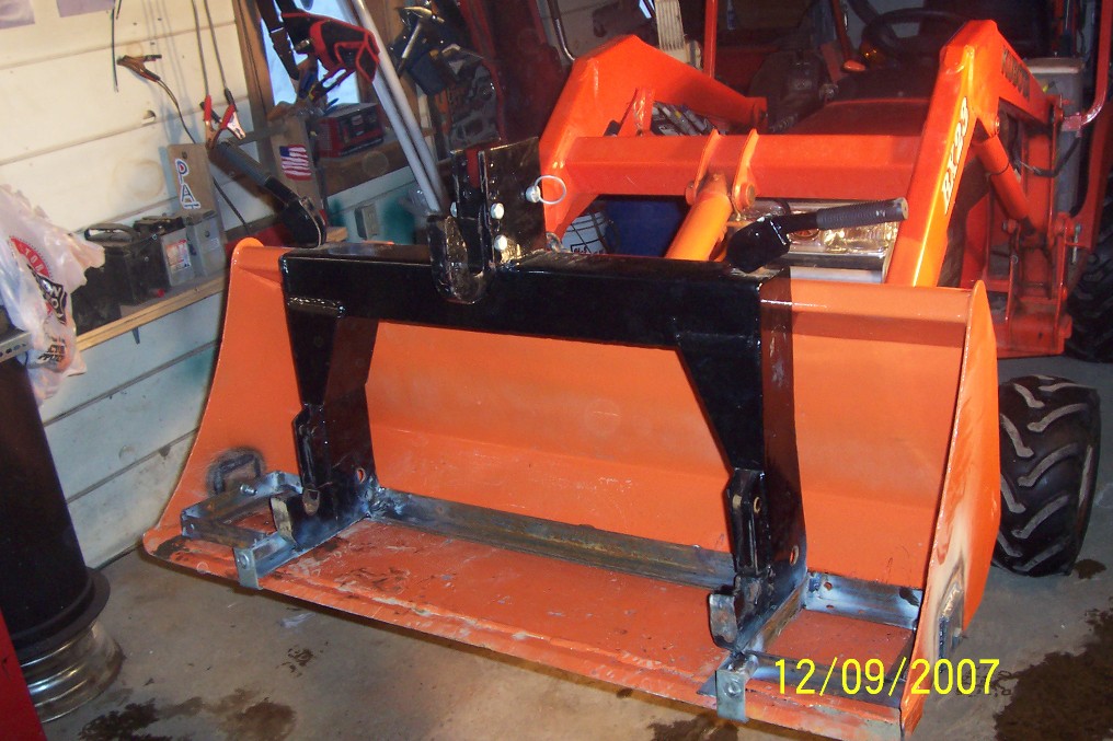

Hi guys,

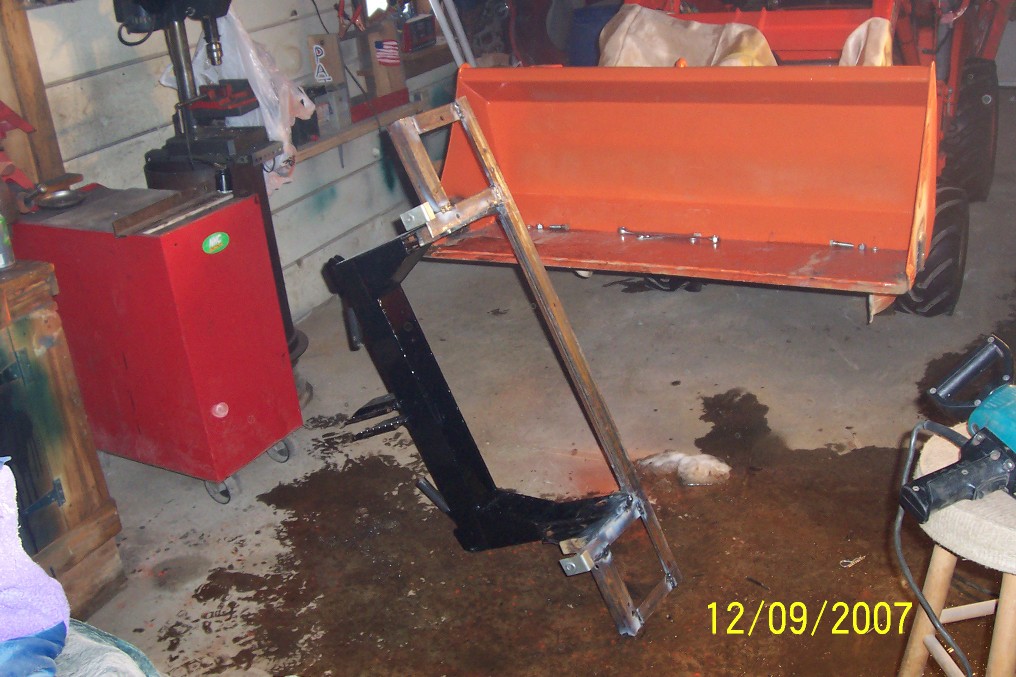

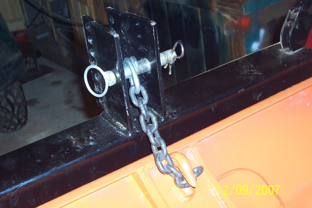

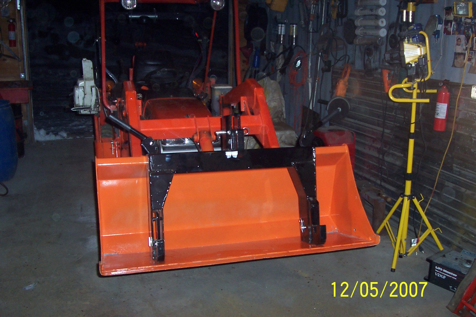

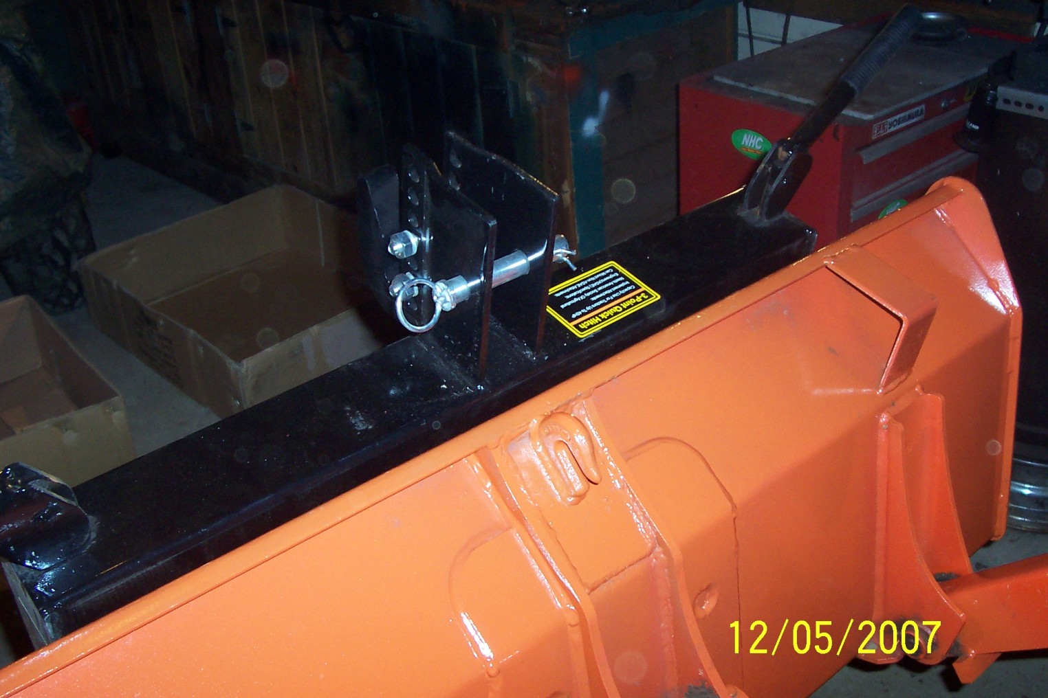

I played in the garage today and fabbed it up ,i think its a great success.I took a long time to decide on if i wanted it spting loaded ,i finally chose a solid mount.Ipin in the top[with chain] 2 bolts on side to install[might change that to pins also]about 2 minutes.

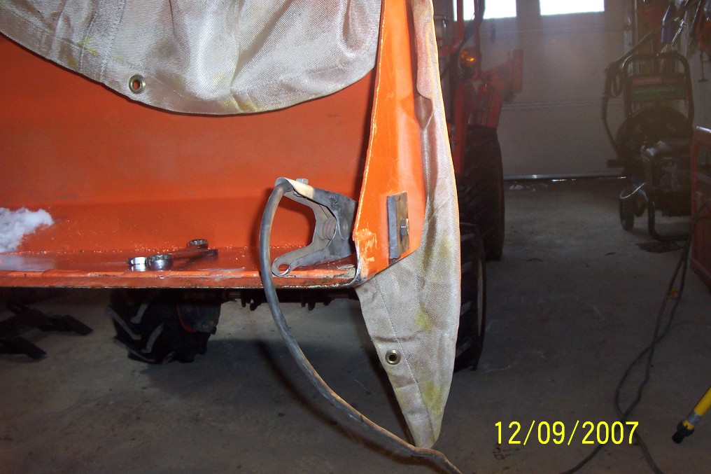

Iwelded the original loader attach pins to the angle frame i built to have something over the cutting edge to keep strain off the frame and side bolts.Iwelded the MARKHAM plates to the side of my bucket so the holes dont get messed up.Main frame in the rear is double angle iron for extra support.

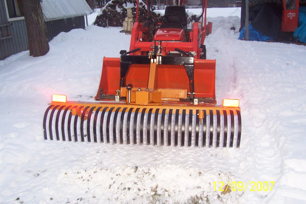

Works slick.Isnt too heavy ,acts real solid.can actually see well where that its out in front of bucket.Drove right up to rake picked it up jumped off and flipped latches-SWEET:)
Sorry guys i didnt have a plow to try,so i hooked up my rake which is about the same if not heavier than a plow.Ishowed my neighbor [who has several tractors]and he thinks it will plow great.Ill wait to hear your final suggestions before i paint
Now I gotta go buy a 3 point blade.Tryed FRIDAY ,two of the largest dealers around are sold out!!
ALAN
PS ALREADY DREAMING OF THE DIFFERENT IMPEMENTS THAT WILL WORK WELL UP FRONT:D

Looks nice. For things I dream of using, I would need a clear 3pt - the bucket edge would be in the way of too many implements. Looks like it works your needs well.
I would be careful with that top chain just hooked in. There will be a lot of torq & bendy forces at times when pushing/pulling a blade, & even pinning the chain in 'tight' things could flex enough to let the chain slip out of the hook & then your implement could teeter down into the front of your tractor - or fold under while you are driving forward.
Maybe not likely, but real bad ramifications if it would, however unlikely, happen.
--->Paul

PAUL,
Iwas thinking the same thought,however didnt have the correct one yesterday.Thinking on looping it around and putting a bolt through it,hooking it to itself
ALAN
