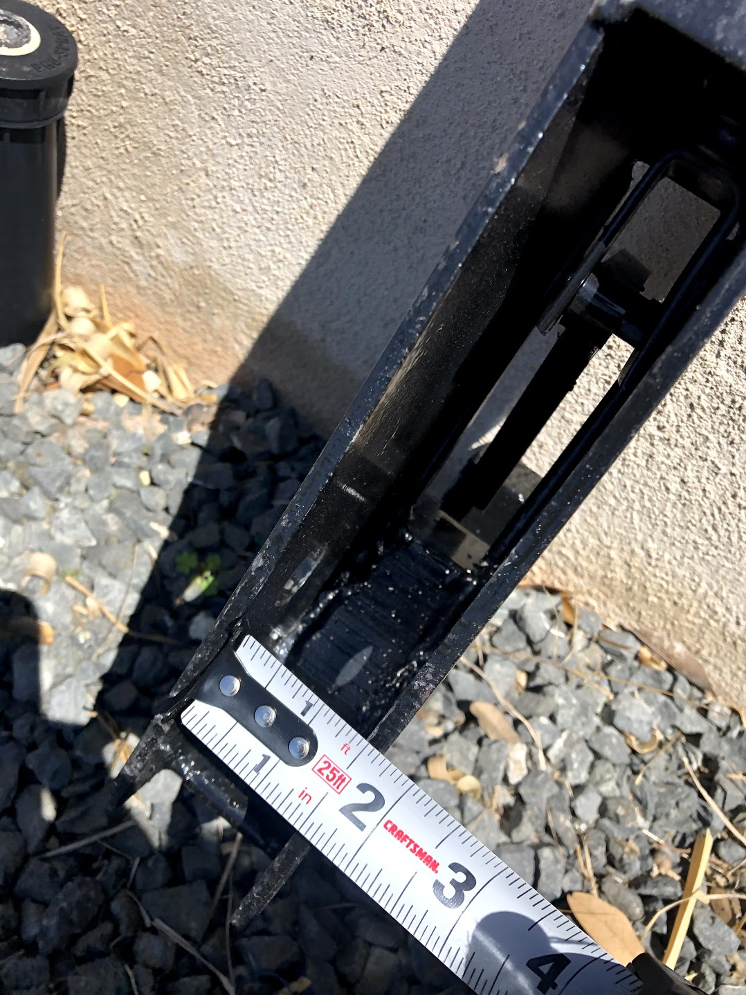

I recently ordered a quick hitch from Agri supply online. When ordering, I had two options a Cat 1 that had a width of 301/4", vs a Cat2 With 37" width. All of my implements are Cat1 and the widths fall right around the 30" mark. So I ordered the Cat1.
The hitch arrived today and unfortunately the ball of the lift arms will not fit in the slot on the back of the quick hitch. The slot is about 1/4" too narrow. Looking over the specs on the Cat2 quick hitch it most likely would not have this problem but the hitch would be too wide for my tractor and implements.
So trying to figure out a way to rig this up. I see two potential options. 1. Buy two bolt on lift arm pins, drill the holes larger in the quick hitch and bolt them on attaching the lift arms to the outside of the quick hitch. 2. Find longer roll pins and use these to attache the lift arms on the outside of the quick hitch.
I'm assuming option 1 will work, thinking option two there may be two much play side to side with the roll pins shifting.
Anyone else run into issues similar to this or have other ideas how to retrofit.

That Cat 1 width is too much. The distance out to where the pins go into the lift pin ends are about 27 or 28 and some inches.

I have seen people grind down the balls so they will fit. Not sure if you want to go this route or not but it will get the job done.

Sounds like your 3 point hitch is a Cat 2 and the lower link swivelly balls won't fit on the QH slot, yes?

According to TD, the LS MT352 has a Cat I 3ph. TractorData.com LS MT352 tractor information
I *assume* this is the tractor the OP has per his posted info.
Its actually a Cat2 Hitch per spec from my owners manual, but not a real cat2 hitch as I am learning. The balls are cat2, but the width and height of the top link are all cat1 specs. I can't use a cat2 quick hitch as all my implements are cat1. I'm going to try mounting some lift arm pins on the quick hitch and see if that works.
