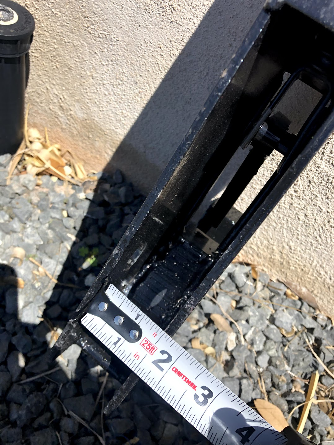

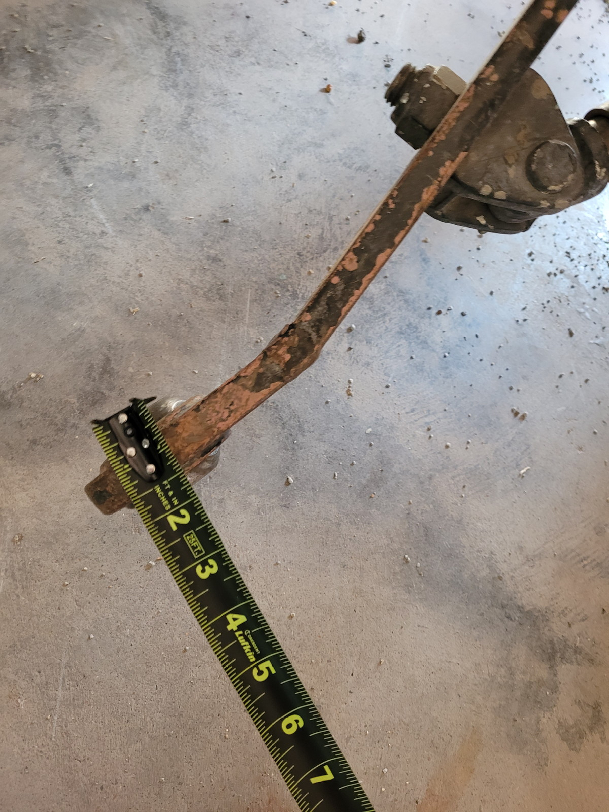

i am surprised that the Pat's fixed the problem with the oversized arm balls. I have a Mahindra and the ball they use rolls around in the arm so it can be used for cat1 and cat2. That makes the balls around 1.75" wide. (see attached photo)
I know the harbor freight QA wouldn't fit and I didn't think the Pats would either. I hope someone tells me I am wrong because I really would like to find a set of QA that would work.
How hard is that steel used on those balls in case I have to grind them down. Anyone with real world experience with this?
Thanks,
Alan
