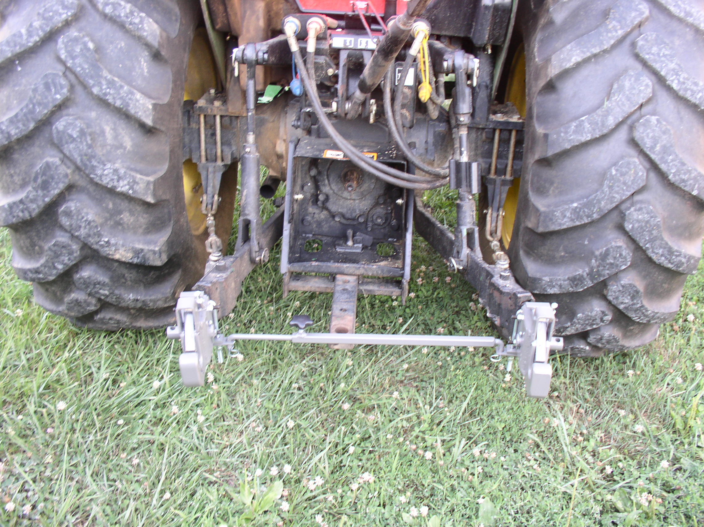

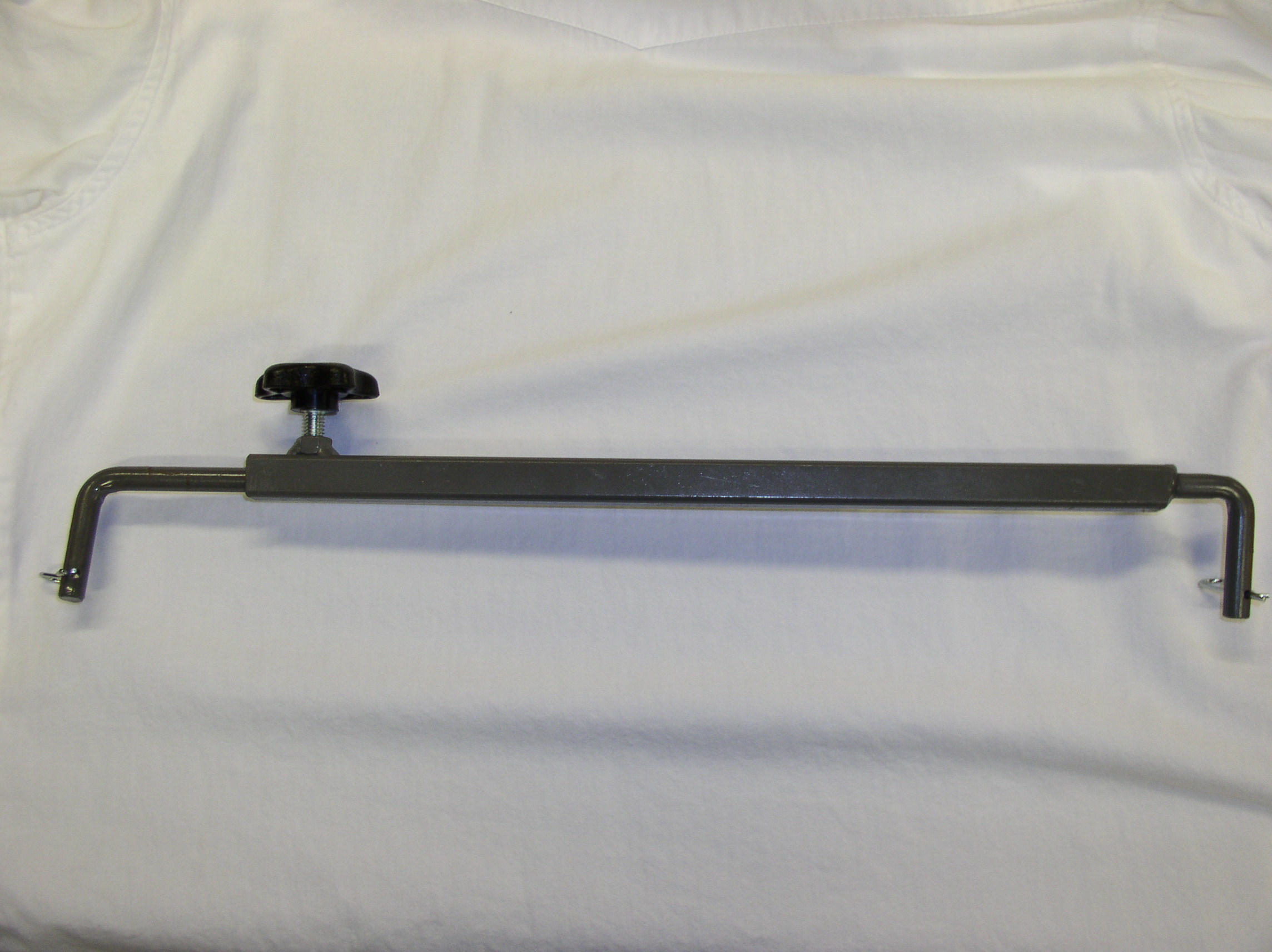

Yes, the stabilizer bar is adustable and only $20.00 plus $10.00 shipping.

Check outthe little clamp on the cheap box spring frames. Its used to hold 2 pieces of angle together andlet them slide to the point you want and tighten a thumb nut to clamp. All you need is one of those clamps and 2 pieces the correct size angle with vertical bolt on end of each.
larry
I bought a 3/8 turn buckle at hardware store, open the left hand thread hook, take out the right hand thread hook and replace with a piece of allthread with 'L' bend on end and cut to necessary length. Time 5 mins, cost <$5.00.
Takes only a few turns ,if needed to change from the narrowest to widest hitch.
UNUSED FUTURE FT-180H HYD ROTARY TILLER (A52706)
