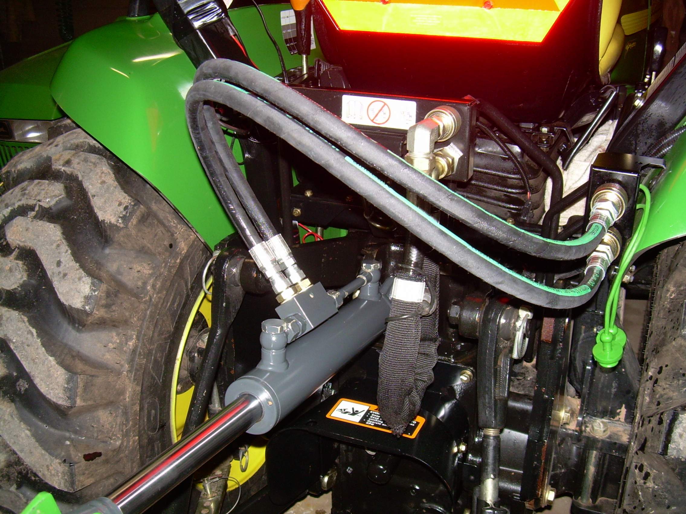

If you have HTL then it don't matter, my 12 year old can couple any implement I have with little effort. even without HTL you just have to be close. side to side don't matter, but you might have to move top link in or out if implement shifted down or back.
I have never had to get off the seat for non pto implement changes.
HTL and QH go together like copy and paste.
It's one of those things, you will never go back to being without if you try it.
Like going from dial up to cable/DSL.

That's a new one on me, JB...what's "HTL"?
(I know I'll slap my head and say "Duhhhh" when you respond)
   / Quick Hitch worth it? #38
   / Quick Hitch worth it? #39
It was new to me a few years ago, But yeah, Roy you must not hang out in the hydraulic forum much :)
JB
You and Kennyd are right...I don't go to the Hydraulics forum.
Thanks for the responses, Gents!!
Duhhhhhhhhhhhhhhhhhh!!!!!!!!!!
