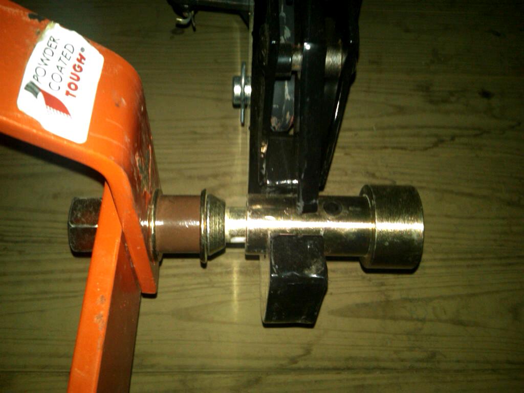

I was beginning to question the purchase of my HF quick hitch I bought a few weeks ago because it wouldn't fit my box blade. I came to find out though that the QH wasn't the problem. The box blade I bought last year is a 4' County Line from TSC and once I looked into it I discovered it was a so-called "Cat 1" box blade but has Cat 0 spacing...so it wouldn't fit the 27-1/2 spacing on the HF QH. In order to make it fit I had to buy "extra-long" (6-1/2") draw pins, add spacers and also add the couplers.
I also can't just drop it down and pull out from it because of the box blades design, but I devised a way to where I now just pull a couple of pins so the top hook swivels and then I can drop it down and pull out. I love it now and the couplers really do make a big difference.
