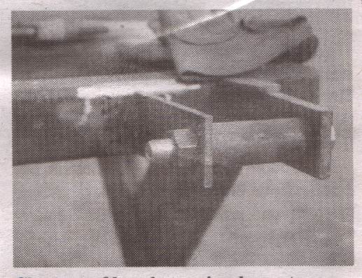

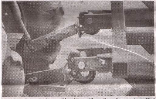

I subscribe to this magazine called Farm Show. They have a lot of great ideas that are born in the shops of some very talented farmers across the country. Here is a picture and description of a quick hitc a guy built using pintle hitches. Looks pretty neat. Similar to Pat's hitch.

Another Pic.

The implement side.
