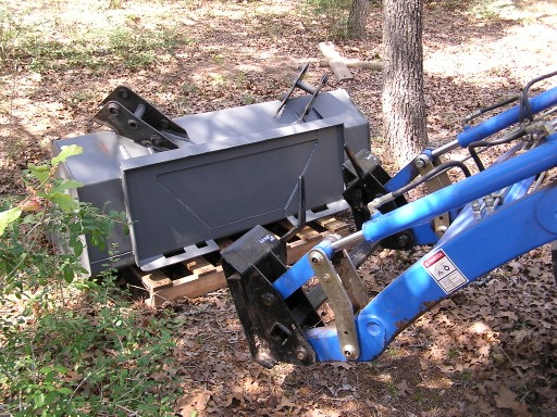

I am going to do the skid steer. I have a New Holland with skid steer and I am guessing they will be the same. That way I can use implements on both tractors.
Here is the question: If I change over to the Great Bend QA loader, will it be interchangable with my New Holland? Here are a few pics of my New Holland QA set up. It has two plates welded on the bucket. I suppose that does not matter as long as the method of attachment is the same, correct?

You just need to be sure that you get a skid steer compatible quick attach. I believe that all the skid steer stuff is the same dimensions. There are other quick attach systems, but they are not skid steer quick attach compatible. Your New Holland is skid steer compatible.

I just did it also, and ordered the UNIVERSAL quicksteer. From what I have been told some manufactures make product specific quick attach, I think to force you to buy their stuff.
Anyway, the Universal I put on matches perfectly with attachments I have purchased on line.
I also got a PLATE to attach to my existing bucket.

here's my conversion - NH pin on bucket with the tabs cutoff (sitting on top) and a plate welded on. I paid about $100 for the plate - ordered online from qualityweldingservice.com. works like a charm. the qa for the tractor side I got from a dealer - it's a universal skid steer type.
