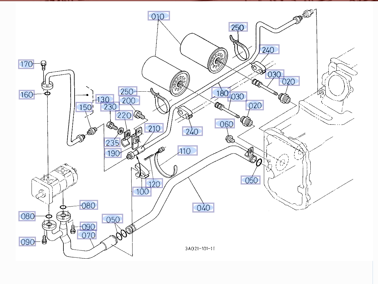

On a 1997 Kubota M5400 with 800 hours.
Curl up/down is slow, lift is slow, lower is normal speed, breakout force seems weak too. No leaks or leakdowns.
Changing fluid/filters didn't help.
I just inherited this very clean tractor and don't know a lot about hydraulics. I presume I should start by looking at the loader valve??? But what do I check?
It's a Quickie 310.

There isn't really anything to look at in a loader valve other than the pressure of the relief setting. With no leaks or leakdowns that pretty much eliminates the loader valve itself
If you really want to diagnose anything with hydraulics - including the relief valve in the loader control valve set, you will need a pressure guage kit. Amazon has them for inexpensive. Needs to read to 5000 psi.
Always good to change fluid and filters. I hope you got OEM hydraulic filters - that's another thing you can check at least partly with the pressure gauge.
Also, next time you run it long enough to get it warm, take a look at the hydraulic oil and see if it is clear or cloudy or foamy. If not clear, it is probably a simple suction line air leak - but it must be fixed.
If you just want to guess at something to improve things....there is a possibility you can try that can be done with simple hand tools, look at the diagram and replace all the O rings - parts 050 (3) and 080 in the steel suction line. Yes, you will probably need kubota O rings to fit the metric tubing.
A pressure guage kit would diagnose a leak here too - but takes some experience....although anyone can do a crude test for air leak by checking for wetness or looseness on pipes 040 & 070. Or wind some electrical tape over joints where it might suck air.

@rScotty Thanks for all the tips and diagram. I used Wix filters and Harvest King fluid meeting Super UDT specs. Is this a no-no? Fluid stays clear, no air. I see you're in CO. Whereabouts? I'm near-ish Delta.

If you want to try something while you are waiting, go back up to post #7 and look at the that hydraulic diagram. Do you see the two joints in the suction pipe where the 050 O rings are used? Get in there with some stretchy rubbery electrical tape or some stretch & seal self-fusing silicone tape or maybe just some silicone gasket goo and wrap the outside of those two joints.
Don't take them apart, that would be a mess. Just try to seal around the outside with something easy to remove and see it that helps...
I never have fully trusted that method of "O rings comressed on a steel tube" that Kubuta uses there.

@rScotty Gauges came in today. Pressure is reading ~2500psi. I was able to rubber tape one of the 050 o-rings (at the joint of 2 steel tubes), but no real clearance to get tape around the joint by 050 joint by the filters.
Looking for air bubbles...maybe maybe one here or there, but definitely not foamy at top of dipstick or anything.
Loader is still extremely slow.
Is there a way to test whether air is getting in on the suction side?
Should I check for anything else?

Darn....I was hoping for a suction leak, but OK. It is sounding like it isn't a suction leak, so next we look for a flow restriction. Basically the procedure is to insert the adapter T with its gauge everywhere we can by interrupting every hose we can - starting with the pump to the FEL {IN) port.
While the T is in line we work the hydraulic controls - and hope we see a reading on the gauge that we can't explain.
Where is the gauge adapter inserted now to get the 2500 psi? I'm assuming that you are using one of the "T" adapters in the set so that the adapter is in series with one of the hydraulic hoses. And also that the gauge is on one leg of the "T", right? Is that how it is?
However it is hooked up, let me knowwhere you have that "T" adapter plumbed: And it makes sense each location to note what else was goiing on and the pressure as the FEL is Raising, Lowering, Straining in overload, or just sitting there...
