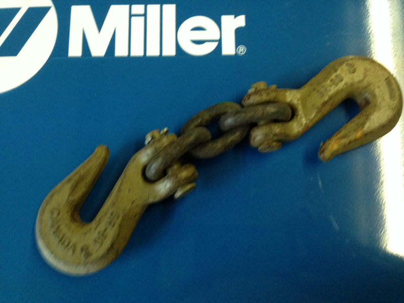

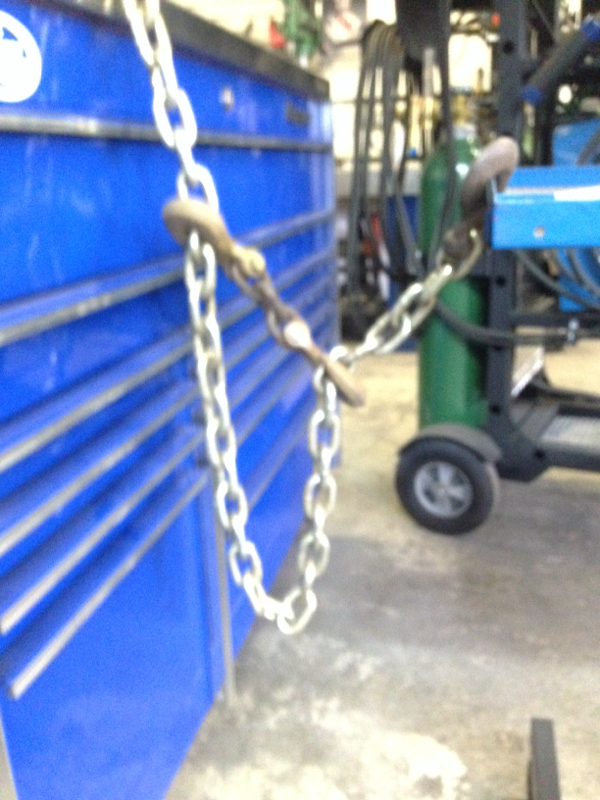

For a quick way to shorten chains, make up a couple of these and keep one in your tractor tool box.
Terry

Thats great, thanks! Saves me the pain of 'cutters remorse'.
Terry
I don't know why I never thought about this - but I'm sure glad you did :D
Thanks for posting :thumbsup:
I'm constantly picking stuff up with chains that are too long and have to be wrapped to take up slack.
   / Quickie log-drag, (paper-thin MIG weld) #47
Well, darn! That is a pretty good idea! I am going to make one of those.
   / Quickie log-drag, (paper-thin MIG weld) #48
So simple! Thanks for sharing Terry. Gonna make me one too! :thumbsup:
<img src="http://www.tractorbynet.com/forums/attachment.php?attachmentid=422579"/>
<img src="http://www.tractorbynet.com/forums/attachment.php?attachmentid=422583"/>
Terry

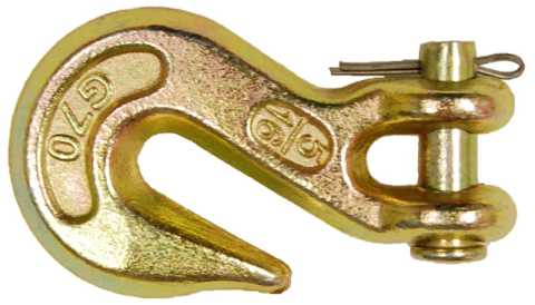

Or, pull the pins holding them together and hook the two clevises together. You will need to replace the pins with a grade8 bolt that is just long enough to have the "shoulder" for the whole clevis area.

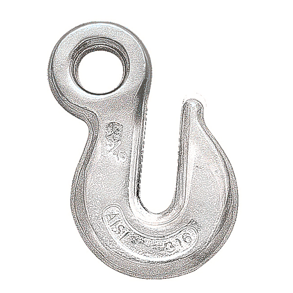

What about just carrying a single grab hook and positively attach it to the chain where needed? Same idea as the clevis claw above, but a simple grab hook. Where you replace the cotter pin with a spring clip, or just bend the cotter such that it acts like a spring clip. Of course those small parts can be lost out in the woods.
Or if you want another 'link' can use an eye grab hook and this double clevis link

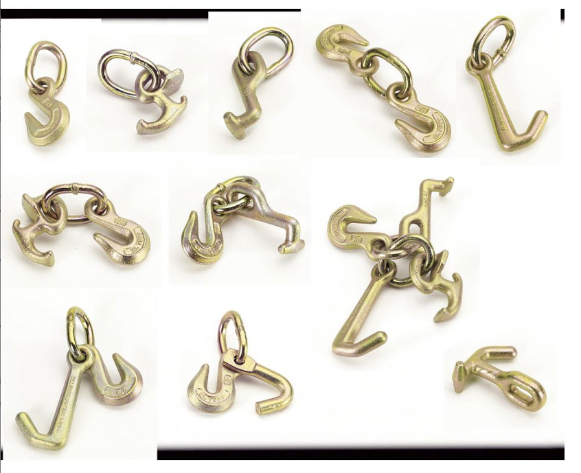

Lots of devices available, heres a bunch of them from Grainger
One bolt thru all four clevis holes, thats a good way. Using a nyloc too. May have to grind the clevises a little but yep that's an easy way to do it. or Clevis hook and eye hook together - not sure if these actually fit but I will find out this morning at the store.

One bolt thru all four clevis holes, thats a good way. Using a nyloc too. May have to grind the clevises a little but yep that's an easy way to do it. or Clevis hook and eye hook together - not sure if these actually fit but I will find out this morning at the store. <img src="http://www.tractorbynet.com/forums/files/welding/422710-quickie-log-drag-paper-thin-h5-16_med-jpg"/> <img src="http://www.tractorbynet.com/forums/files/welding/422709-quickie-log-drag-paper-thin-eye-grab-hook-aisi-316-a"/>

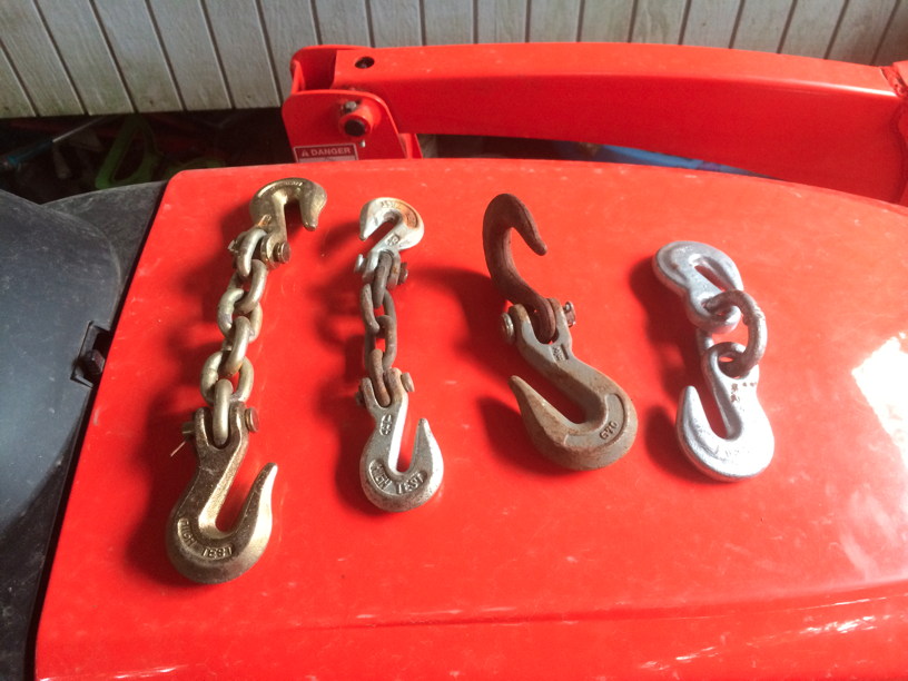

I thought everyone knew about chain shorteners. :)
I walked out the the tractor shed to take inventory.
The one on the right was factory made.
Bruce
PS: The third one may not qualify, but is good for hooking something besides a chain to a chain.
Bruce
Nope, but I do now!. I bought the stuff and made one today. I had to buy a foot of chain they would not sell any less.:eek: I made him cut me 3 links though.:)
