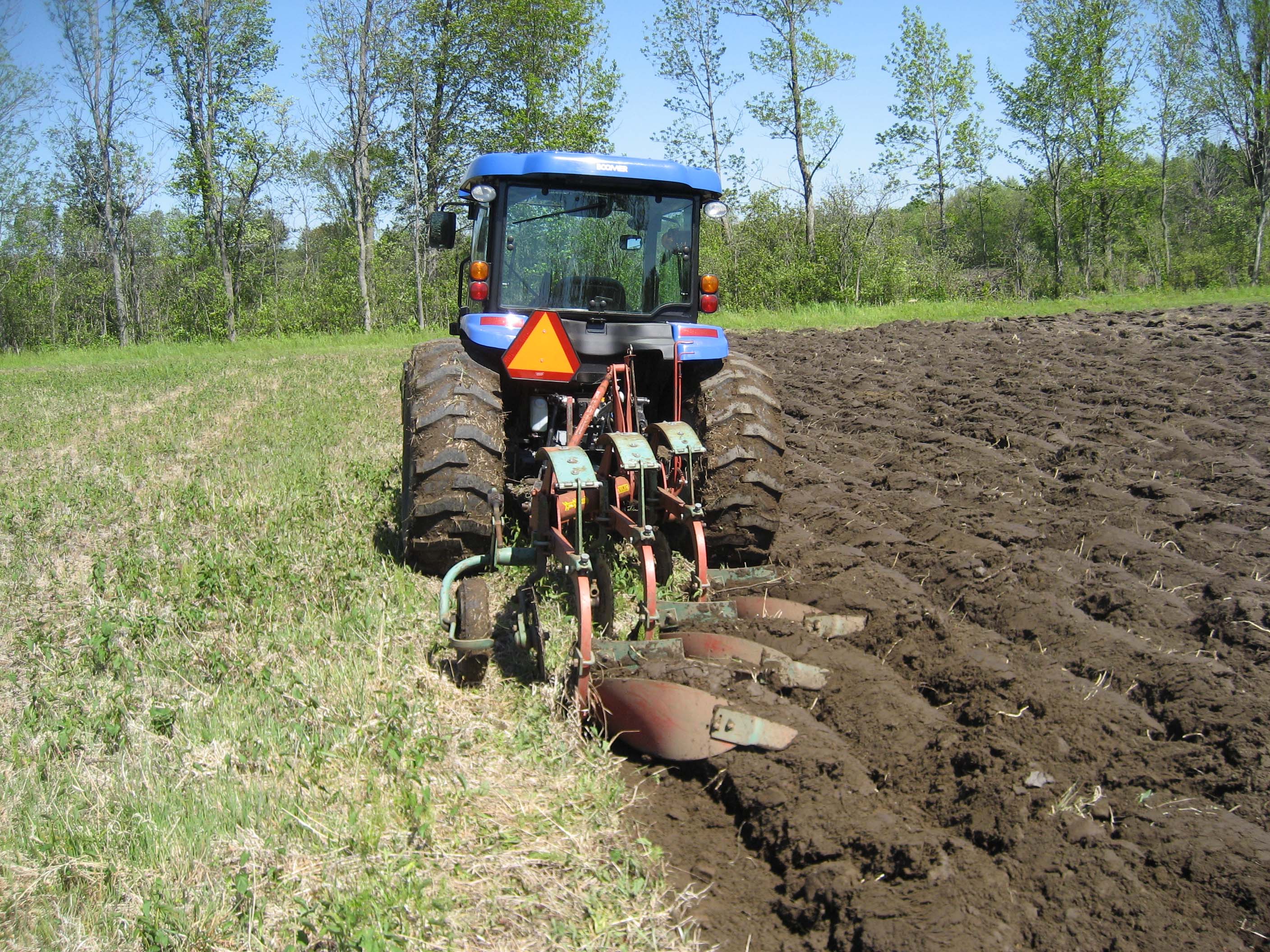

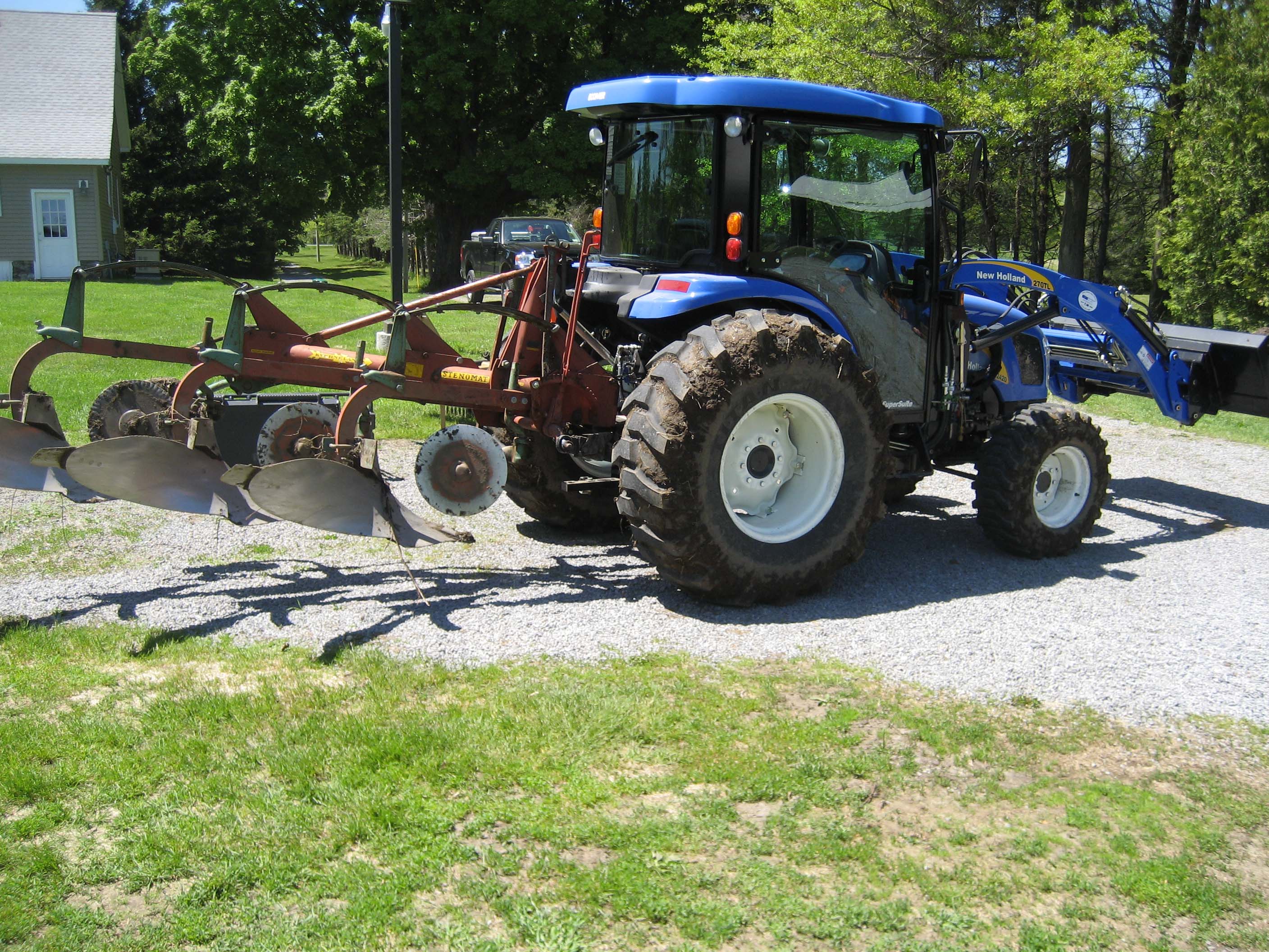

to be totally honest with you unless I'm plowing in a very wet field in the early spring in upstate New York I really don't lose that much traction if she starts to slip I just thrown in four-wheel-drive and away I go, I think the tire choice would be more problematic on a 2 Wheel drive tractor. there is no doubt R1 will give you best traction but, is it worth your lawn for the few times you'll need that kind of traction . I plowed and disk about 60 acres this spring and about 40 acres of land clearing rocking tree limbs and a whole bunch of other stuff during the winter maintaining my 1400 foot driveway and barnyard,snow blowing ,plowing with the loader lots of snow sometimes 3 feet in a storm mostly Nor'easters I've yet to have one incident of being stuck with my R4 tires not to mention they definitely handle heavy loader work less flexing in the side wall and a little more puncture resistant in the end either tire will do,it's too bad you couldn't try both tires to see which would be the most productive on your property .

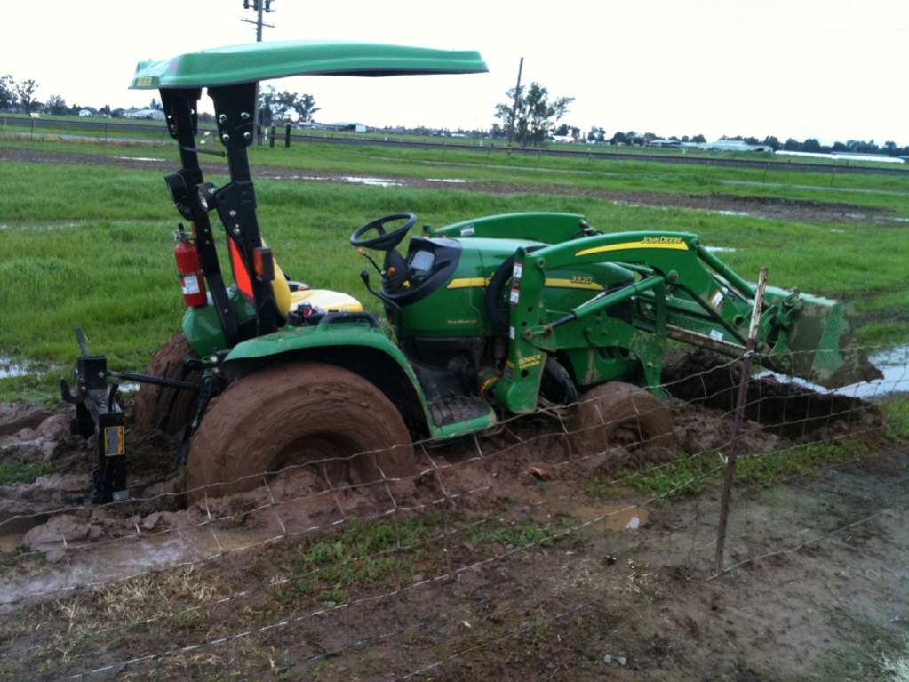

R4's did not help me this last Saturday :). Seriously for the hard clay California soil my r4's have done fine. I plow, disk,and till with them. Mine are filled at all corners, so that I'm sure helps me. That being said I would like to try r1's just to see the difference.
If that a floodplain, or what? Why in the world did you put your tractor in that wet mess?

Deadman, what you don't see in that picture and what got me in that mess, was trying to get my buddies pickup unstuck. My front tires sunk first, I used the bucket to successfully get unstuck, but could not get the rear tires to clear the ruts left by the fronts. Once the rears sunk, I successfully used the bucket to completely sink the machine :(. Hours upon hours of pressure washer time!
