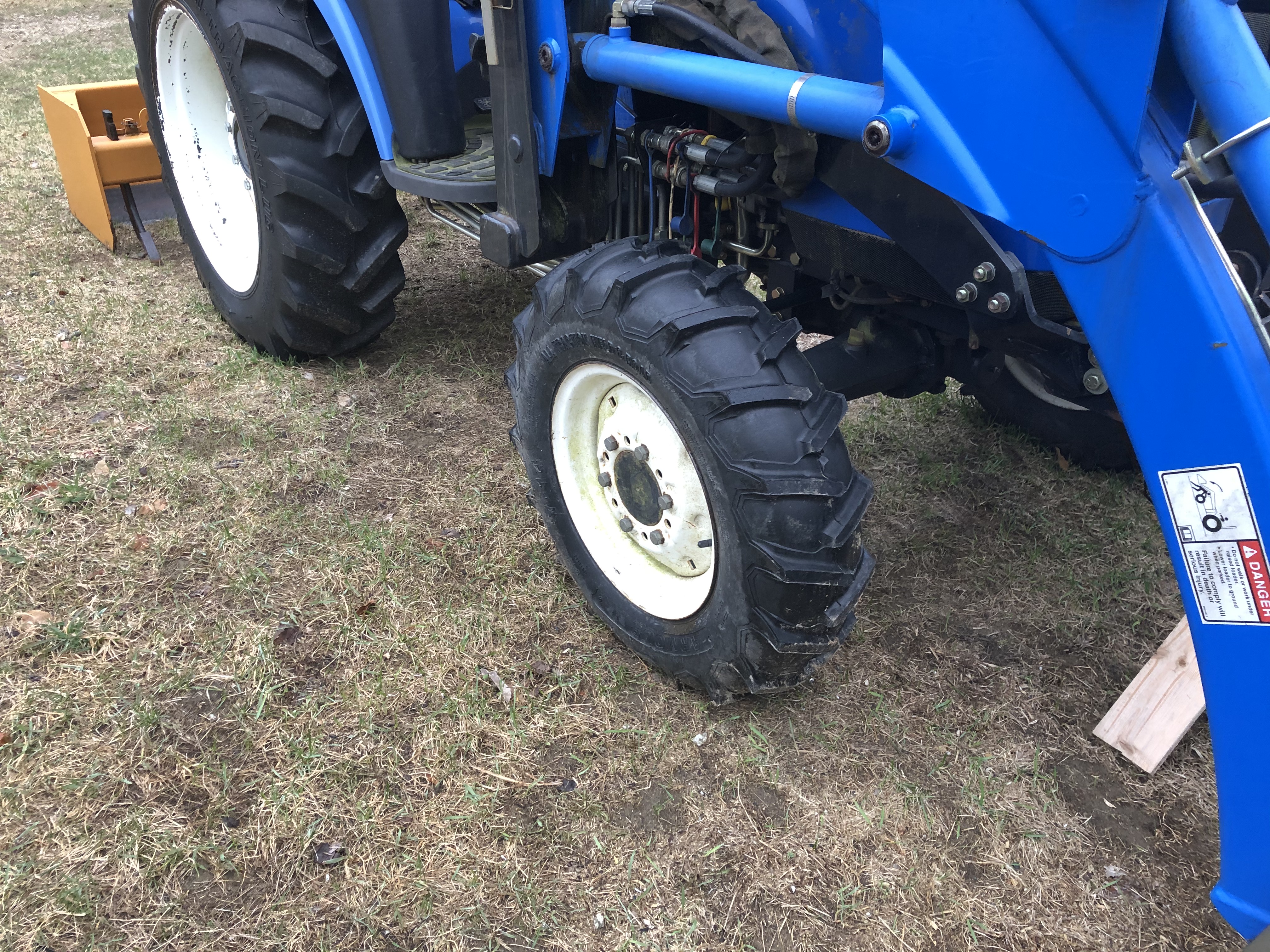

/ R1 to R4 #18
I have not tried them on our wet soft ground surface yet, but a less aggressive tread pattern might be less destructive and still provide some degree of "R-1" traction.
23deg Tread Bar Advantage - Firestone Tractor Tires
Amour All Traction Field and Road.
An R-1 23º tread bar pattern instead of the more aggressive 45º pattern
