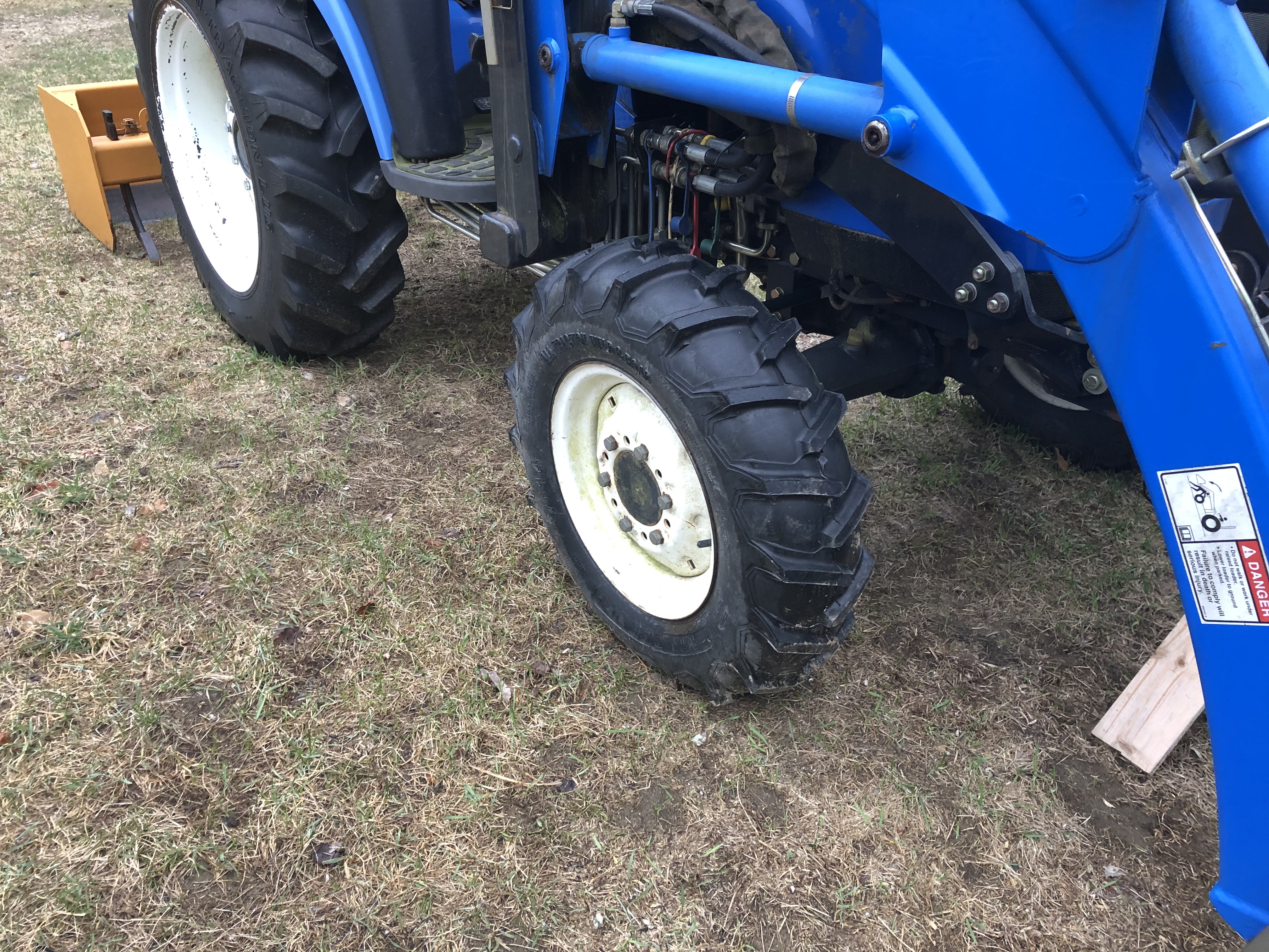

Thought I had found a reasonable source of R4 rims, $66 for fronts, $126 for rears. But shipping was over $100 each for the smaller ones. $1000 just for rims is not in the budget.
   / R1 to R4 #16
I have 2 machines, 1 with R4s and 1 with turfs. Hard to beat turfs for lawn and snow. I think for 95% of what I need turfs are great, for the other 5% you have to call a wrecker to get you out of the weeds!
   / R1 to R4
#17
There are times the R4s don’t have the traction I need, when ground is wet. We tend to get more than 140 inches rain per year, 49.5 ytd. These are the conditions where the R1s tend to be more destructive and I imagine the Tuffs just wouldn’t cut it. I’m making this guess based on tire slippage with the Scag and Craftsman rider.
   / R1 to R4 #18
I have not tried them on our wet soft ground surface yet, but a less aggressive tread pattern might be less destructive and still provide some degree of "R-1" traction.
23deg Tread Bar Advantage - Firestone Tractor Tires
Amour All Traction Field and Road.
An R-1 23º tread bar pattern instead of the more aggressive 45º pattern
   / R1 to R4 #19
I heard R4 have stiffer side walls compare to R1 less chance tire popping of rim.
   / R1 to R4 #20
That's my understanding as well. I am happy that those new replacement R1's are 6 ply. I do not think >6 ply R-1 tires exist, but I am probably wrong.
