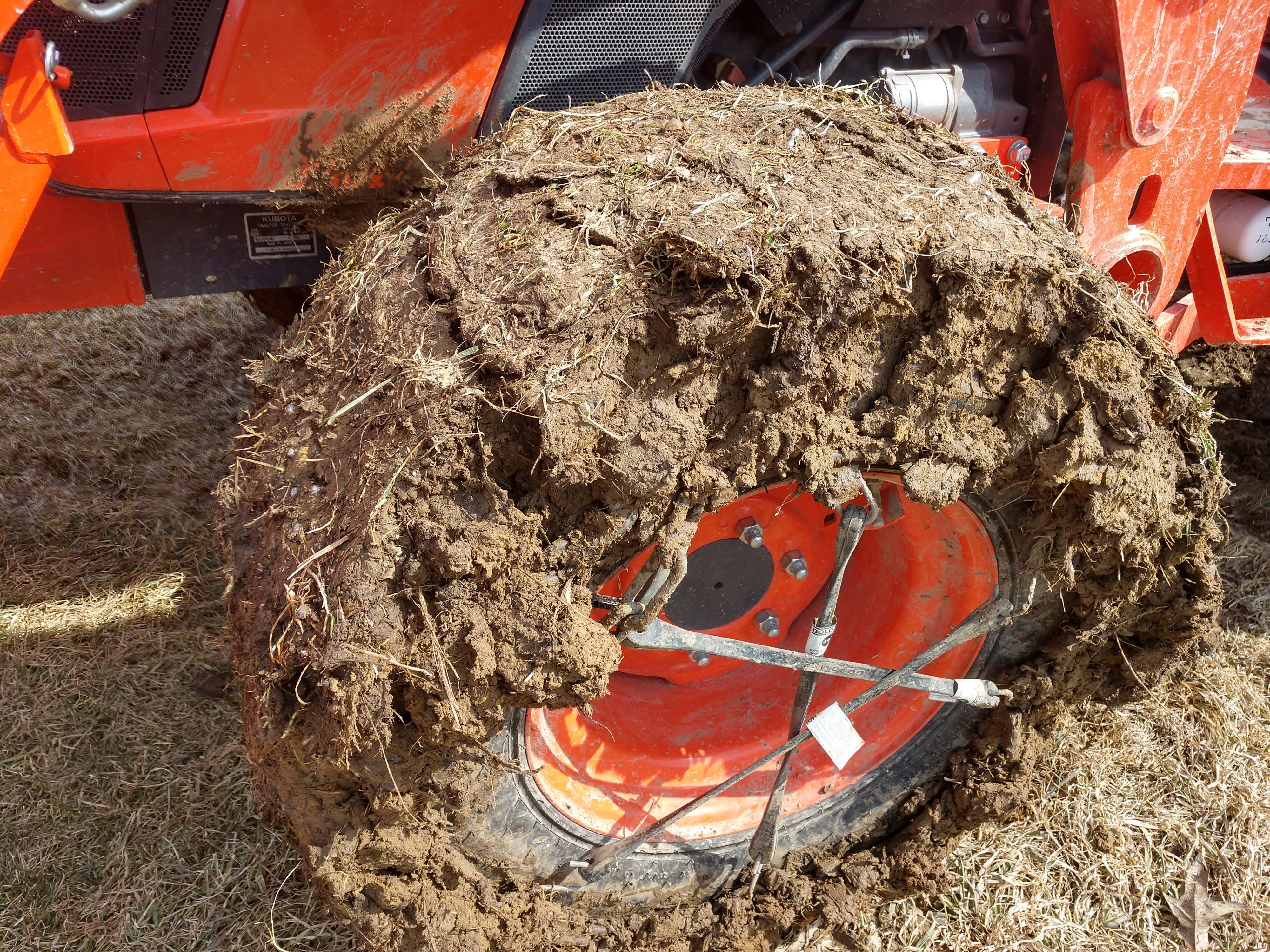

I got a new RK37HC tractor and specified R14 tires. I think it was a mistake. They get caked in mud and spin on my hilly terrain, and leave ruts if the ground has any moisture on it. The tractor is heavy, over 5,000 lbs with the loader on, and because they spin on the slightest incline I'm always going into 4 wheel drive.
The cross section is rounded like ag tires but the tread in the middle is dense, like turf tires. I thought the wide spacing on the sides would help with grip going up and down my hill but at the recommended factory pressure with beet juice in them they maintain the rounded profile and the center tread digs in and fills with mud, so they slip. New tractor has a diff lock but even then both rears can spin, so I have to be in 4 wheel drive mode - which tears up the ground on tight turns. My hindsight now tells me I should have gotten R3's - at least the cross section is flatter to distribute the weight. I am also going to let the air pressure drop a bit to see if the contact patch can be made flatter, but I can't really take air out because when I try beet juice comes out. Further exploration as I learn about my new machine.
My old 8N with R1's struggled up the hill just fine - though in soft ground situations I had to break a spinning wheel on the steepest part.

Are your R14's radials? What ply rating are they? What pressure do they recommend? With that pressure, will the tire tread sit down flat on pavement or is it still "rounded" where it touches the ground? At what pressure will the tire tread be flat to the pavement?

I've never had conditions like Chesapeakeboy pictured. Even in the worse of conditions - I can get by with R-1's. I may tear a whole in the earth but I will get thru. The R-14 look good but I need the chevron pattern of R-1's - not the center highway pattern of the R-14's.
Besides - it's only taken a couple times to learn where to, when to go and when to sit at home and wait.
With the valve stem up at the top, you should not lose much beet juice.
