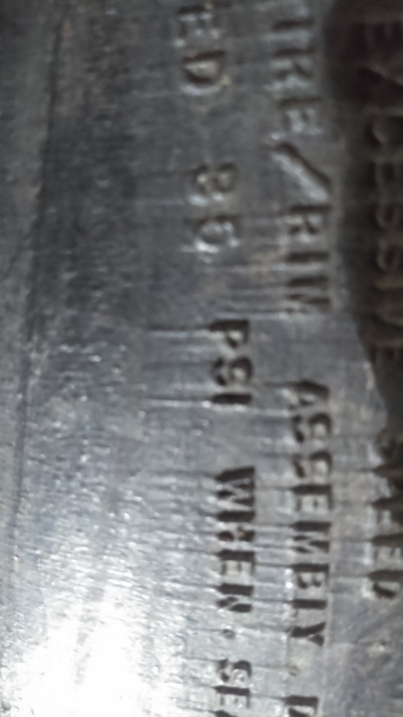

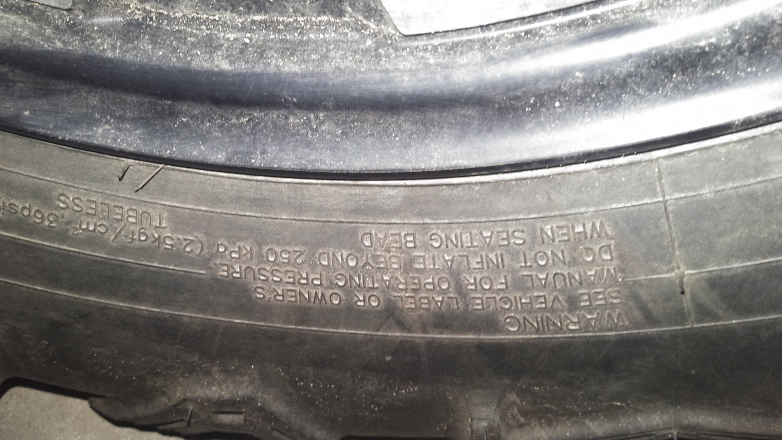

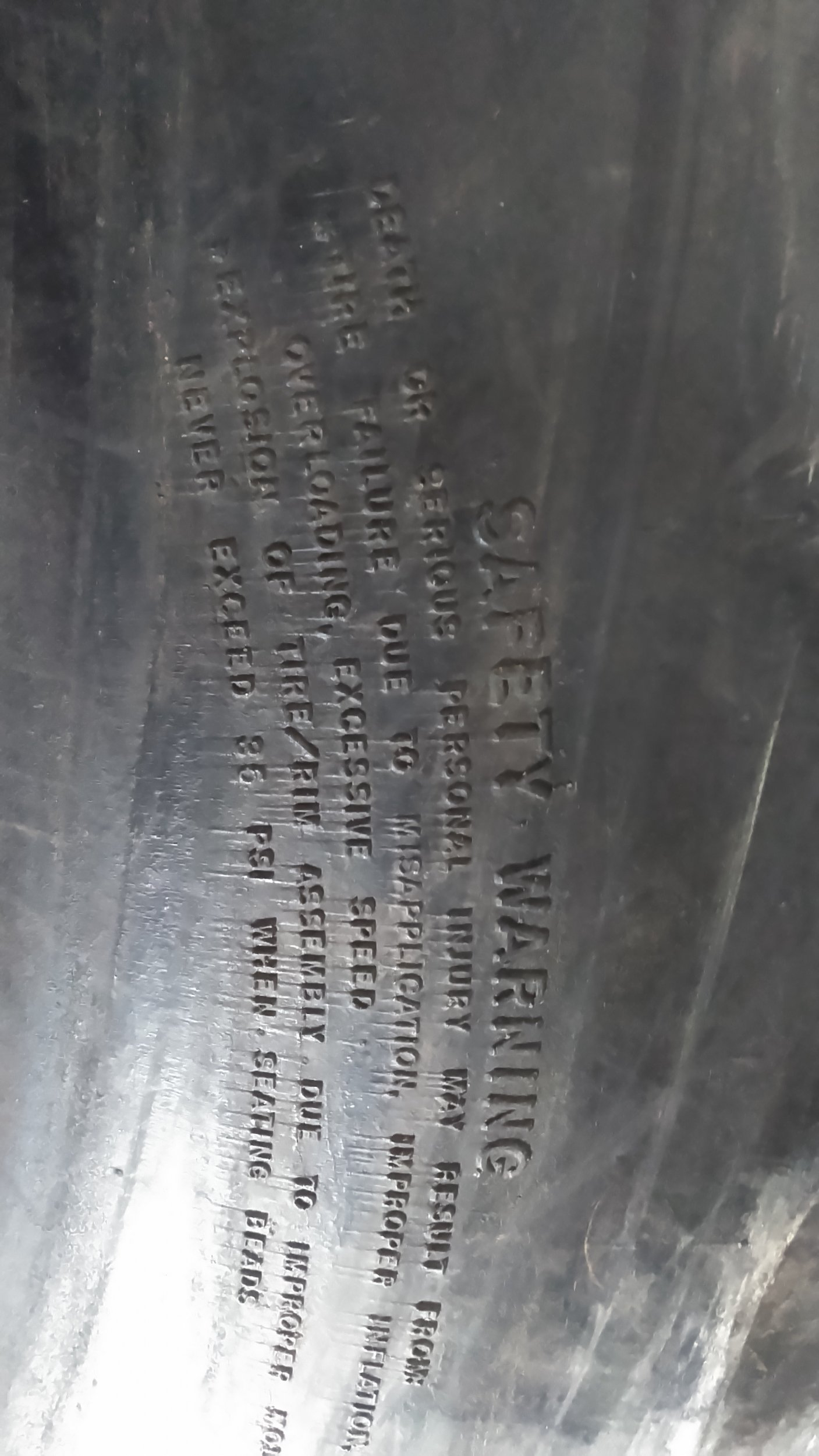

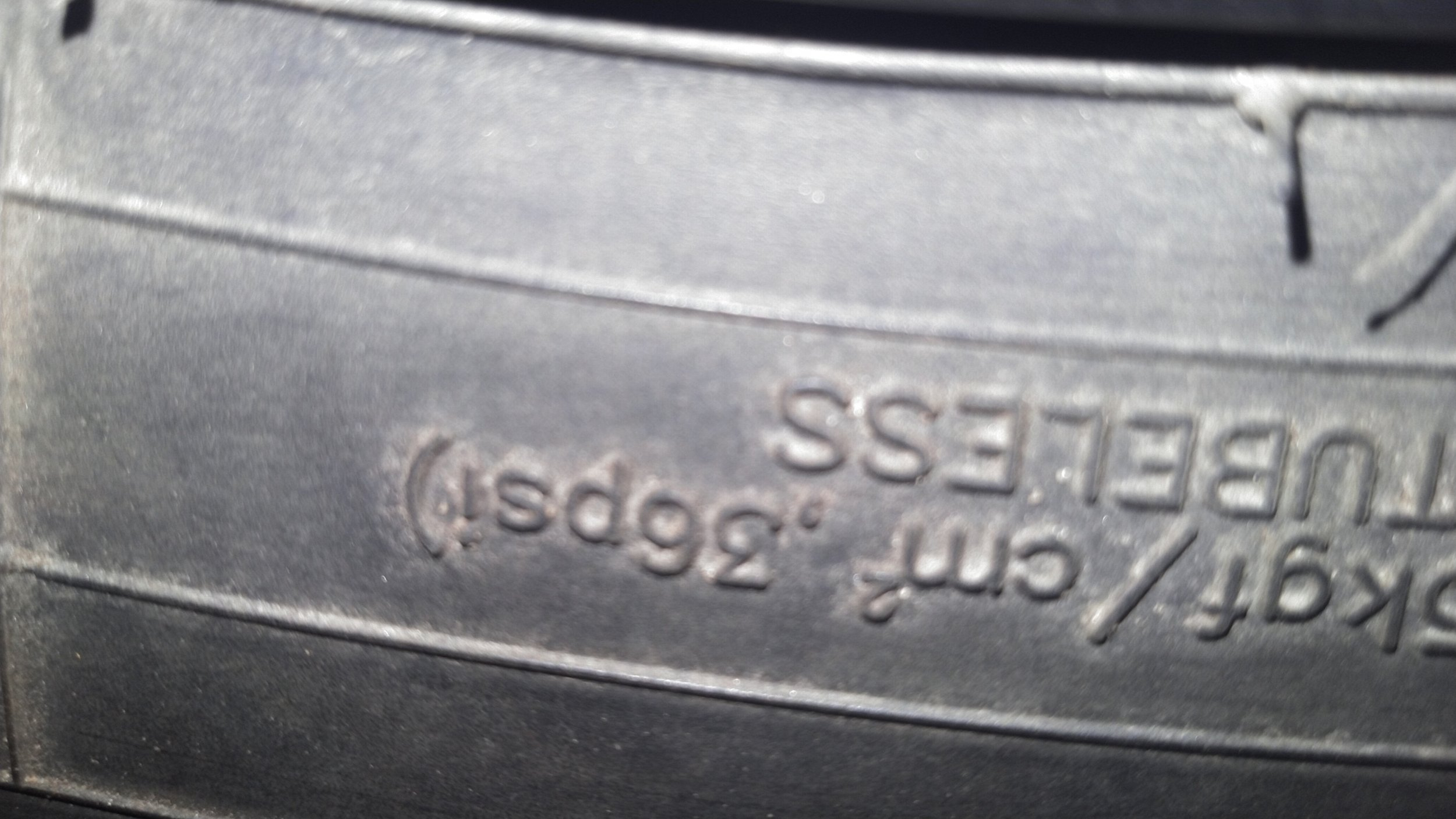

However further investigation of what happened showed it should have had a max 10 psi +- cold. Not 35 and definitely not 44
   / R14 tire pressure... have you read the sidewall? #22
Dumb question but are you sure that's not 30.0 kpa which is around 4.4 psi?
   / R14 tire pressure... have you read the sidewall? #24
Big difference. Much attention has to be paid to this. Same with load capacity.
