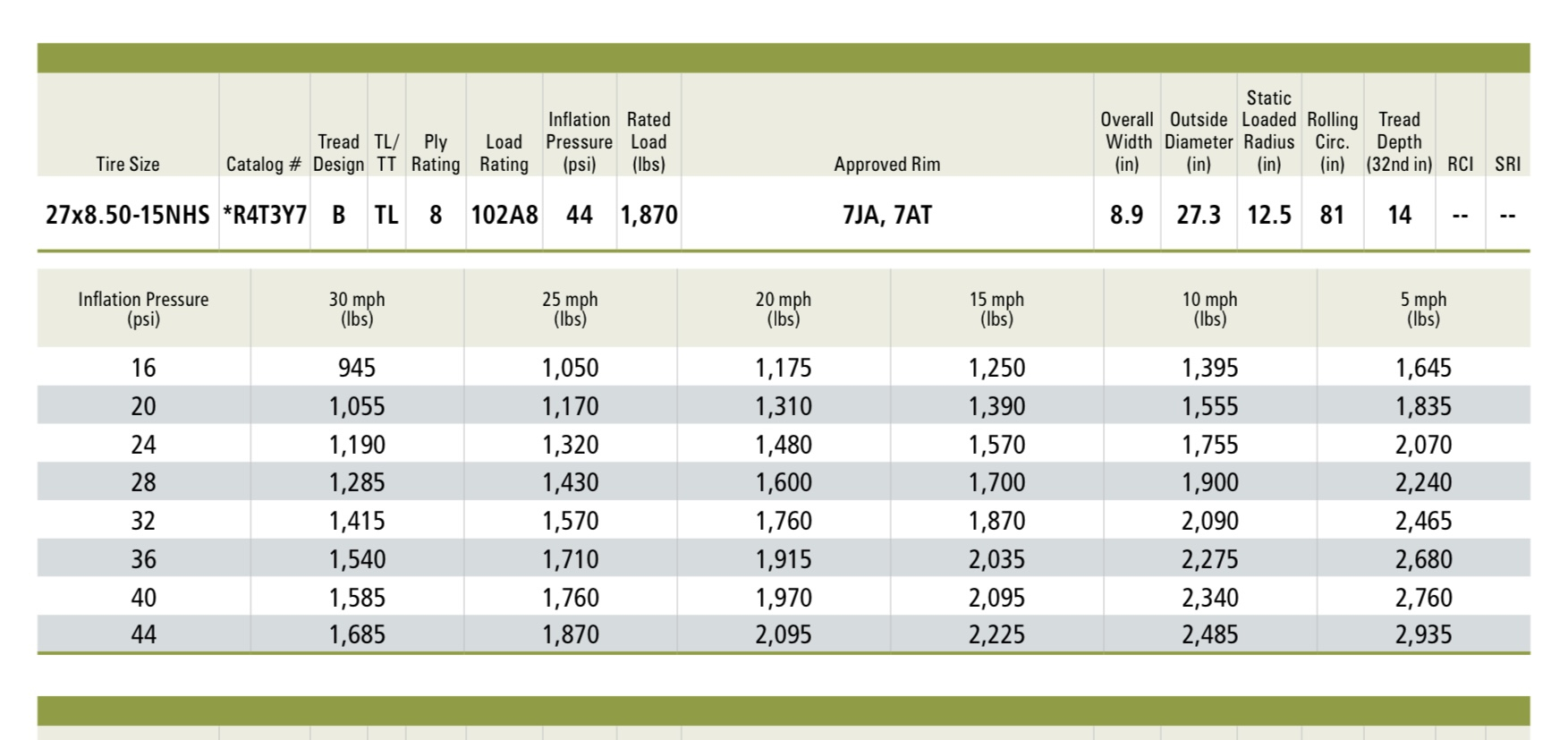

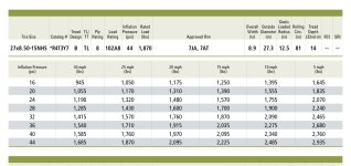

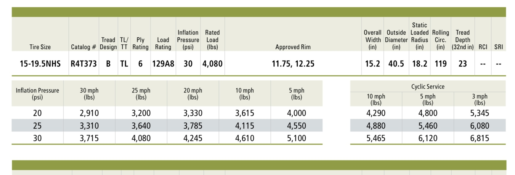

I experienced the same. My manual did not cover the r14. The dealer told me to use the number on the sidewall which I knew was wrong. That’s typically the max allowable pressure not recommended pressure. Found the Titan tire specs that had recommended load vs pressure charts for my tires. So now I set tire pressure based on loader/ballast vs mid mount mower. Noticed much better ride when mowing and front wheels stopped scrubbing the grass in tight turns. Did have to guestimate tractor weight distribution. Here’s the link.

Thanks for the link…
Gives me a good starting point…
FWIW, these charts are for the Kioti CK10 tire sizes… other sizes are listed in the link above…

My tractor, guessing, weights maybe 3000 - 3300 lbs (with FEL and tire ballast)… extrapolating the charts, if I run max pressure (44 psi) in each tire I could carry a whole ‘nuther CK and still be under the tires weight ratings…
