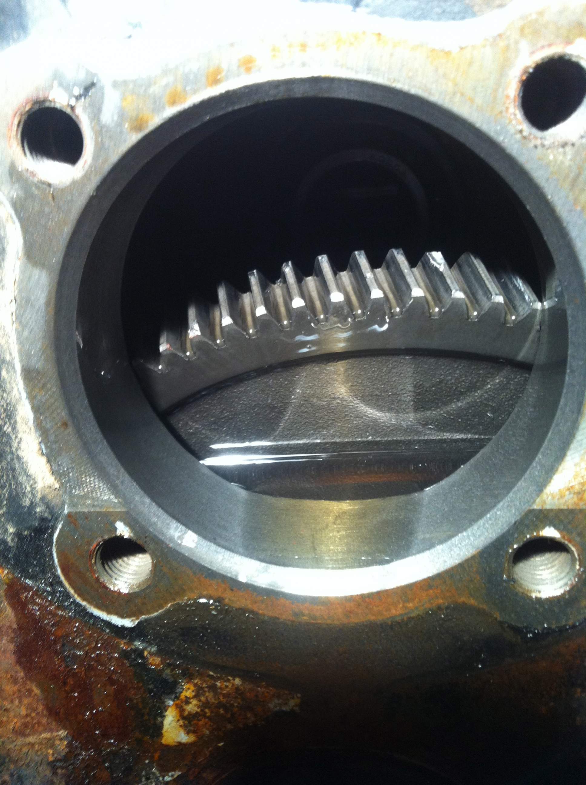

I have an R3644 with a FEL, bucket, quick-attach snowblade, harrows IMG_4834.jpg and a 5' Razorback bush cutter.
It has been running great. Used it lots for moving snow last winter (and soon enough, again), pounding in fence posts (borrowed neighbors post pounder) and recently, clearing some brush.....
This weekend I was running the bush cutter. Mostly 1" or so brush, and ended up driving it over some chunks of wood (somewhat rotten logs) that were too big..... (hanging my head, yeah, i know a bush cutter is not meant for busting up logs, rotten or not) and the mower stopped spinning. Switched the PTO off, looked for broken shear bolts, didn't find any, turned the PTO switch back on and i could hear something turning, but the exposed shaft was not moving...
I ended up pulling off the 4 bolts that hold the PTO shaft in place and pulling out the PTO. The shaft that pulls out is roughly 10" long, the "teeth" on the inside of the shaft seemed unharmed, but when i looked inside the hole, i can see another shaft about 4-5" above where the PTO shaft would be and the "teeth" on it were obviously damaged/sheared off. (see attached pic)
Has anyone dealt with this repair before?

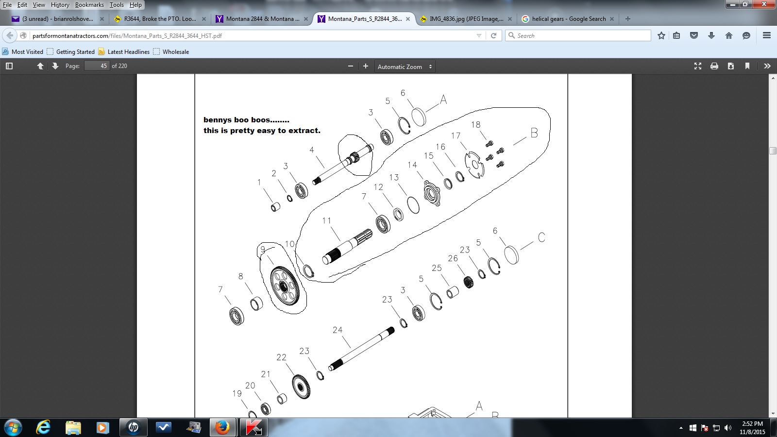

Benny can you identify if you have broken shaft #4...looks like there is a rubber plug to pull for exit...that actually looks easy to extract from the rear but yes the top need to be open as well.
Pulling another thread over here to keep the threads on topic... ;)
Spokane1,
Yes, #4 is toast. You can see the spindles are sheared off. Also #9 is damaged. #11 looks good but i'm going to have a machinist friend take a real close look at it. Kenny at Magee Farm Equipment, (he was mentioned above) also mentioned a few other parts that i should be replacing, but i have yet to receive the complete list and quote.
Right now i have the seat off and am working on pulling off the "cover, center" (#5 on pdf pg164). I'm thinking i need to remove the rear fenders as well, just not 100% sure yet???
Sure wish the parts pdf wasn't password locked as i cant print, copy or make any notes on the pdf.

I do believe all has to be removed off the top of the tractor 10-20 hours....specially if you have rop's atop. """""USE DIGITAL CAMERA""""" lots of marked coffee cans for bolts.
the reason for using the camera is tranny parts are 2-3 months out from you sitting in Korea.....you will easily forget how to reinstall all of it without photos.
looks like shaft 4 is just shifted backwards tapping carefully the rear bearing will slide backwards then after ample distance has been gained slide the shaft forward back toward home
and remove the shaft out the top when clear of bearings.
ill see what your other numbers go to in a bit.
   / R3644, Broke the PTO. Looking for repair guidance. #9
so it appears you have unit 11 already extracted. so if visual is OK make sure you manga flux it as well. item 9 extract out the top after shaft 4 has been removed. make sure you note gear direction with camera before you extract it. The print shows they are helical cut.
Im still unclear of the pdf dimensions...hahaaha the size of the items 7-8 in the print shows 11 should not have slipped out. Ok so-much for print correctness.

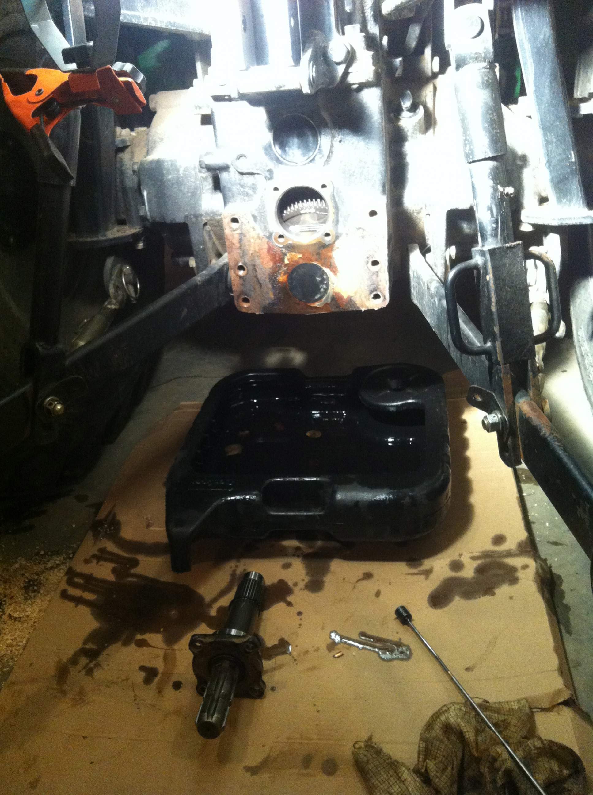

Yeah, 11 just pulls straight out from the back. Not sure what magna flux is, but i'm sure my heavy-duty mechanic/machinist neighbor does.
I emptied the fuel tank and have that off now... working on "cover, center" (#5 on pdf pg164). don't think the fenders have to come off. When i removed some bolts for taking off the fuel tank, it loosened up the fenders and they pull out a bit, freeing up #5. Just have to manouver it off around all the different leavers....
