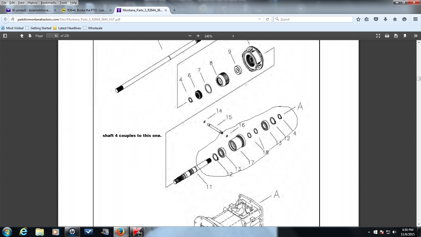

this is where shaft 4 couples to in the hst.
   / R3644, Broke the PTO. Looking for repair guidance. #12
see if you can remove the pan and fenders married to lessen the work. it might be heavy so get help or have a crane.
yes on 11....I see i erred in saying it tips and comes out the top. it has a internal web removing any thought of tipping. it obviously slips out the back.
did gear 9 drop when you yanked the pto? so that appears to be free floating......now?
so define for me..shaft 4 and gear 9 run together?
I see shaft 4 couples with another shaft 11 in the hst on page 41... This couplet is going to have to be handheld during removal of shaft 4 otherwise it will slip into the lower case.
sometimes mechanics magnets cant pick those up so be careful..
I also noted the mid pto shaft is a *****........(((if anything is wrong there)) you must split the rear pumpkin off.

You wrote... "I see shaft 4 couples with another shaft 11 in the hst on page 41... This couplet is going to have to be handheld during removal of shaft 4 otherwise it will slip into the lower case."
By "hst" do you mean hydrostat transmission? If so, i do not have that option. Regardless what "couplet" are you referring to? A particular part?
   / R3644, Broke the PTO. Looking for repair guidance. #14
yes to all Benny......the couplet is far ahead of you....... if your still cleaning the top pan. it marries the power from shaft 11hst to pto shaft 4 then to pto gear 9????? I assume.
theres so much going on in the prints I get confused of power flow.

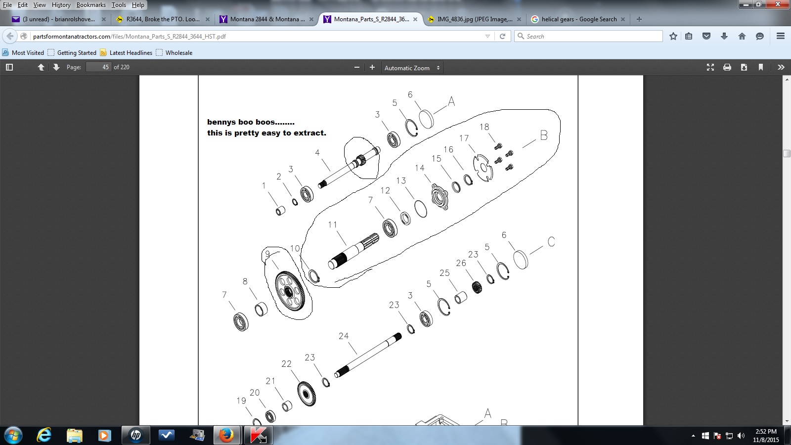

Once you have the pan off drained the oil and pulled the lid give me another digital shot of shaft 4. At this point you may want to survey any and all damage...try to pry out the rubber plug on shaft 4 and give me a diggy of that too. (figure out how to roll all gears affected to survey damage.)
its best to leave it together and order your parts at this point. and replace the PTO lid and drink Molson gold for 3 months until your parts arrive ( I don't know if that rubber plug is considered sacrificial you may end up destroying it but if it pops out unharmed you may luck out )

so it appears you have unit 11 already extracted. so if visual is OK make sure you manga flux it as well.

Hey, would the rubber caps (#6) be better pried off from the outside or popped out from the inside? I'd love to hear some advice on this before start picking at them.
   / R3644, Broke the PTO. Looking for repair guidance. #20
ha Benny If you check the print you would see you have a bearing in the way of removal from the cap from the inside.
Me personally I would take a nice sharp ice pick slide between the metal at top and rubber cork cap and pry it down then slide in a nice blunted rounded flat blade screwdriver...or multiple flat blades and it should soup bowl out of the hole.
try not to puncture the rubber it might be ship lapped or have a stair step that you cannot currently see thats why I use rounded edged flat blade screwdrivers mostly.
