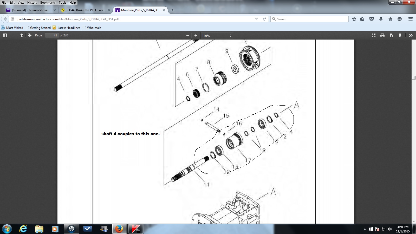

this is where shaft 4 couples to in the hst.

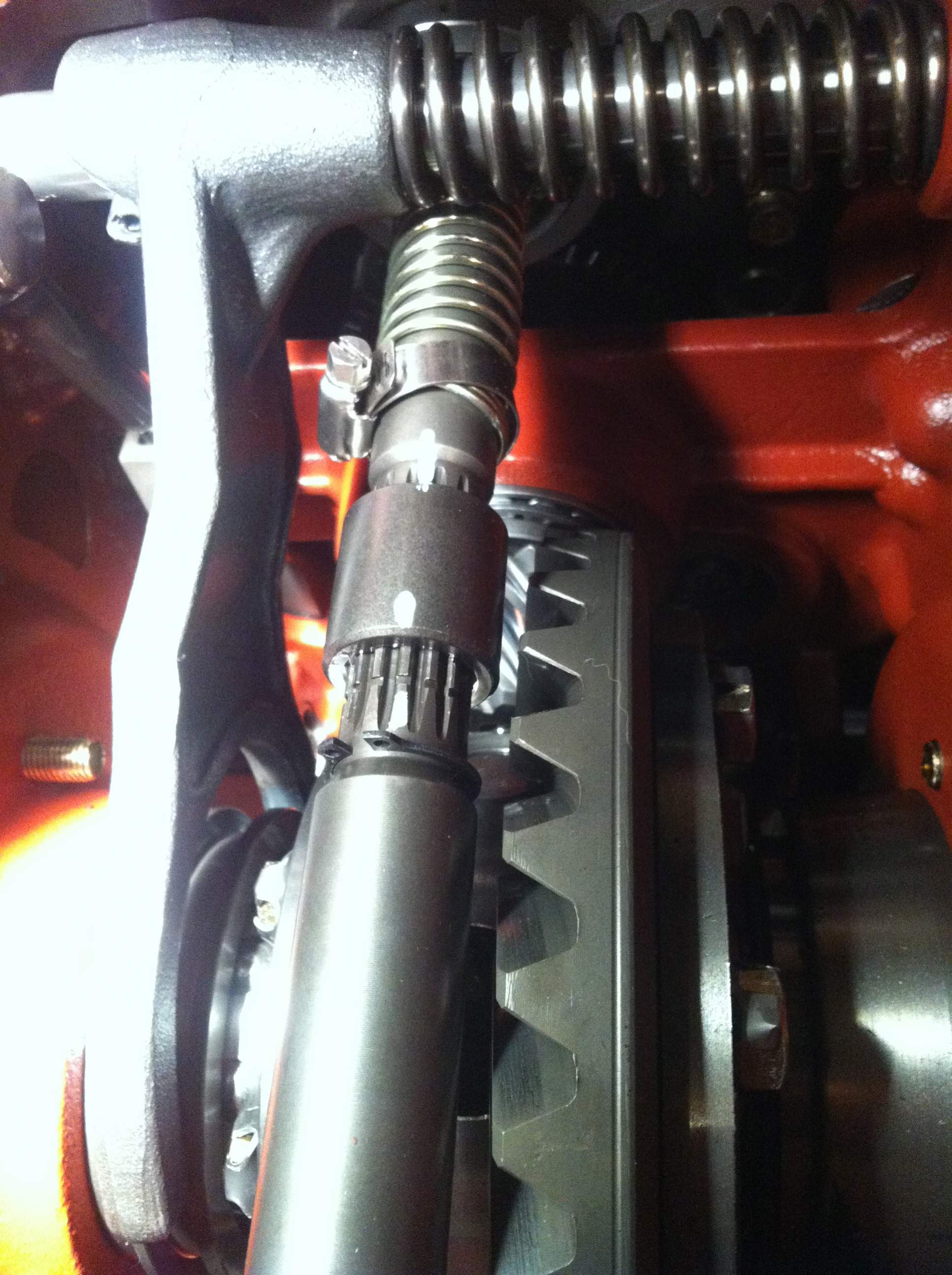

Interesting... in my tractor the snap ring (first one on the right at the bottom in your screen shot) isn't there and there is a spring around the shaft that is not shown in this photo. I'm guessing it should be between 4 and 12
See attached photo... i have the snap ring from shaft 4 pulled back and have a hose clamp holding a spring back that appears to be pushing the joint/coupler into the snap ring on shaft 4.
