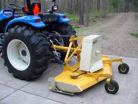

So are you saying that those Titans are or are not aggressive for an R4? I've included your original picture in my post.
Yes, it is my believe that the Titan's on my TC-40D are not very agressive. There is not much of an angle to the ribs and lots of open (non-rib) flat area.
