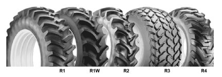

Thanks alchemysa for that link. Found reading the entire pdf on tires interesting. The only complaints that I have about my R1's is the lack of puncture resistance but hey it's a 4PLY tire so I know it's soft. I've had 2 flats (on the same side) one front one back. On the front I actually had two flats same tire. The first time I slimed it and it lasted about 6 months. The second time I plugged it. On the back I had to have someone come out because when it punctured it broke bead and I couldn't get it back on. I keep a plug kit in the tool box and it takes all of a couple of minutes to repair a tire and I'm back in business. As far as ground disturbance that everyone is talking about between R1's and R4's I've found that by using a wider R1 I can aleviate that to a point. When I got my tractor because I knew I was getting a 2wd I had a choice of 13.6, 14.6 and 16.9. I opted for the 14.6 whiched seemed like a good choice. When I need to replace I will probably look into the 16.9's as I'm not doing any row crops just hay. I kinda wish I'd gone with the 16.9's to begin with.

Alchemysa did give so good info. Here's the picture of the different tires.

R-4 tires are used around here on construction sites where they don't work when wet. Guys doing finnish work prefere them as they don't tend to dig up thework area. They don't work so good in deep mud (such as river bottom mud with no bottom) or clay soils when wet. My neighbor bought a 'bota with R4's and is looking for a buyer for the R4's. The R4's work great on dry ground but during summer haying and winter , feeding when wet, chores he uses his big Green tractor with the R1 long bar/short bar ag tires.
Depending on soil type/wet season or dry season even the R1 long bar vs long bar short bar can make a difference. The Amish folks around here seem to like the long bar R1 for their use especially on their hiway tractors and R1 long bar short bar for field work.
My son lives in central FL with 17 acres in the sand. R4's are the only way, dry or wet, as R1's tend to dig deep too fast.
