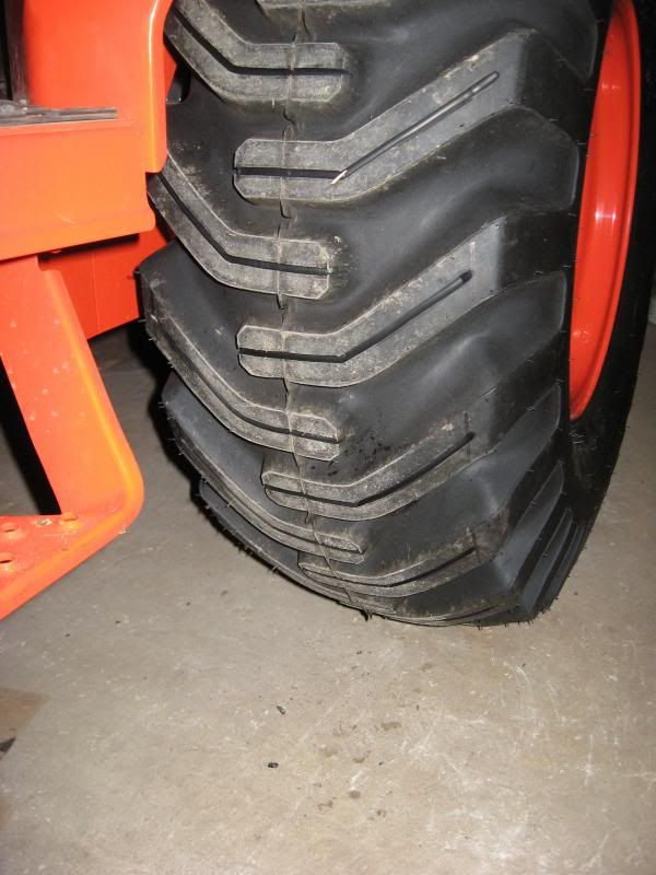

So I have to say the R4 tires on my kubota b2620 worked way better than I expected. I have a very steep driveway and had no issue getting up and moving around. A couple of times my front wheel went off the side of the driveway while piling up snow. After locking the diff I was able to back out uphill with no issue. I thought I would need chains but I don't think I will bother now. :cool2:
I would have a Plan B in mind. :) As others said, ice on a steep drive may cause you to re-think that. My drive is only moderately sloped and I have done 360's on ice with R4's and no chains.
Also, if you put a front wheel off the side with ice, you may not have the traction to back out. I would keep a couple bags of sand handy if I were you.

http://www.tractorbynet.com/forums/customization/233050-trying-tire-grooving-next-mod.html
http://www.tractorbynet.com/forums/snow-removal/193438-cutting-groving-siping-r-4-a.html
After reading all the info in those two threads I bought a tire grooving tool - chains/studs are the only thing that will really work on ice, but the addition of grooves in the R4's for snow seems to make a big difference.
