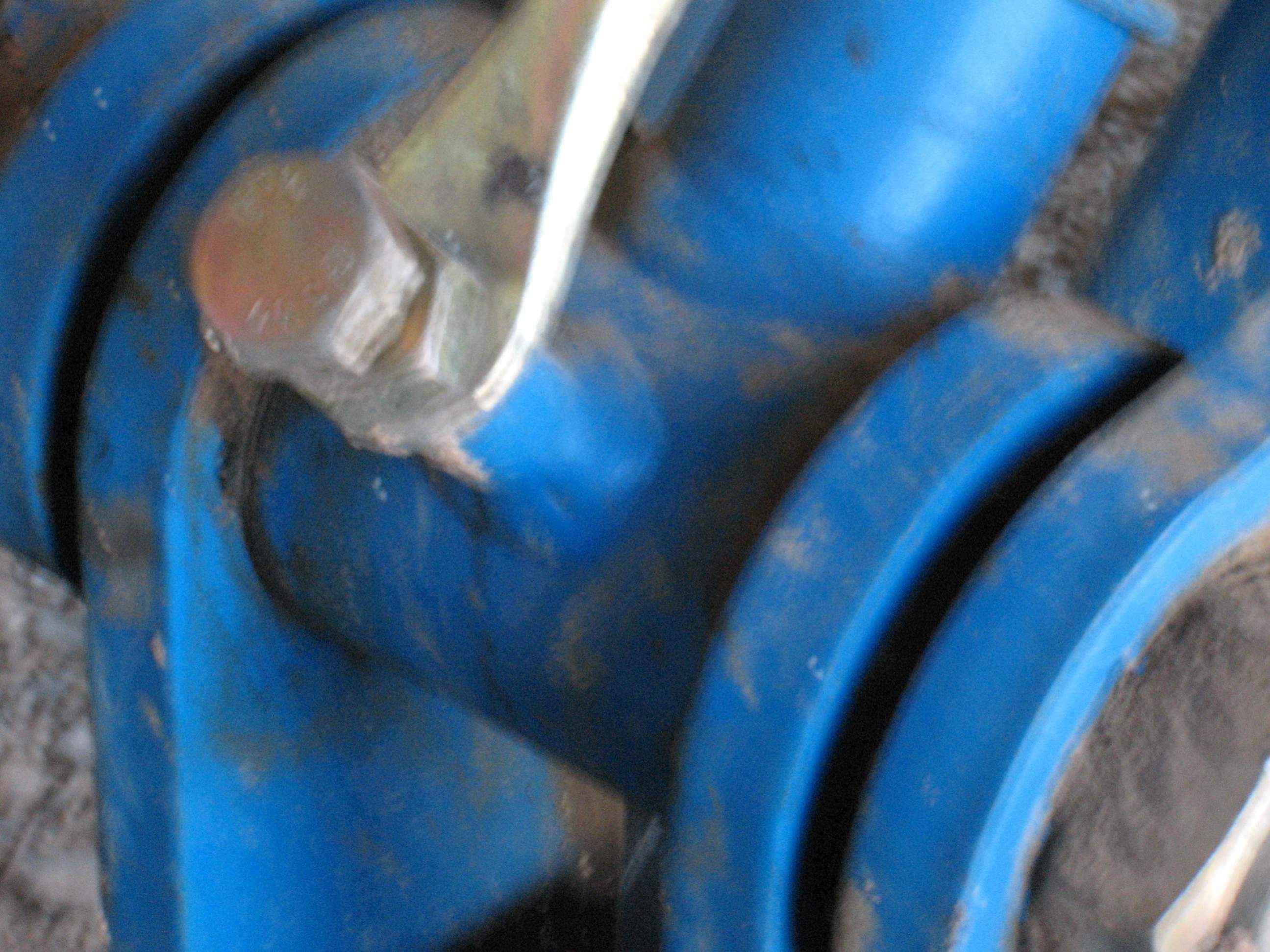

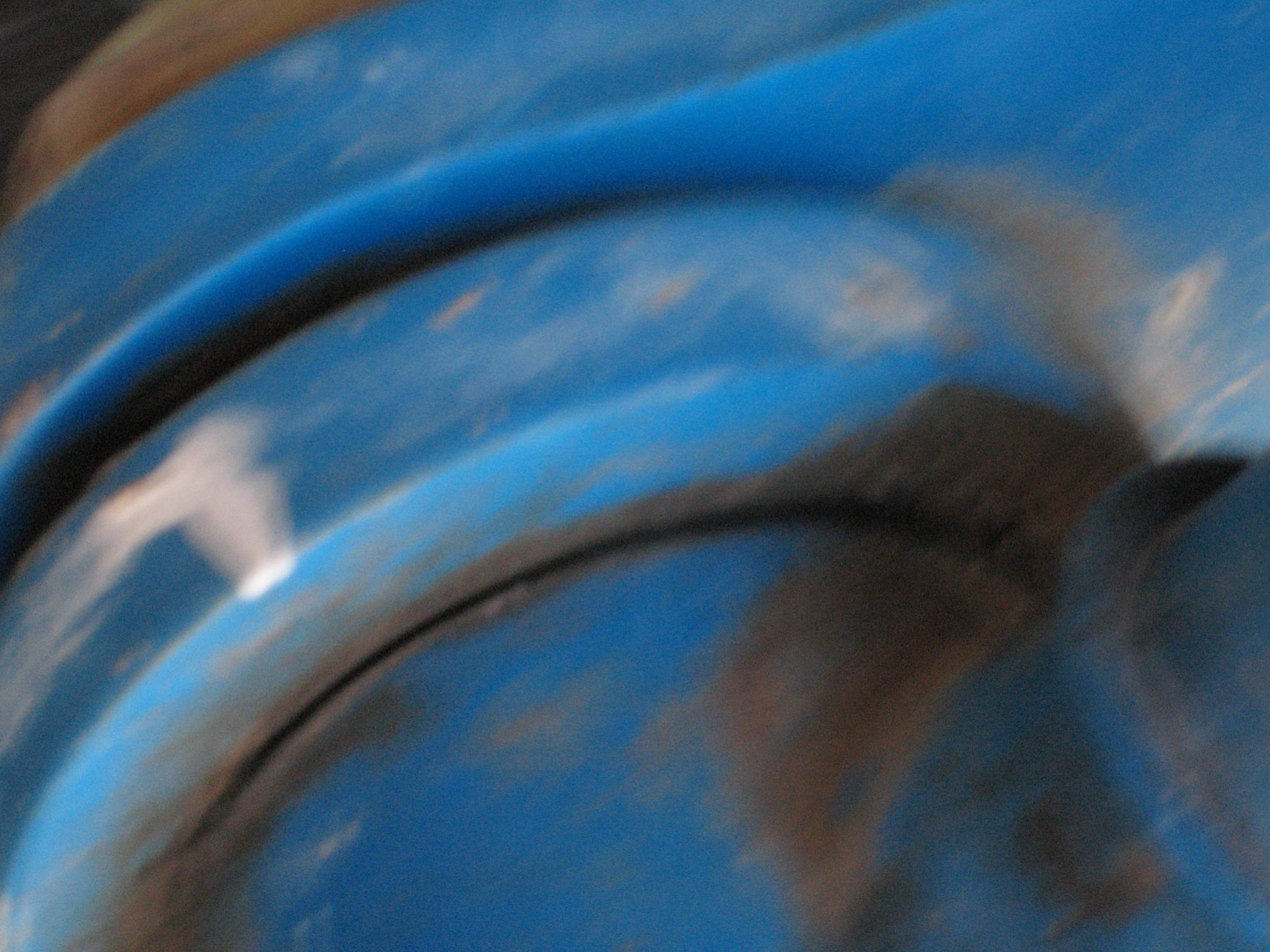

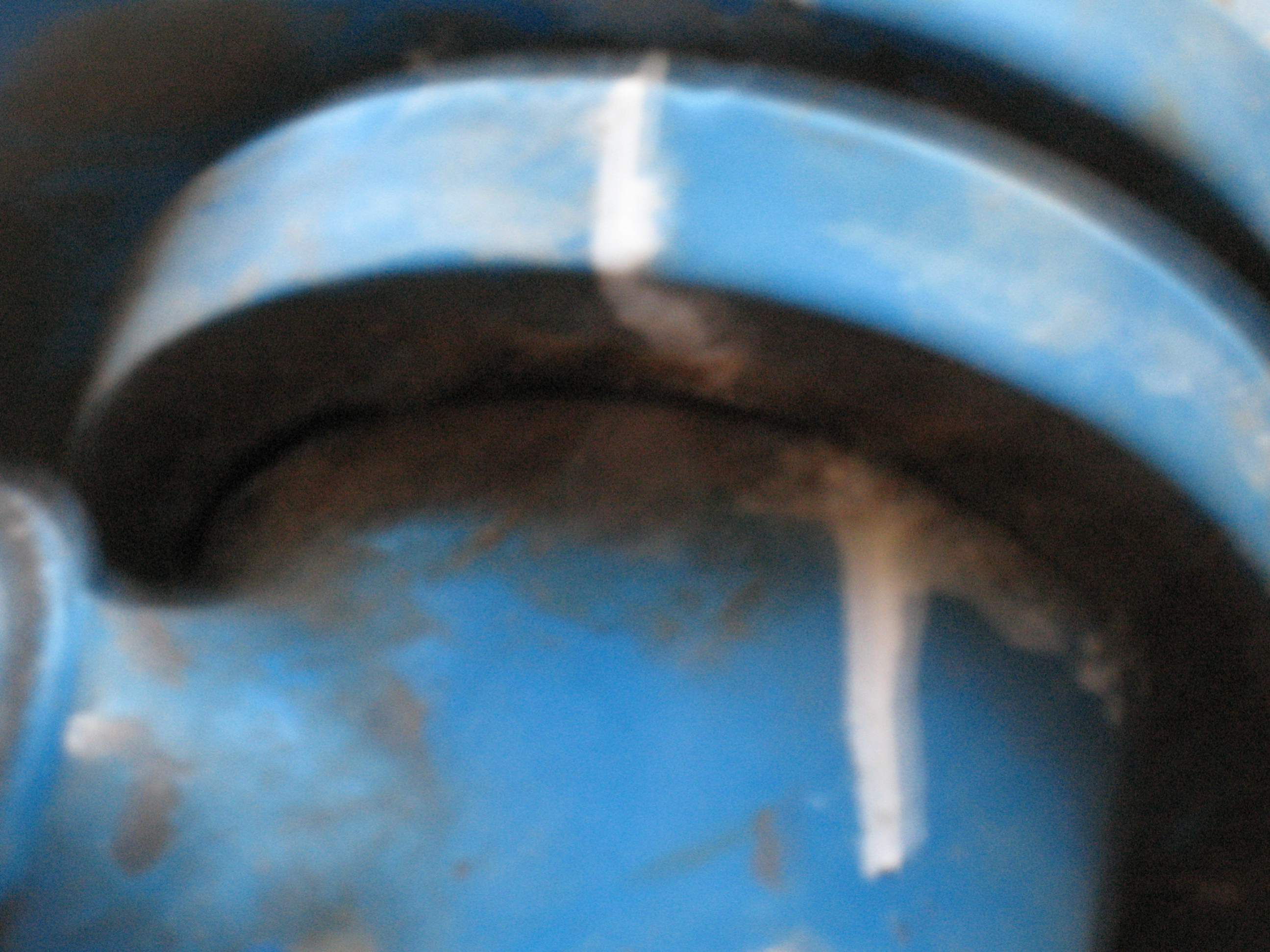

I just checked mine and I think the problem is in the linkage for the self-leveling action. I can let my bucket hang down and move it back and forth. There is about 1/8" of slack in the hole and appears that it was cut too big for the pin. I will go out an take a photo of the area for you guys to check yours.
You can see the slight gap at the top in the grease mark and it is about like that all the way around which while not being a lot of difference, it allows the bucket to move a minimum of 2-3" back and forth by hand at the cutting blade level

Any one else have slack around this bracket. While it isn't a lot of slack, it does allow quite a bit of movement in the bucket
