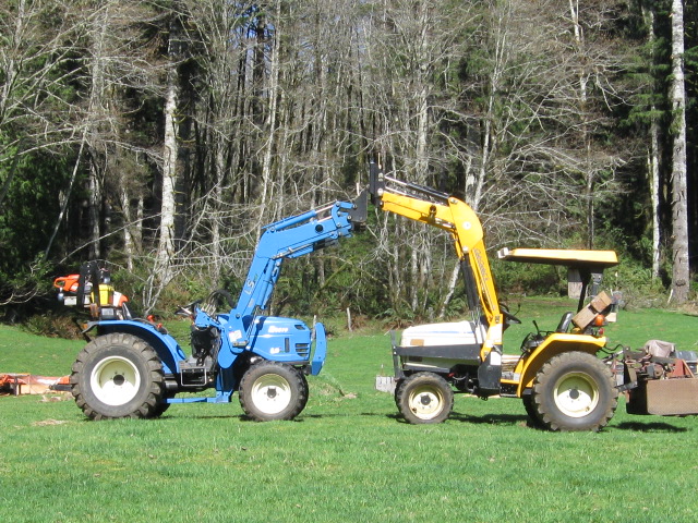

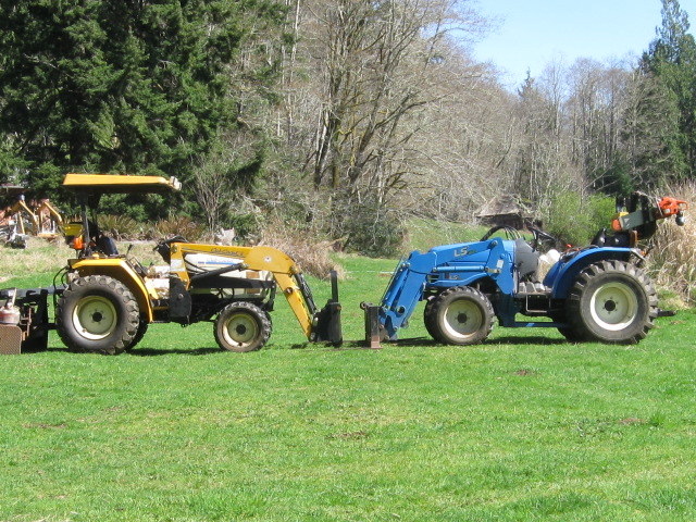

My loader gripes probably became legendary here when I found I couldn't roll the bucket back with the strength I was used to with my old CubCadet. That, and it wouldn't even reach my deck with a keg of beer in the bucket, as I had grown accustomed to doing with my little old Cub. LS and my LS dealer upgraded me to the 2011 and up larger bucket cylinders, though improved, it still wasn't the power I was used to. I just bought an aftermarket quick attach for the used Cub I just got. I got it on there and thought that with the sun shining here for a change, I'll get some pictures of the two tractors with their loaders set up for comparison. The LS 4100 loader is set well forward, as well as higher from the ground. It is just plain smaller.
attachment.php
attachment.php
It is a bit hard in the photo to see the why the roll-back strength is different, but it is mostly in the spacing of the pins on the quick attach (I should have gotten a closeup). As for height and reach, it is easy to see the difference in the length of the booms. The Cub is reaching 13 inches higher than the LS, and the LS is on higher ground than the Cub.
Of the two tractors, the LS kicks serious butt for comfort and PTO power. But now I have a loader that will do more. The weakness of having the Cub's bigger loader is in the Cub itself. So, with the Cub 7***s, Case IH 1140s, and Mahindra 28, 30, & 3215s (all the same Mitsubishi built machines), the front axle is not strong enough to carry the loads its loader can lift. I repeatedly blew the front wheel bearings out of my old one. I will be very careful about how much I weight I try lifting with it now.
BTW, the cub never has that issue of the bucket having that gap in power that this thread started with.
