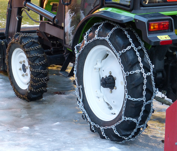

Those of you who don't use chains on the wheels in snow, is that because the terrain you use the tractor in is quite flat? Here in Norway I wouldn't even consider not using chains, but it ain't very flat either.

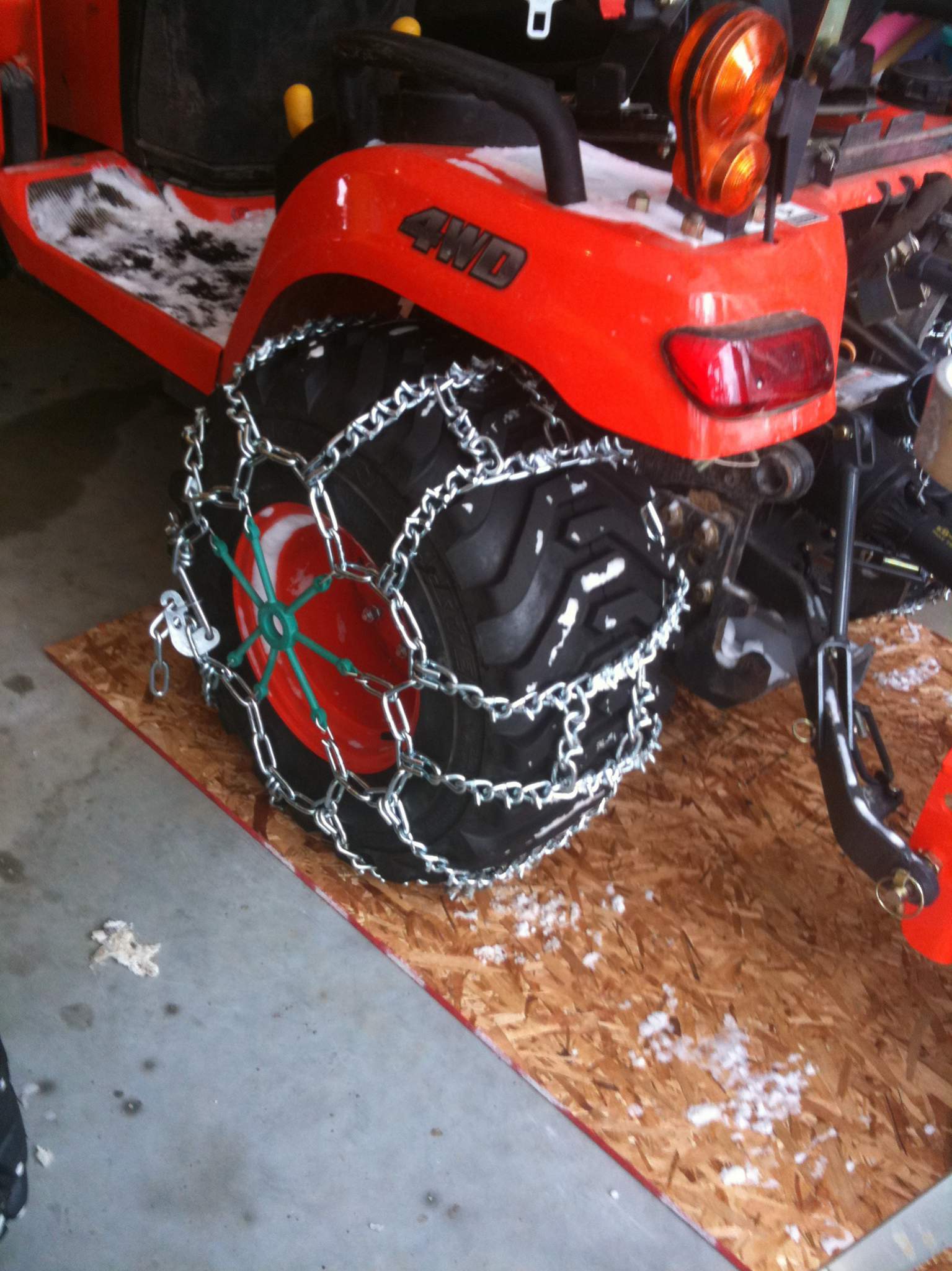

Well things are different for different folks. Arrow you have had that results, but I have had the exact opposite on my R4s, loose chains for me were so useless that I considered removing them all together. Not only as it turned out did they do absolutely no good being loose when it came to traction but then I had to deal with then wanting to slip off all together or one side of the chain would come way to the outside or way to the inside, (outside more though) enough so that you had to stop and remount the chains all over again as if you were doing for the first time and that was consistently happening. It was not until a friend of mine told me the problem was that the chains were to loose and to tighten them up as much as possible and that was years ago. Which I did. Not only did they not get lost in the valleys like they had been, the stayed where I put them over the lugs, gave vastly superior traction and do not want to slide off like they used to. Now I don't know it is is the style of chain or not but my experience is the exact opposite of yours. So your real may work for you but is a total failure for me and my real does not work for you. What is better? What ever works for the people that are using said chains in their situation is the way to go. It is not the same for everyone as your and my experience demonstrates.

If one looks at the chains recommended for different tyres, it becomes quite obvious that what is good for the goose is not necessarily good for the gander. Floating chains are, as I can understand, primarily for R1-type threads, whereas V-pattern chains and others are for 'the rest'. The floating chains -- you guessed it -- float around on the tyre, the other types generally stay in one position. I admittedly don't know this, but it seems the likely explanation looking at different chains. Have a look here qualitychaincorp.com/tractor-special-use. The fact that these chains are made in Norway was just co-incidental!
This type gives a fairly good ride on solid surfaces as well: https://www.qualitychaincorp.com
/product-line/trygg-smt-95-95mm
'Trygg' is Norwegian for 'safe btw.
   / R4s are better in the snow than R3 turfs #66
Once a set of proper chains are installed. You will forget abut R3 vs.R4 and just consider bare tires and chained tires. R1,R2,R3 or R4 they are all lousy in deep snow or hard pack without chains.
For those driving on bare pavement or smooth ice without snowpack without any chains. The Turf tires will probably win.
All other factors identical including ground contact area. A tall narrow tire is much better in snow than a short wide tire.
Cross chains falling in between the tire lugs is of no concern as the 1640's cross chains are are double or tripled compared to most tire chains. The cross links are spaced every other side chain link.
