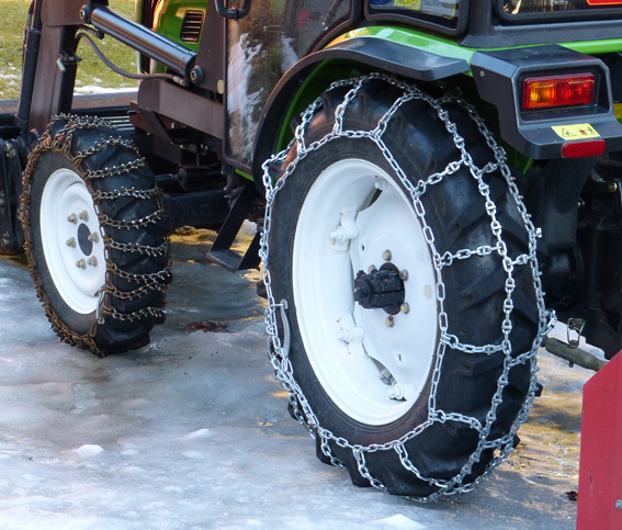

Anyone have any recommendations on a good chain for R-4's keeping in mind if the fall into the "void" between the cleats you have accomplished nothing. Also have to be sensitive to fender clearance. And one last thing. I don't have a lot of overhead clearance in the barn bay I keep this in as it has an OH door.

Sounds like you could use something similar to my KWB snow chains. Great on asphalt as well. They are Austrian, but I think (but can't guarantee) that they are available in North America as well. The circumferential part should help to avoid the chain falling in between the cleats.

This is one of the biggest myths in tractor tire chains of "falling between the cleats" If you make them "tight", they will do little to help your traction. They need to be loose as in "no tensioners" or at least loosened tensioners so the chains can "work" as they come around and make ground contact. When loosened, they look like they fall between lugs on top of the tire but coming around to make ground contact, a loosened chain will "hang" and will be the first thing to make ground contact.
Your larger problem is clearance. A big tire needs a big link (at least 3/8") to be effective. Without wheel spacers of some type, you may not be able to put this large a chain on your tractor. If indeed that is the case, then you need a smaller link but more cross chain (2 link).
The simplest chain for you would be the 2 link ladder If you can fit them on w/o hitting the tractor. There are designs that use a smaller link purposely for clearance problems. Big tires usually mean expensive chain but 2 link ladders would mitigate some of the cost of going to more exotic designs.
